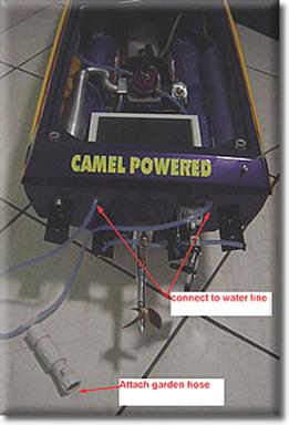

Drill a 5/16th hole in the end cap as seen here in this image. It does not have to be perfectly centered either. This isn't rocket science.
Step #2
Insert the ¼" nylon tee and seal it with a good silicon sealer. (I like Zab-a-Dap Goop). Just make sure you don't get any in the tee itself.
Step #3
Cut the large water line in half. Assemble cap, coupler, and adapter and cement the fittings together. Attach water lines as shown
Step #4
Attach garden hose end to an appropriate water outlet. Attach water line to pickup entry an attach garden hose
Note: you may not need two water connections. Modifying the Water Flushing Tool is not a problem. Simply block off or do not add the second water line. That is up to you and your individual application.
You may even be able to add a small water valve between the hose and tool to regulate the water. The valve can be found and most any hardware or lawn and garden store.
