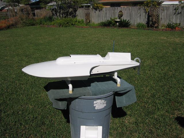

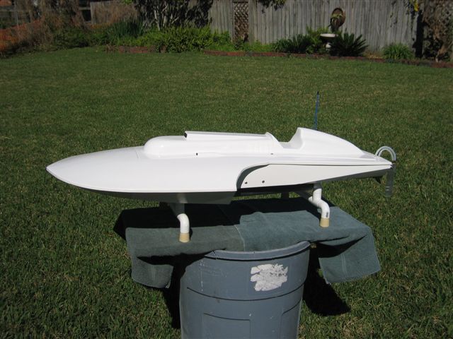

ImageThe quality of this boat is on the upper scale of the industry. This is a purpose built boat, built to last. Chris did a lot with the woodwork on the inside of the boat. It features full length ¼” 5-ply marine grade plywood stringers tied into two main bulkheads and full width ¼” 5-ply marine grade plywood transom. All the plywood is glassed in full length on all the edges and all the wood was covered in resin. There are also lightening holes in strategic places in the ply. The boat is joined with a shoebox design and the joint is thicker than any I’ve seen which makes for an incredibly strong and durable joint. I think the joint on this boat will be one of its greatest strengths.
I received one of the first production boats so I expected it to be a little on the heavy side, but it wasn’t. The lay up is good and solid, the edges sharp and straight. The sponsons are one of the most important parts of the design when it comes to hydros. To produce the high level of precision required for optimum performance takes considerable skill and experience. Honestly I couldn’t want for anything more in fit and finish. Chris had the intention all along that the buyers of his boat would prep it and paint it and logo up like a previous racer or one of their own creation!

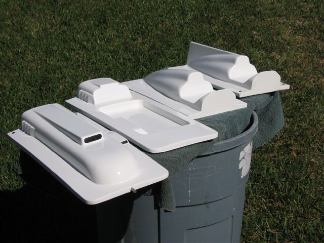

There are several hatch designs and you are encouraged to experiment! Part of the fun of a thunder boat is throwing your own ideas at it and making it unique to you. The idea of this class is to represent an era of boat racing that in it’s time was the racer they came to see! Open rear cockpit, forward engine and lots of horsepower! You can do a lot of things with the different hatches for the Herzog Thunder.

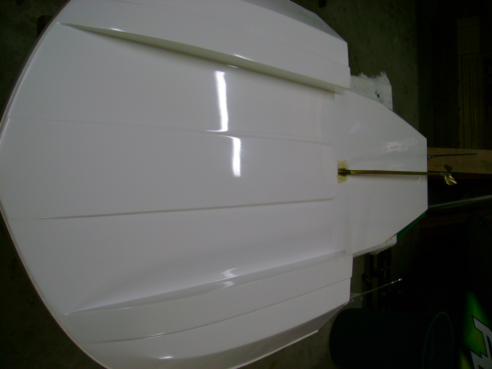

The hatch opening (8”X35”) is wide, lots of room for working inside. It’s easy to get around inside this hull for setup and building. I did do some sanding and shaping making space for the tuned pipe. I used a sanding drum on a Dremel and made quick work of what I needed to do. You must seal any sanded area with resin to waterproof it.

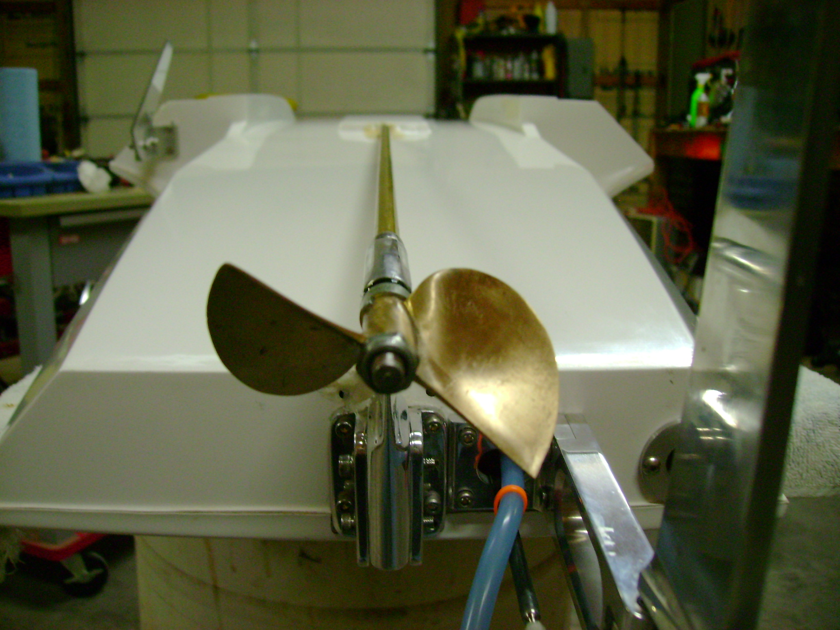

Any combination of good quality hardware will take care of the business end of propulsion and control. I selected mostly Speedmaster for the hardware in this build including the turn fin. I also used a modified strut from Rich Ballantine that I’ve waited for a special project to use. I setup basic controls using an RC Boatworks box and one of my favorites, a carbon fiber rudder push rod.
Image Image Image
Image Image
At this point we don’t know that it’s decided as an absolute what the very best hardware and setup is for the Herzog thunderboat. As is the case some times, more than one idea will work equally well once studied and tuned for that particular setup. Strut setting is for a flat ride measured at the bottom behind the sponsons and the transom and zero trim.

The hatches are a two piece design with a front and a rear. Chris has designed them to mix and match to create your own style and look. Starting to appear on the market are the scale engines to match the scale of the current Thunderboats. These are some “knock em’ off their feet” finishing touches that move the Thunderboat into scale status.
Securing the hatches requires planning. Any combination of push locks, pins and magnets can be used. There is plenty of flange and lip material to work with for any combination. I used a combination of aluminum tabs and rare earth magnets. Be careful playing with these super strong magnets, you will end up with blood blisters from pinched fingers! Ask me how I know!

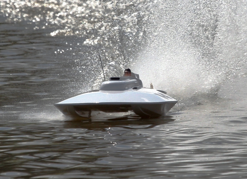

Here are a few pictures of a Herzog Classic Thunderboat in action!

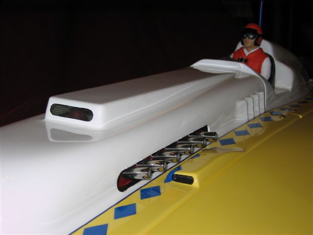

Here is a fine example of how beautiful the Herzog Thunderboat can be when all dressed up...this boat was built by Chris Herzog - Miss Slo-Mo-Shun V
