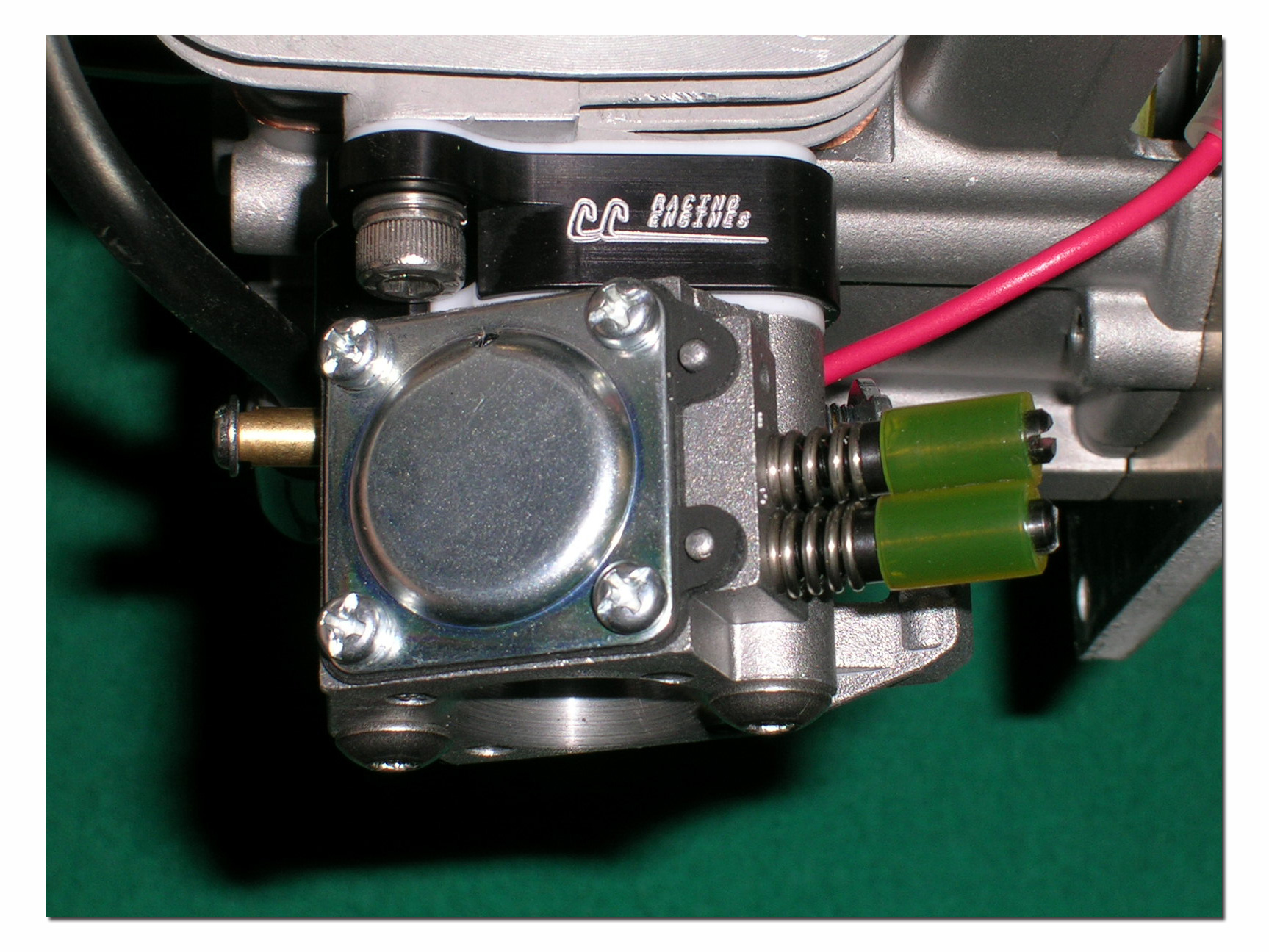

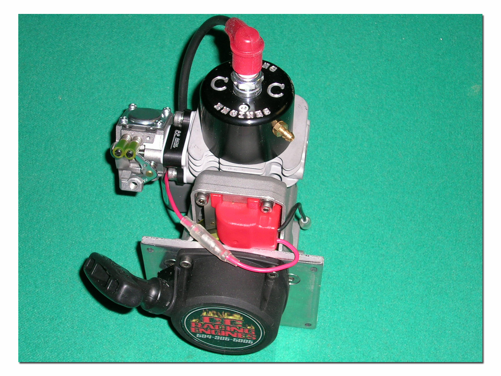

Here are a few pictures of the motor. You can notice the fine work to the carburetor throat and bell as well as to the intake port. Notice the perfect matching of the carburetor isolator block to the engines intake port. The inside work is equally as impressive. I prefer not show pictures of the inside of the engines in respect to CC Racing Engines. Reputable engine builders put a lot of time and effort in testing and development and making pictures of their work public would simply not be right.

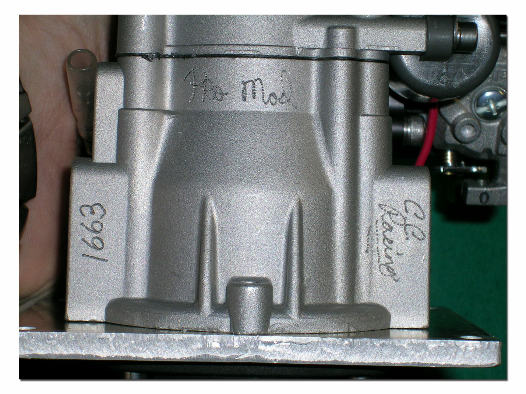

You will notice that the engine is numbered on the bottom by CC Racing. If you are buying the engine used or from a source other than CC Racing Engines directly, you can use this serial number to check the history/authenticity of the engine with CC Racing. To be absolutely certain you are getting what you pay for, buy your engine from a source you trust. If buying used, I would recommend having the engine inspected and possibly refreshed by CC Racing if you want to be certain you are getting the most out of your engine.
