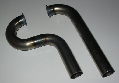

What's different about this pipe you ask? Well at first glance, not much really. It is the same high quality steel tuned pipe we are used to seeing from NFS. It is also designed to work with a 7/8" header. The stinger dimensions are identical at 1/2" outside diameter (O.D.) and approximately 0.425" inside diameter (I.D.). The overall length of the new pipe is also quite similar to before measuring in at approximately 16.5 inches. The O.D. of the chamber at the middle band area is 2.5 inches. ***These measurements are for the 2" band version of the pipe. The pipe is also offered in a 1" band version. The difference between this new pipe and the original version is all in the 2-stage diffuser section thus the name. The diffuser is the part between the header and the middle band section of the pipe. On the original pipe this was a single, constant angle cone. On the new pipe it is made of two different angle cones.
ImageAs always, you can get the pipe as chamber only, or with water-cooled flange and your choice of 7/8" O.D. header. NFS are also well known for custom headers, so if you need a special configuration they can usually accommodate your needs! All complete systems also come with their industrial heavy-duty pipe clamp.

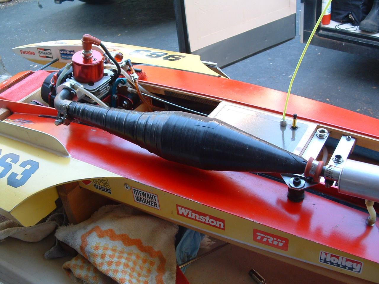

Carmen provided me with two versions of his newly redesigned steel pipes during the winter of 07 - spring 08. Image
First was his standard 2 inch band with the longer 2 stage diffuser section brazed on.  It was a prototype using rolled cones.
Early testing of the 2" band 2-stage showed promise, but it soon became very evident that with the 2-stage diffuser the overall length of pipe had increased, requiring it to be used on an even shorter header.  As it was using the standard 2" band I was having the pipe clamp very near the bend in header. Using the 2-stage design on a 2" band the pipe for my application was just too long and the top end performance suffered.
* But that said, the power delivery was much stronger through the mid-range with the engine actually spooling up rpm from down low much quicker.  So it was a success in my opinion.
Next, Carmen provided, upon my request, the SAME pipe but banded at 1".
Testing resumed setting the pipe at the same length that the 2" band 2-stage was running at.
Proto Pipe - Scott's Whiplash
Prototype 1
Now the engine was really happy, the torque was about equal or a tad less, but the spooling up in rpm was MUCH quicker and making better top end as well.
With the 1" less band on the second pipe it gave me an inch to move in shorter on the header in order to see where the limit was going to be. I never found it really. The 1" band pipe continued to make great power everywhere though a tad softer in torque.  In one test, running it full short at approximately 10 1/2" mid header to end of band the 260 it was on went well into the 19000 RPM range pushing 20K.
That was just ridiculous rpm to subject my engine to but proved a point that the pipe was still scavenging and boosting very efficiently running extremely short.
