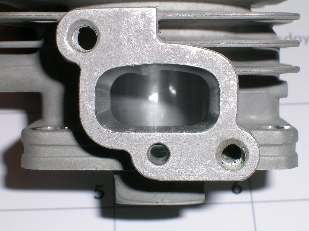

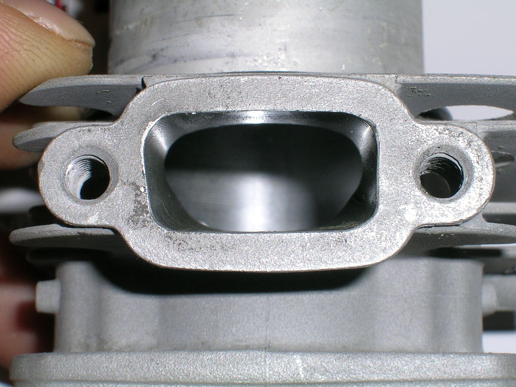

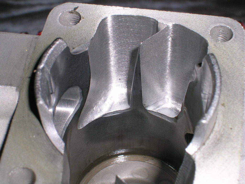

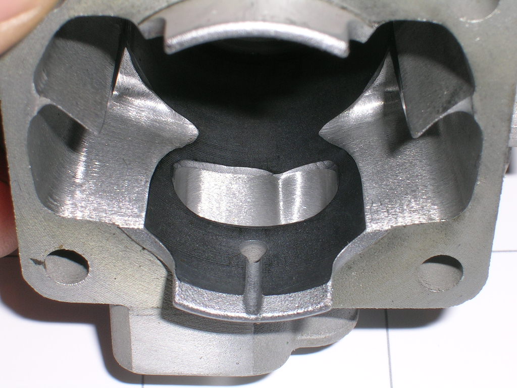

Here are a few pictures of the porting done by CC Racing. One would be hard pressed to find cleaner and more accurate port work!

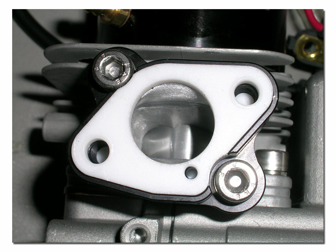

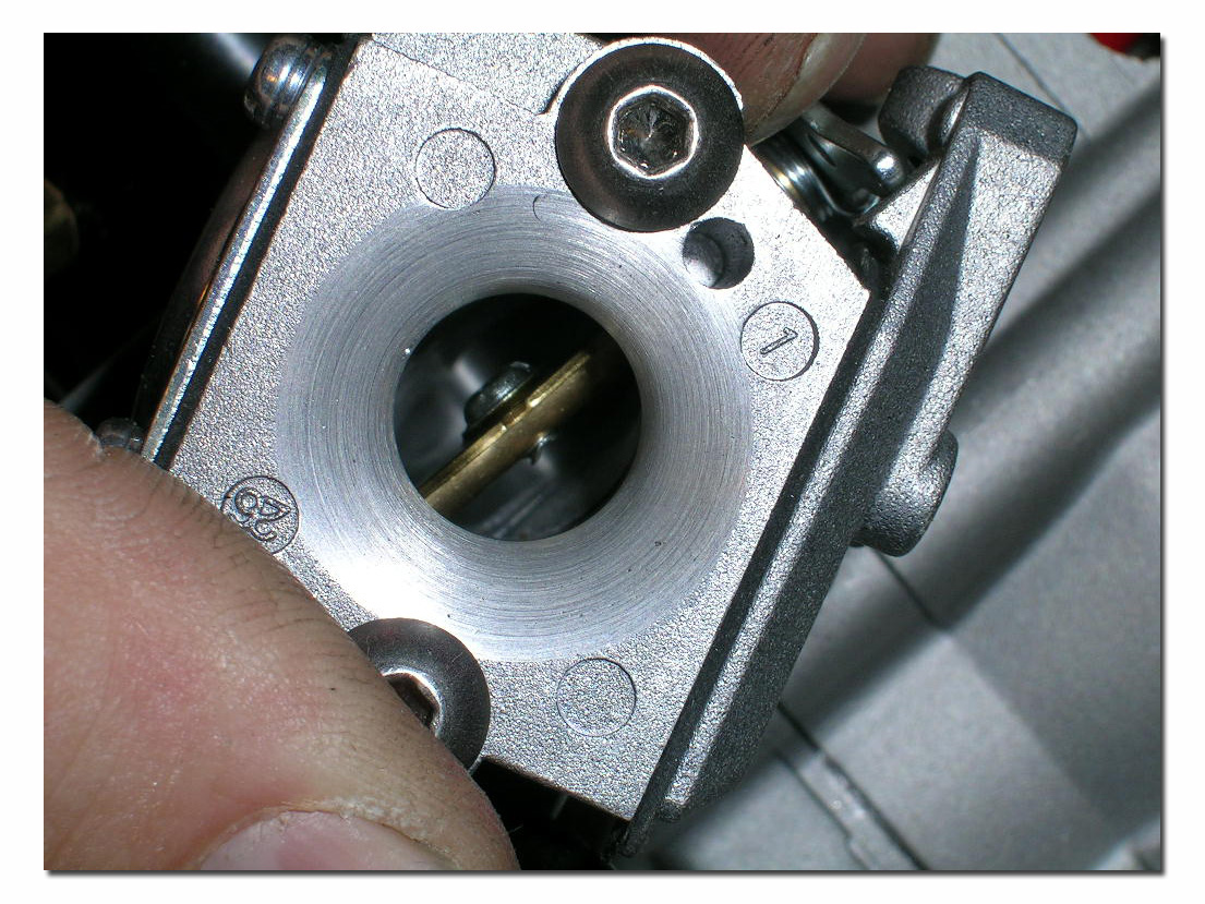

To get the most efficiency out of this powerplant, CC have added their own exclusive ceramic bearings and zero drag seals. Another feature is the flywheel which is machined to proper specs to reduce overall weight and maintain reliability. This helps in overall better RPM and quicker windup. The rest of the package is as would be found on a standard CC Racing Pro-Mod engine...in other words, CNC lightened piston, copper base gasket, billet aluminum carburetor isolator block (annodized and etched), modified Walbro WT-257 carburetor, billet aluminum needle clamp and all stainless steel bolts package on the engine.
