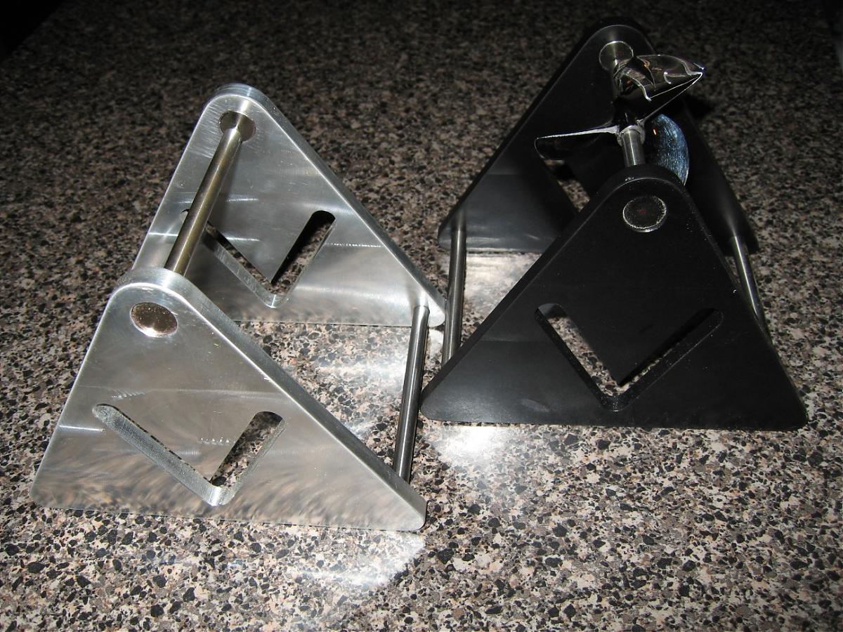

Image The new Black Magic propeller balancer from Voodoo Props is a simple yet effective tool that can and will come in handy for all model boaters. It is constructed of billet aluminum side plates and ground-hardened steel rods that serve as cross-frames. The side plates are available in natural aluminum or black anodized finish. The one we received is the black anodized version and it looks great!
The ends of the spindle (or prop shaft) are machine-honed to ensure trueness. This balancer is capable of balancing props up to at least 90mm in diameter. That is over 3.5 inches! Physically, the balancer could fit propellers of about 6" in diameter, but they might be too heavy.
The balancer measures approximately 5 1/2" deep x 4 1/8" wide and 4 1/4" high. The prop shaft is held up by two 1/2" diameter rare earth magnets. It touches one magnet while is floats in mid-air about 1/16" from the second magnet.
