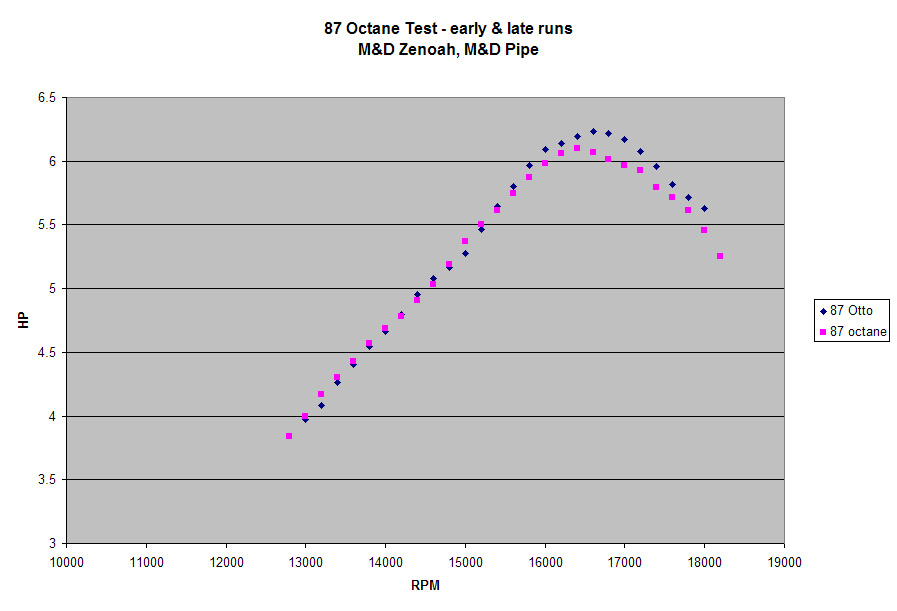

The tests were all run on the same M&D modified Zenoah with our standard, fixed length, M&D pipe. We used the factory standard ignition timing for all runs. This engine is representative of the best modified Zenoahs available. Our dyno is not calibrated and the powers reported are for comparison purposes only. Runs were corrected for pressure, temperature, and humidity. The engine was relatively new and broke in over the test period. This shows in a run at the beginning and toward the end of our test series with the 87 octane standard fuel. The graph marked “87 Otto” was at the end of the test runs. The high rpm power increased significantly with break in.  All the comparisons shown in the graphs were from adjacent tests. We retested the 87 octane fuel several times as a reality check during the test session that spanned over 50 runs.

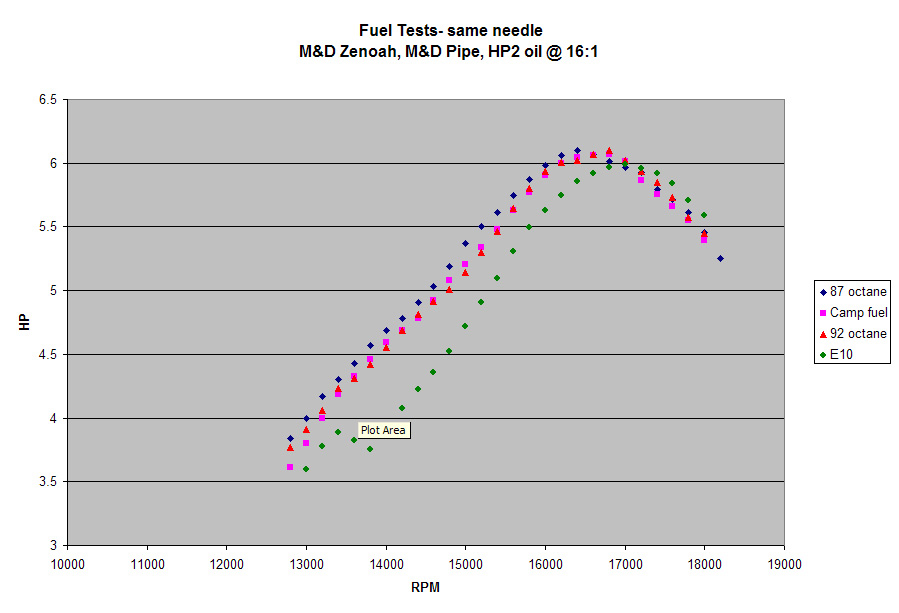

Care must be taken when reading the graphs not to read too much into small differences. All graphs are averages of at least three runs. The data acquisition software smoothed the result from the individual runs as well. However, the standard deviation measured between the three runs ranged from 1 percent to 3 percent. Taking the variation on most runs to be around 2 percent means that variations in peak power of around +- .15 hp are not significant. The oil tests in particular show results that are as equal as you will get in any series of runs. The first test set was at the same carburetor needle setting for all fuels. This setting was optimum for power on 87 octane gasoline. The oil was Honda HP2.
Fuel-Tests
With the exception of E10, there was no real difference in the fuels. The alcohol containing fuels need a richer mixture than standard gasoline. Also, Walboro carbs are designed to meter gasoline, so the mixture variation over the rpm range probably is not the best for fuel with significant (remember the E10 was 32 percent) alcohol.  Later tests where we changed both the high and low mixture settings brought the power of E10 back in line with the other fuels.

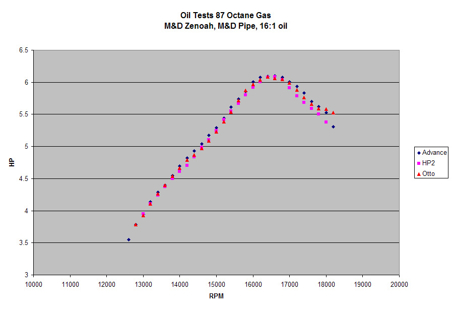

The next series of runs were with different oils. We tested Honda HP2, a standard synthetic racing oil; Shell Advance, a synthetic oil with a high castor oil content; and some synthetic oil from John Otto. As expected, there was no real difference in power from any of these oils at the same 16:1 mixture. As was stated before, this is as close to the same as you can get in a series of runs. If anything, it shows that our dyno has more scatter as the rpm increases.

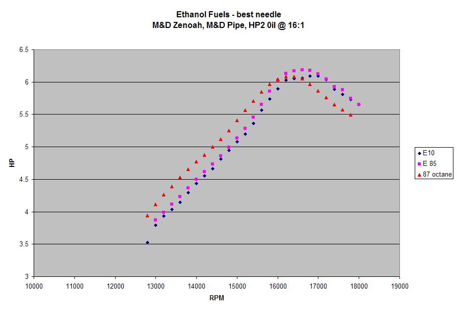

The third series of tests compared the alcohol containing fuels with the standard 87 octane gasoline at the best needle setting for all fuels.
Ethanol-Tests
Here it looks like the gasoline has an advantage at lower rpm while the alcohols are better at high rpm. However the differences are close to within the standard deviation of all the runs. I bet that there is really no difference. If anything, this shows that the mixture is better for the alcohols at high rpm and poorer at low rpm. Perhaps ignition timing changes would show something.
