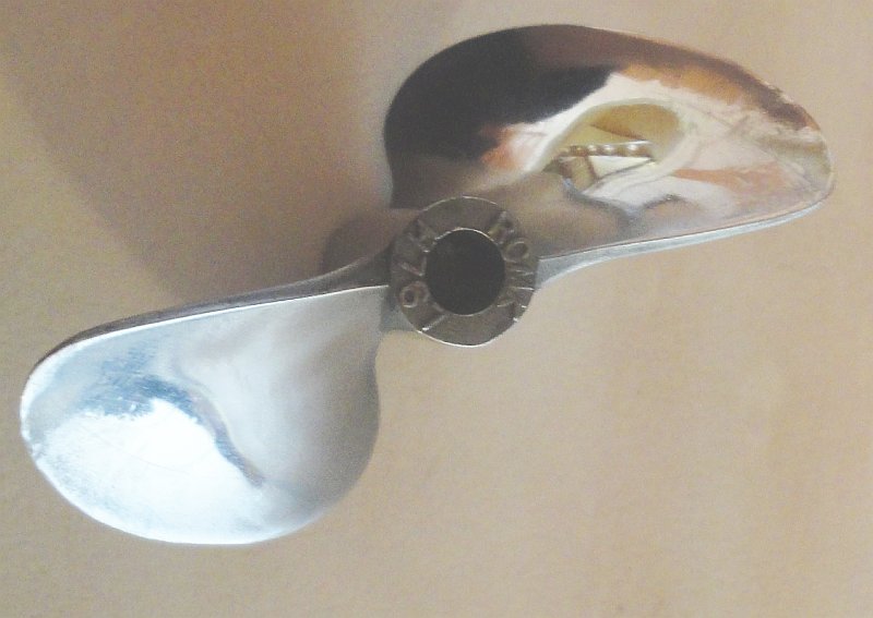

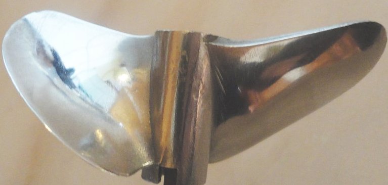

janne replied the topic: Re:mod 6719 on whips
damian wrote:
This is a RCMK H767 prop, S&B, cast is in SS.
Havent run it, cant say if its good for a sport hydro.
#11553
damian replied the topic: Re:mod 6719 on whips
Thanks for the photos, is that stock or has it been modified?
Damian
#11557
damian wrote:
Its stock,-only S&B
#11560
