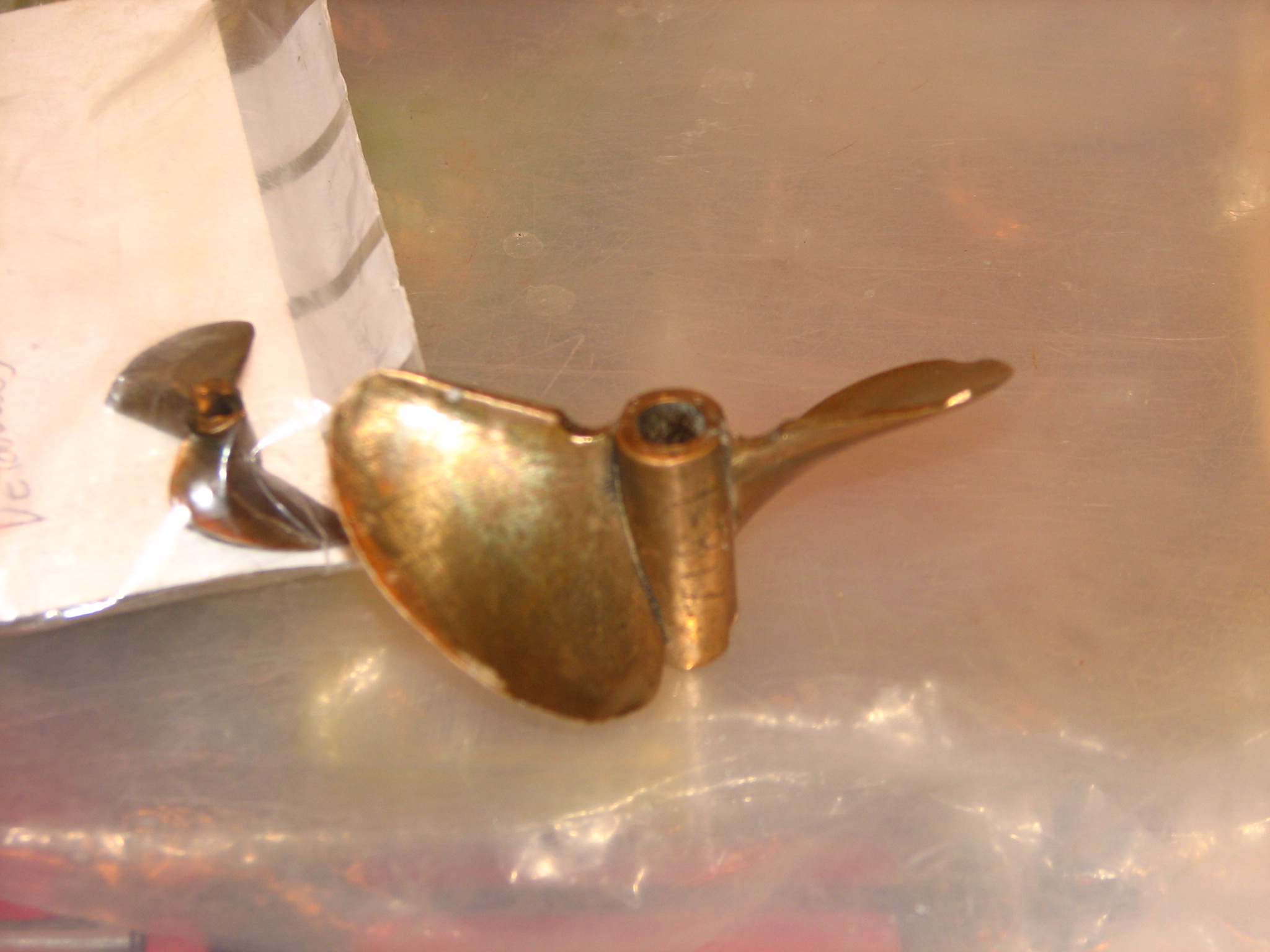

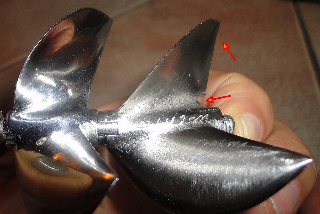

Hi. My best prop so far for the Whip GV and QD25HT is a Dasboata ABC W-2716.
I have a Dasboata PropShop ss W-6719 for the Whip to, but havent tryed it yet, -the lakes is still frozen.
You can see the barr cut on it, and the tips is bent just a tad.
Just for comparing a VooDoo 6719 and Dasboata W-6719/3.

janne replied the topic: Re:mod 6719 on whips
Adding some videos to show some dif on my Whip GV. and a prop photo.
its the same hull, but I run a QD25Ht in video 2 and 3
(sorry about the video Q).
First video: Whiph GV / CC-racing RCMK S254, prop Dasboata W-2716
www.youtube.com/user/Burholm#p/a/u/1/G3MW7T0w5_k
Second: Whip GV / QD25HT, stock SB PropShop 6520/3.
Nice RPM but NO speed, and I got a bit of "bouncing" in the rear end.
s244.photobucket.com/albums/gg..._QD25HT6520.flv
Third: Whip GV / QD25HT and Dasboata W-2716, its scary faaaast.
s244.photobucket.com/albums/gg...D25HT2716_2.flv
Dasboata W-2716/2

marc replied the topic: Re:mod 6719 on whips
Boat seems to be running good! :)
BTW, I don't think that Voodoo Prop is a 6719???? Looks like a 6717 to me. :) The one on the right (dasboata), now that looks like a 6719. :)

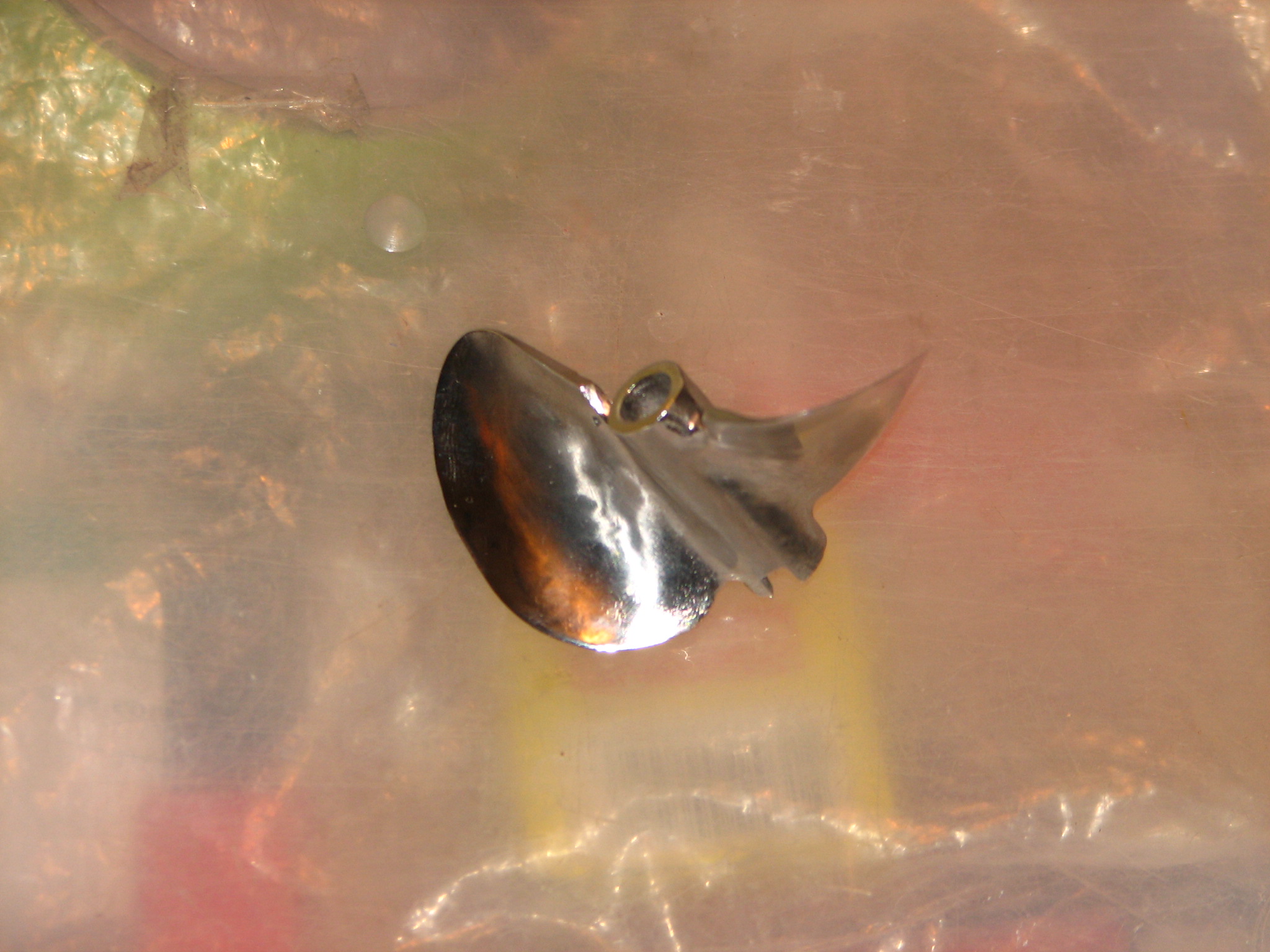

Dicko replied the topic: Re:mod 6719 on whips
I run a 2718, bar cut & cupped with rounded ears on my hydro & it handles very well.
Here's some pics & a vid of it running in an Evo, the vid shown has it running at 100 KPH, with the Zenoah I usually run speeds are between 108 & 117 kph depending on the weather & water.
