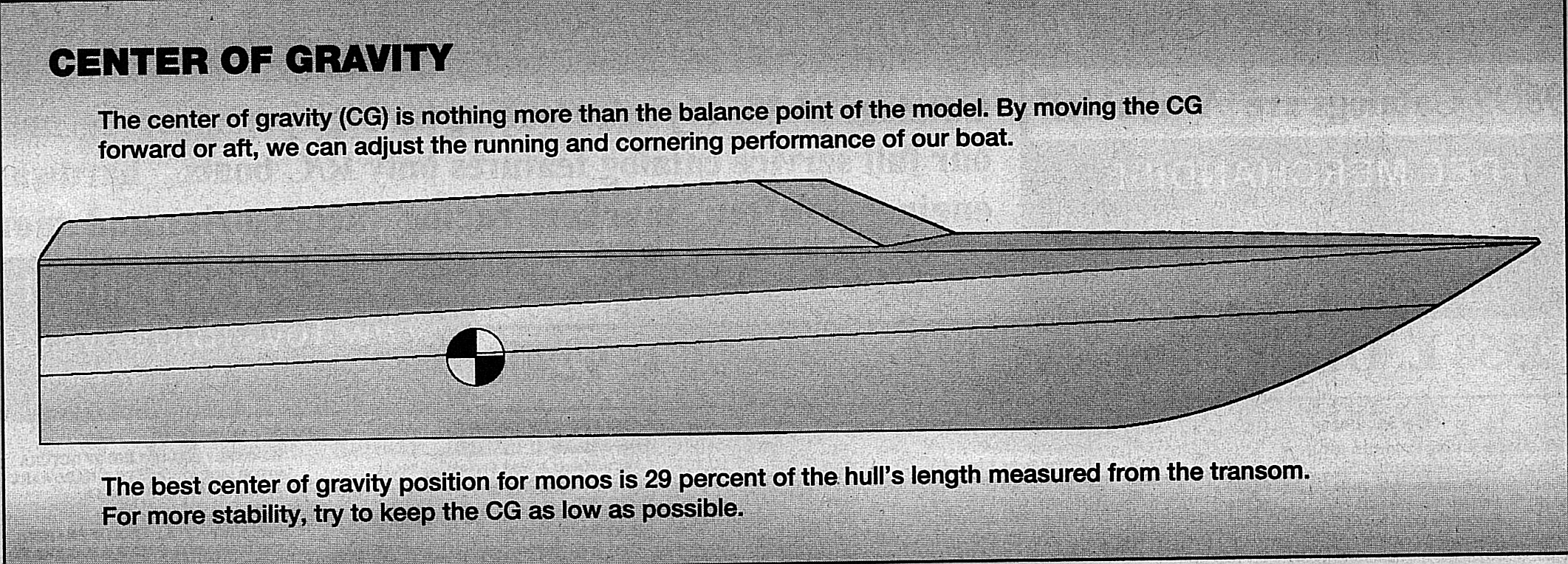

when making the 30% measurement for COG, is it at the end of the drive system & rudders or at the transom with drive attached ?
mine current project is a sport / fun mono shallow v boat stock 260.
i find its kinda hard to balance a v hull on a tube, so i use a hanging sling with a tri pod.

315neil1007 replied the topic: Re: Proper Balance
Here you go RC Boat Modeler written by John Finch

Mercury94 replied the topic: Re:Proper Balance
Always measure CG from stern to bow not from any hardware.
#18490
road replied the topic: Re:Proper Balance
thats my answer thanks Merc
