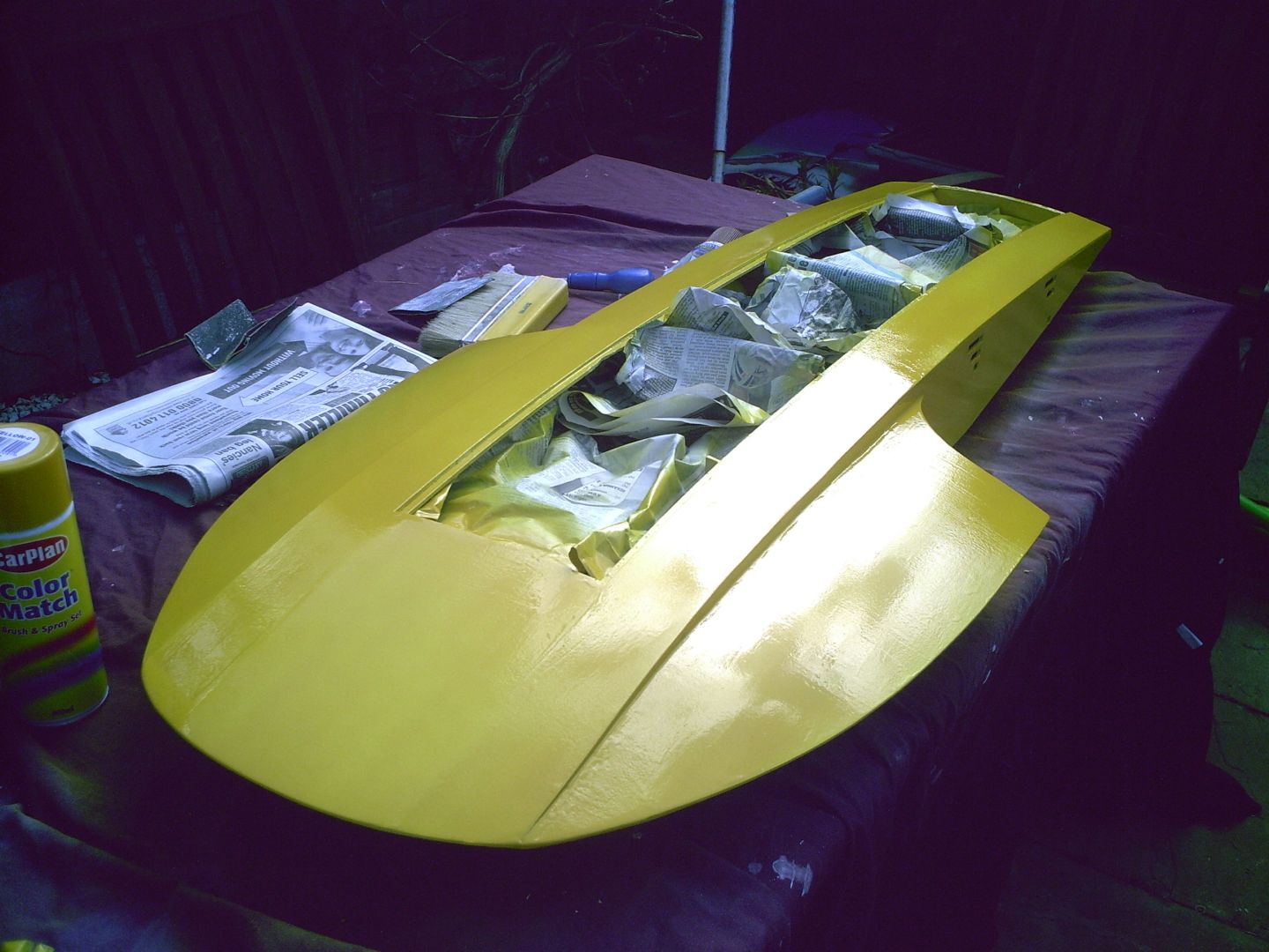

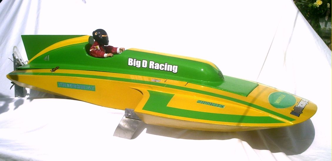

Seal the hull with epoxy first before you paint it then anything you wish to use is fine.Spray cans from any car shop will work fine,be sure to get primer the same make etc.Heres my wooden hydro the Rockett from Zippkits,i used a yellow basecoat and the green is all vinyl even the cowl.I then clear coated it using a can of laquer ,no expensive paint jobs here just rattle cans.Came out looking great i think.
Mart
#12134
Moofy07 replied the topic: Re:Paint for new boat?
Yeah,
You are right, nice work.
