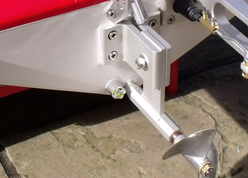

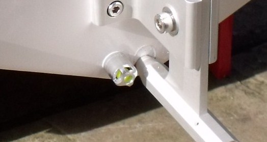

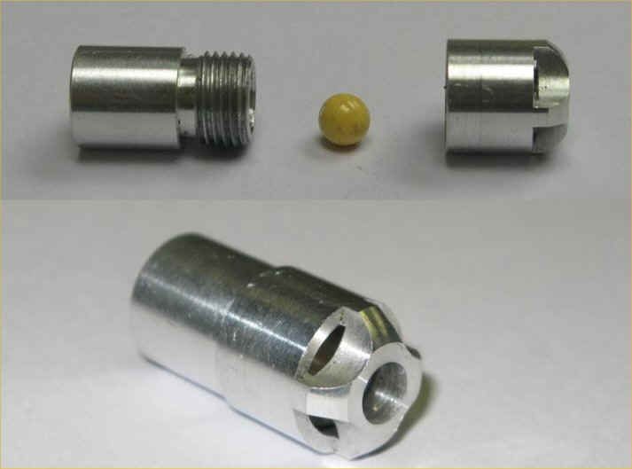

Craig Dickson replied the topic: Re: Need for bailers?
Hi folks
For my Lynx Mono I fitted an auto bailer comprising of a take apart tube that contains a little plastic light weight ball. If the boat stops the ball is forced inside the tube to seal against an internal O ring preventing water getting back in.
It has worked for me without fault however if using such a device I strongly recommend a thorough clean of the internals after each day's running. As others have said, any muck, grease or debris inside these clever but simple devices will cause problems with the ball sticking.
Hopefully two images should show here, one of the uninstalled device and the other of it installed at the bottom of my transom:
#15121
marc replied the topic: Re: Need for bailers?
Those are some trick autobailers!!! Where they from?
Also, I really like the pushrod connector you used to tie them together...I usually just use regular wheel collars but those are really neat. Can I ask where you get those?
#15123
Perhaps I should crop the second photo to hide the rudder linkage connection such that the focus is on the Auto Bailer and its screw fixing!
Is this cropped photo better?

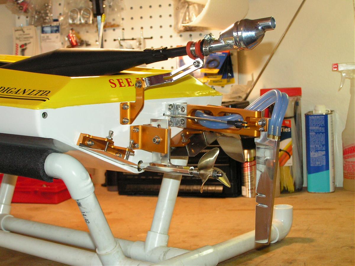

Canadian Hot Rod RC Boats replied the topic: Re: Need for bailers?
I like this set up and does away with auto bailers
Yours is a FAB looking boat CHR!
