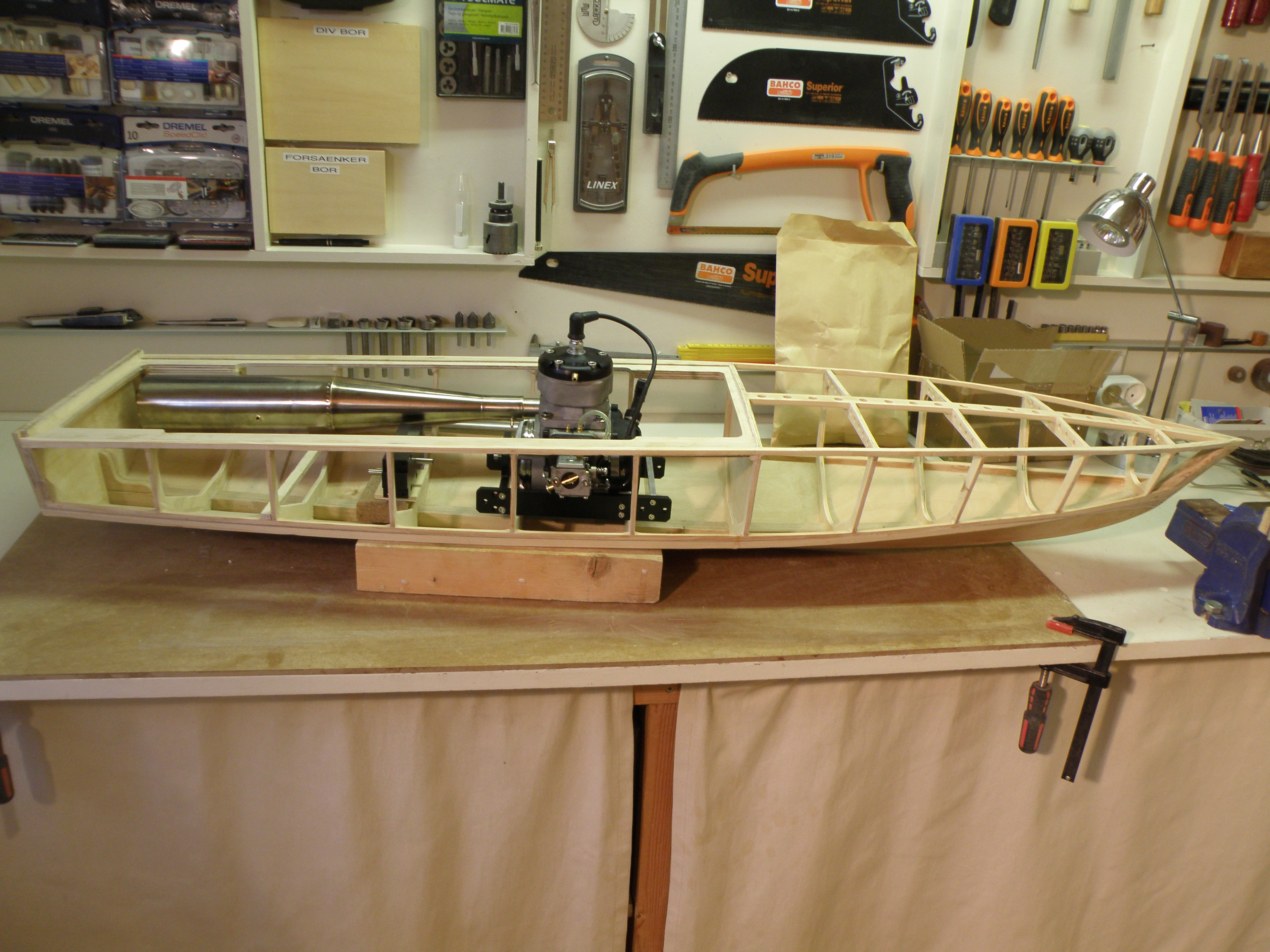

In my case I need a compact tank to put into a space of 70 x 200 x 170 mm (standing upright) in a closed compartment in front of the engine.
So far I have found the "TET4035" that is made for RC-planes. It contains about 580 cc of gas. It takes up 70 mm on the "flat" side - excactly as wanted, and now I wonder if I could set up two of those side-by-side with a divided gas intake? Just to reach one litre of gas in all?

Woodie replied the topic: Re: Gas tank?
Hi Marc.
The compartment is not all done yet. You must imagine a new "wall" right at the front of the motor. This will leave 70 mm space forwards to the next wall, which is shown on this picture.
So you must imagine one or two upright standing tanks, that excactly fills out this space - of course with tanking lids upwards, and a "clunk" fuel intake with filter to the bottoms on both.

marc replied the topic: Re: Gas tank?
I would suggest cutting out the forward bulkhead enough to let a tank or I.V. bag slide in there and lay flat on the bottom of the hull. Would keep your CG down much lower and would allow the use of many readily available tanks/bags. Just my opinion. :)
Marc and Canadian.
Thanks for your suggestions. I am not sure if I want to "break down the wall" to the front compartment, as this should be the absolutely waterproof "insurance" for the boat not to join the fishes together with my precious blata.
Woodie wrote:
It's actually much better to have all bulkheads open for water to get in and more importantly GET OUT of the hull. No matter how hard you try, water will always get in there, and if you sealed it, it creeps in, but takes forever to get out or dry out and ends up rotting out your wood hull. Keep bulkheads open and seal ALL the wood carefully with epoxy as you build. It's the ONLY way to build a long lasting wood hull. Trust me on this! For floatation, just put in pool noodles. It's also a good idea to have them in areas where they can be replaced if need be. Because believe it or not the foam actually soaks up water over time too!
This would make your gas tank problem go away and also make your hull much better for the long run. :)
