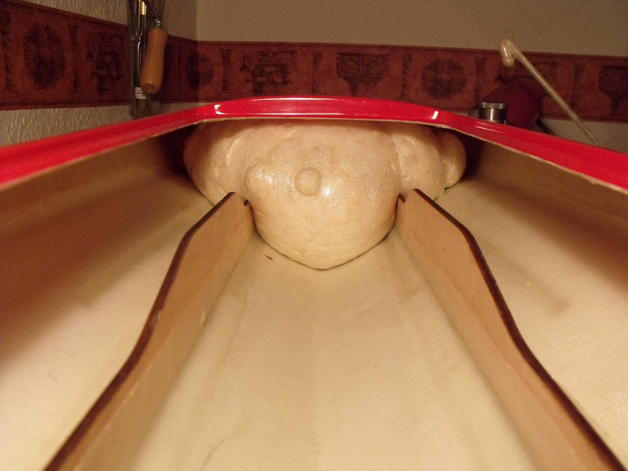

Okay, when I built my second Gas Boat, I decided to fit a plywood bulkhead up front and fill the bow section with expanding polyurethane foam for buoyancy and strength.
This first photo shows the bulkhead in situ prior to the foam, all well and good so far with nice neatly cut expansion holes etc.
Being an inpatient man I figured the expanding foam didn’t seem to be doing much so I put plenty more in.
And then it seemed to start expanding more and more and I ended up with this (oh sh*t):
After it had fully set it took me a good while to cut the excess back to the bulkhead (before glassing it over) much to the delight of my wife whom laughed her wotsits off!
Anyway despite that hiccup, this clip shows that it did in the event save my boat from sinking when I had an accident. This clip also shows why I should have had more buoyancy in the mid/rear sections of the hull.

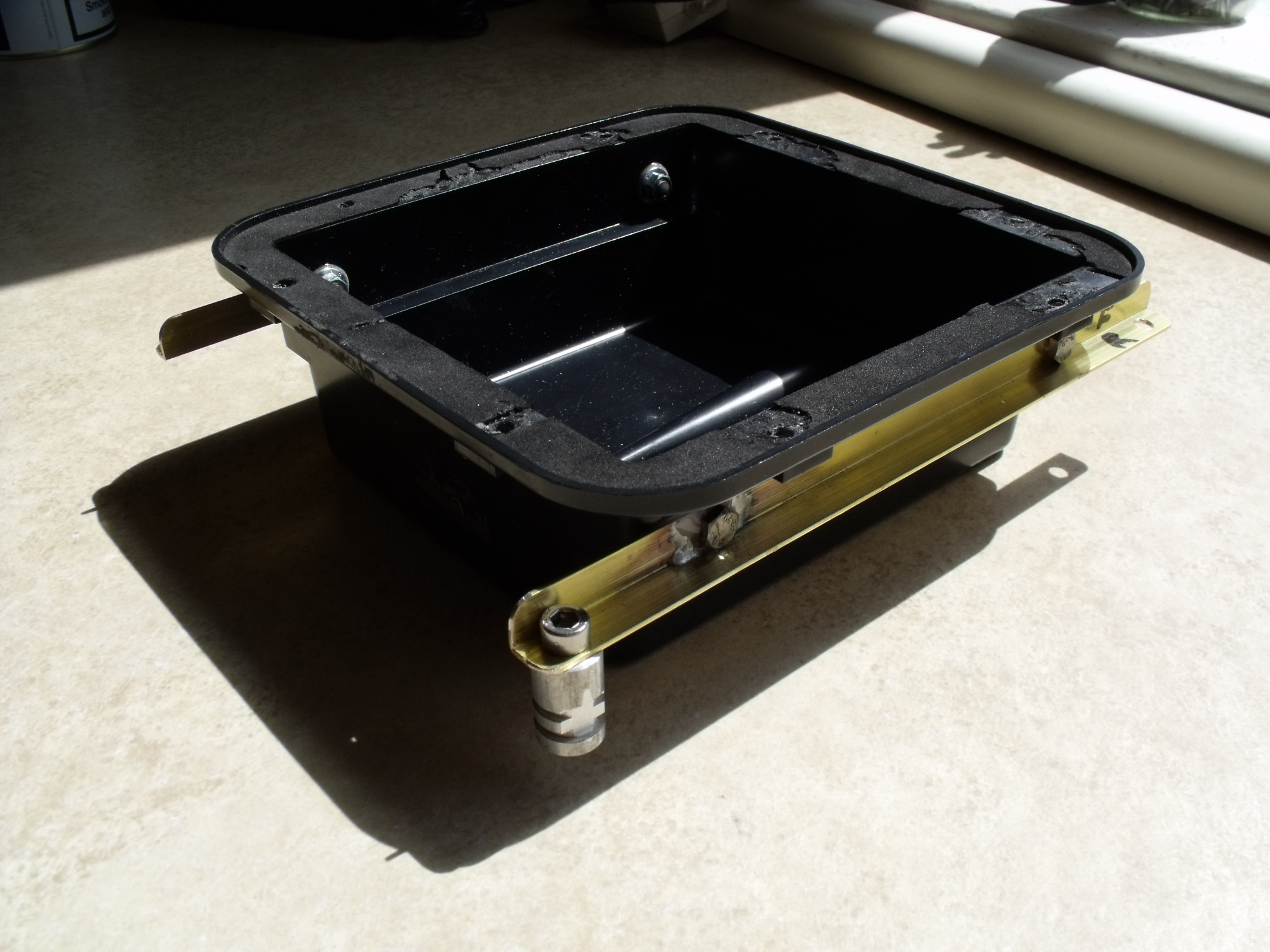

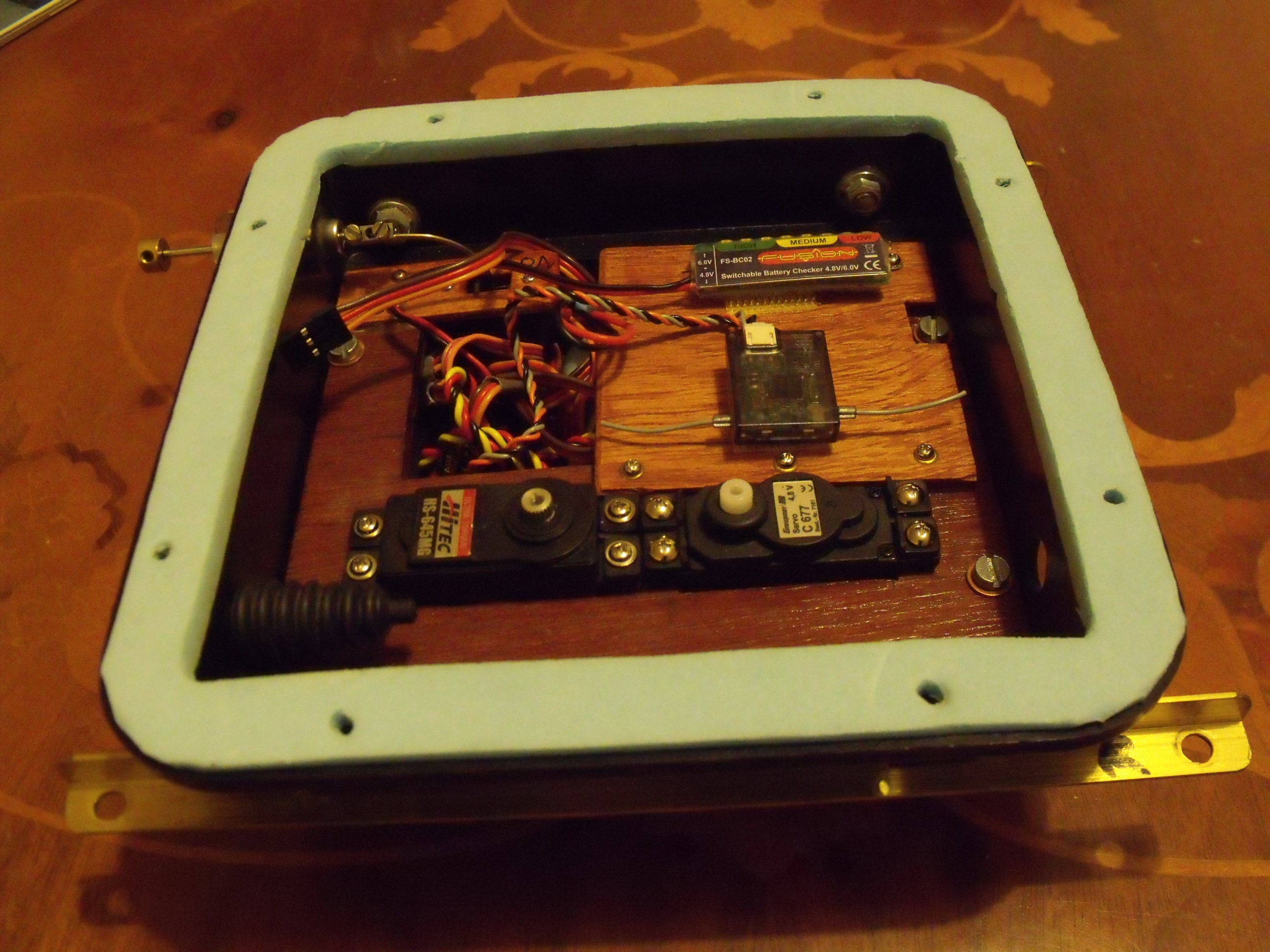

After my partial sinking, the radio box was thankfully dry inside. Although a standard plastic box, it was much modified to reduce the risk of water ingress.
That included the square section brackets bolted + epoxied (with plastic epoxy) on the outside. Such that the box can be removed quickly by removing the four external bolts set into alloy studs glassed just outside the plywood rails.
The only four places that water can enter this box are the hatch, the two bellows and the switch push rod.

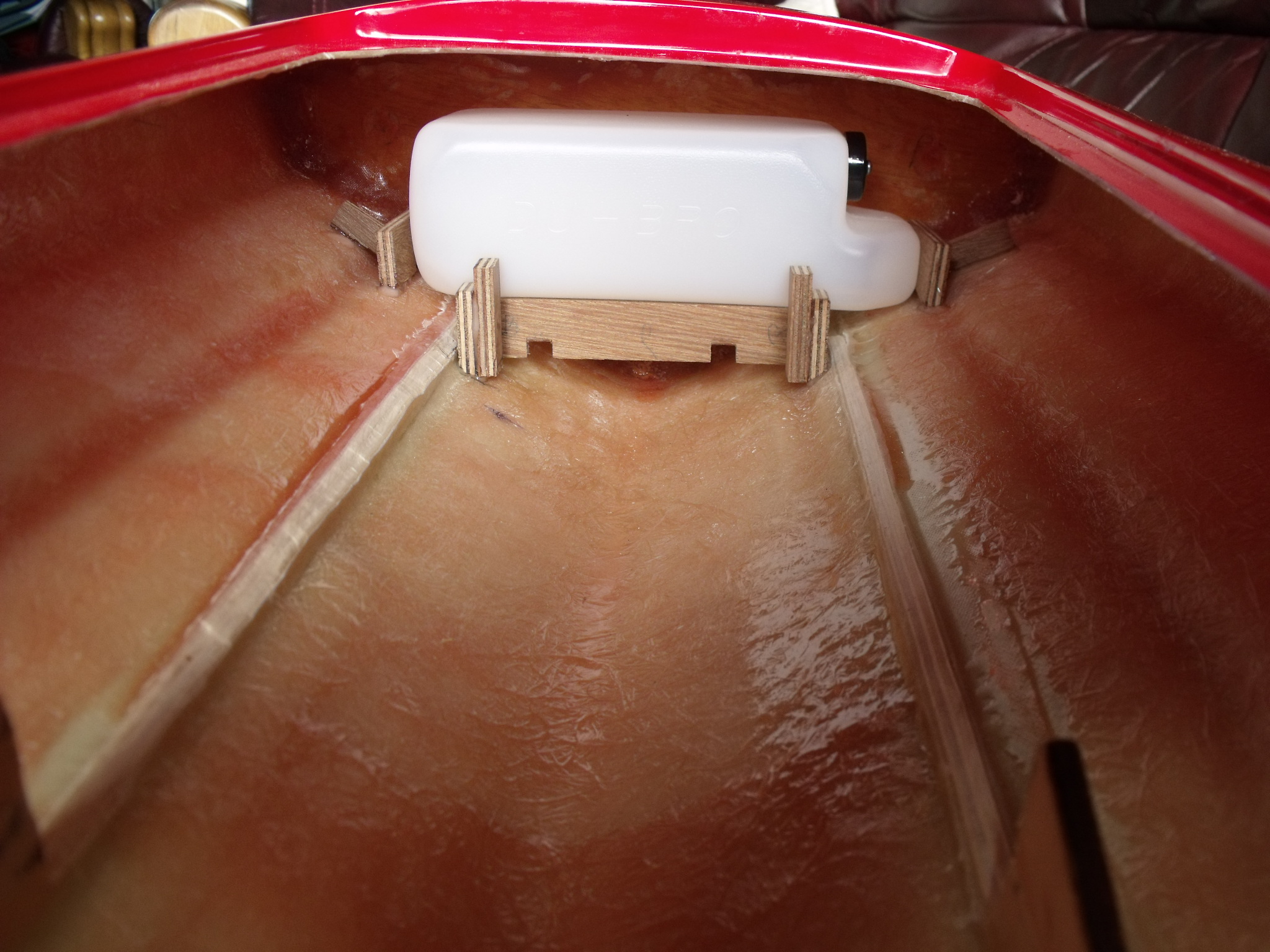

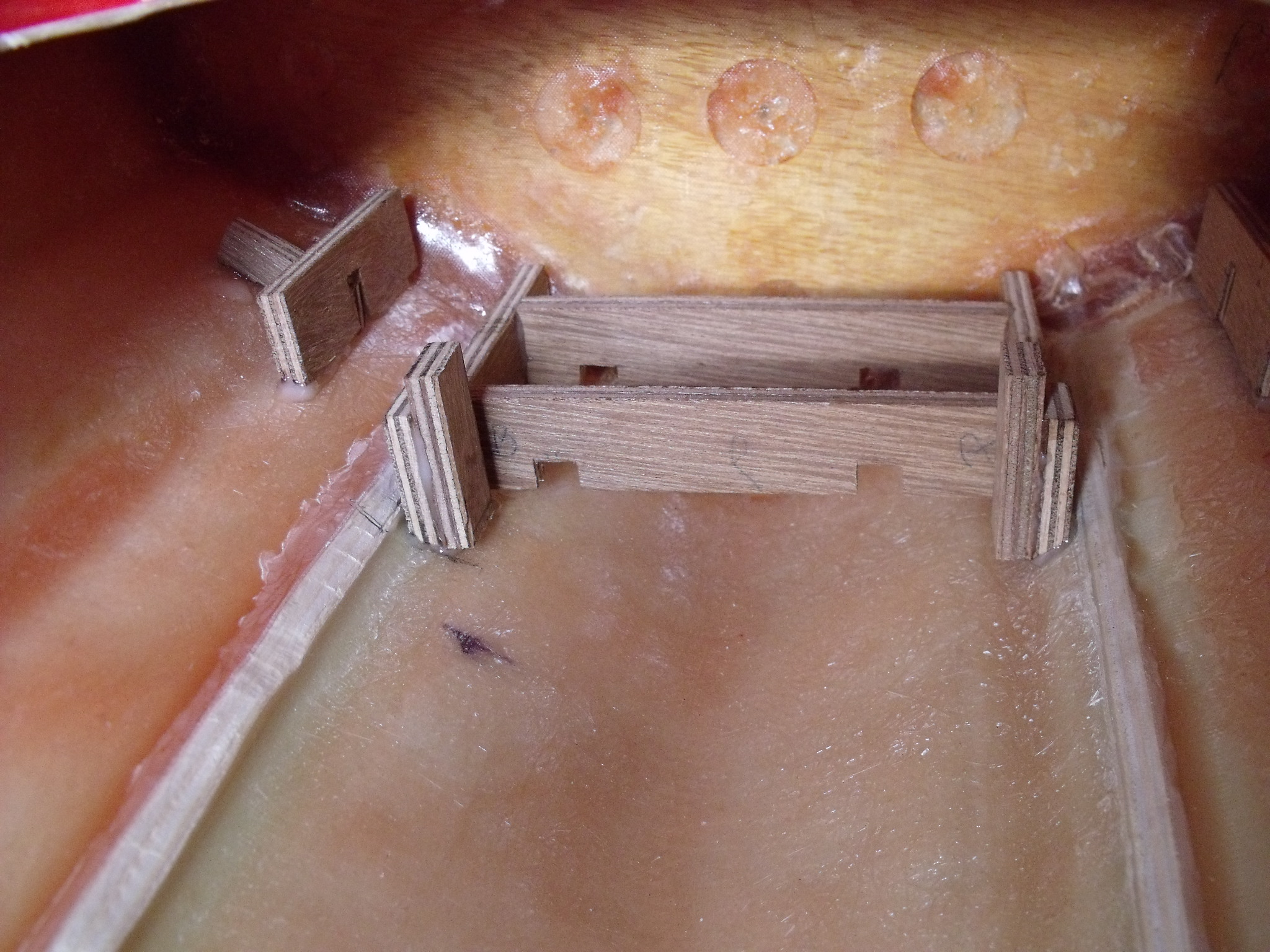

When fitting out my Lynx boat as per previous images, I had the same issue regarding the fuel tank pointing forward well into the bow of the hull. However I was determined to fit that front bulkhead for lateral strength and foam buoyancy beyond it.
I removed the preinstalled rails as I didn’t see them sufficiently thick and strong enough for the Zenoah engine.
My solution was a Dubaro tank mounted horizontally in a plywood cradle. Two plastic cable ties hold it in place permanently.
