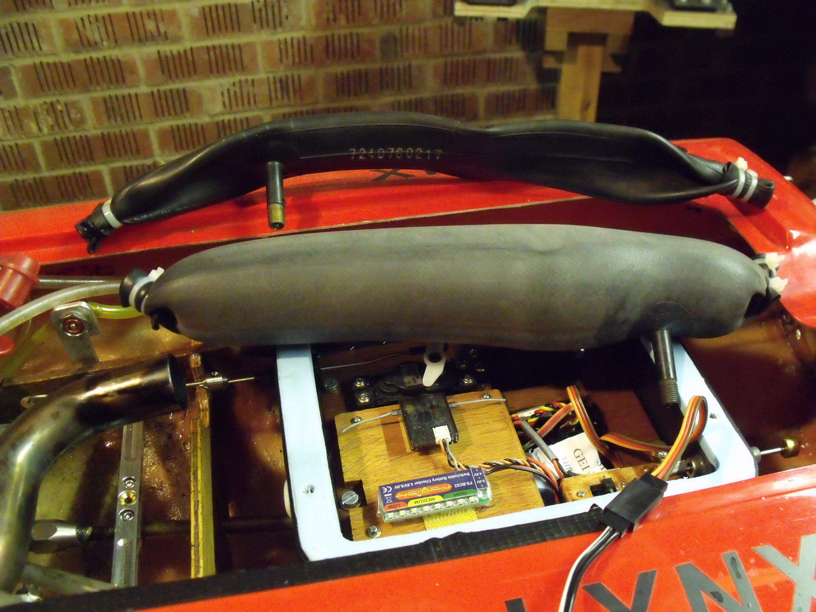

Craig Dickson replied the topic: Re: Expanding PU buoyancy foam – do you use it??
Hi Folks
On the bike tube idea, I decided to give it a go today.
I cut the tubes then clamped the ends together with solvent weld. Then I folded the end sections back and nipped them together tightly with two plastic cable ties at each end.
The big advantage for my shallow mono hull is that these are dead easy to install in the narrow side sections without having to remove the radio box. I need to remove them for access to the turn fin bolts. Also you can pump just the right amount of air in to have them held sufficiently secure in place knowing that unlike some types of foam, they won’t hold water.
I inflated one with quite a lot of air and did the dunk test. No air bubbles leaked out so it appears to hold its air.
The photo shows both tubes, one inflated and one not.
Craig
