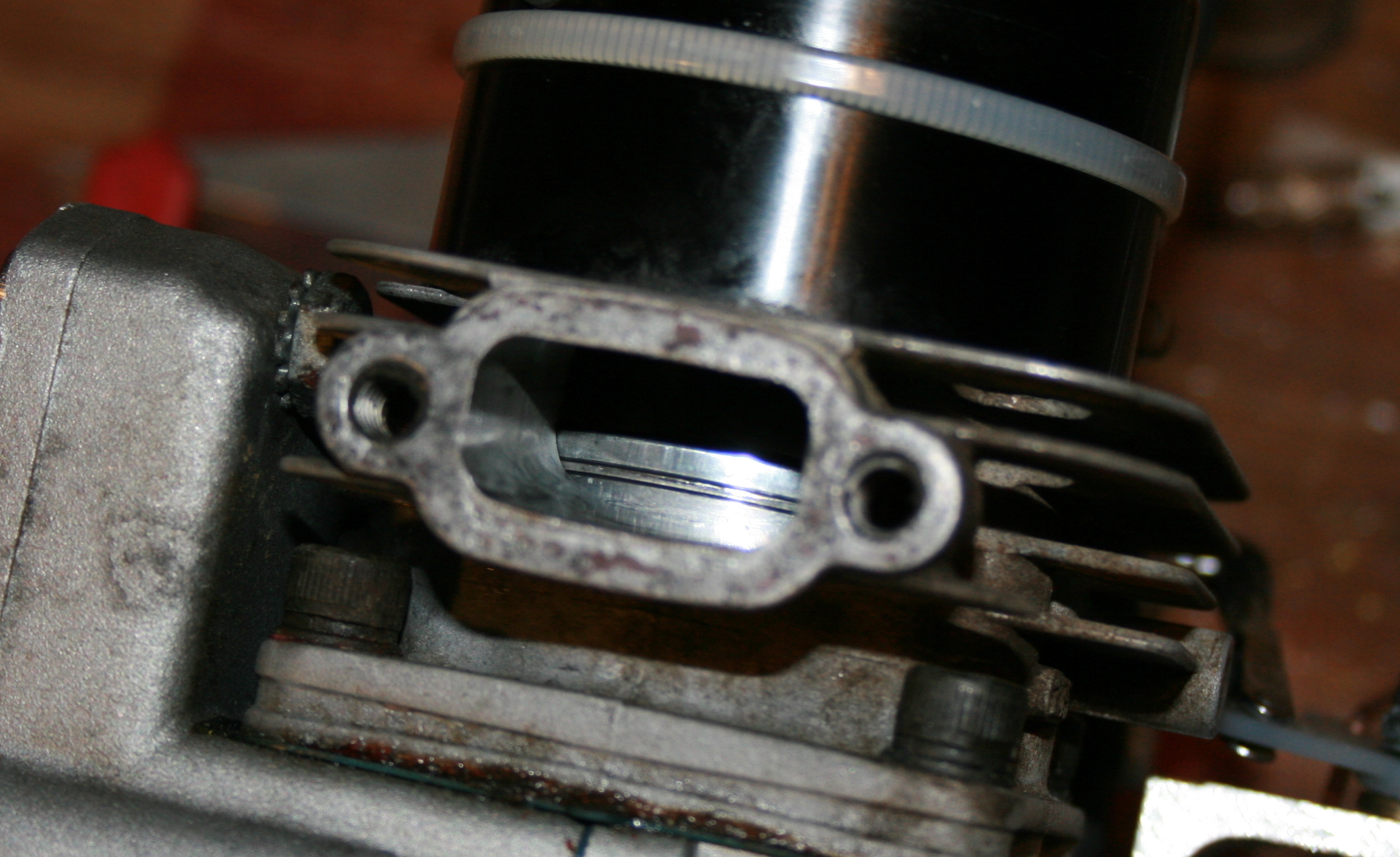

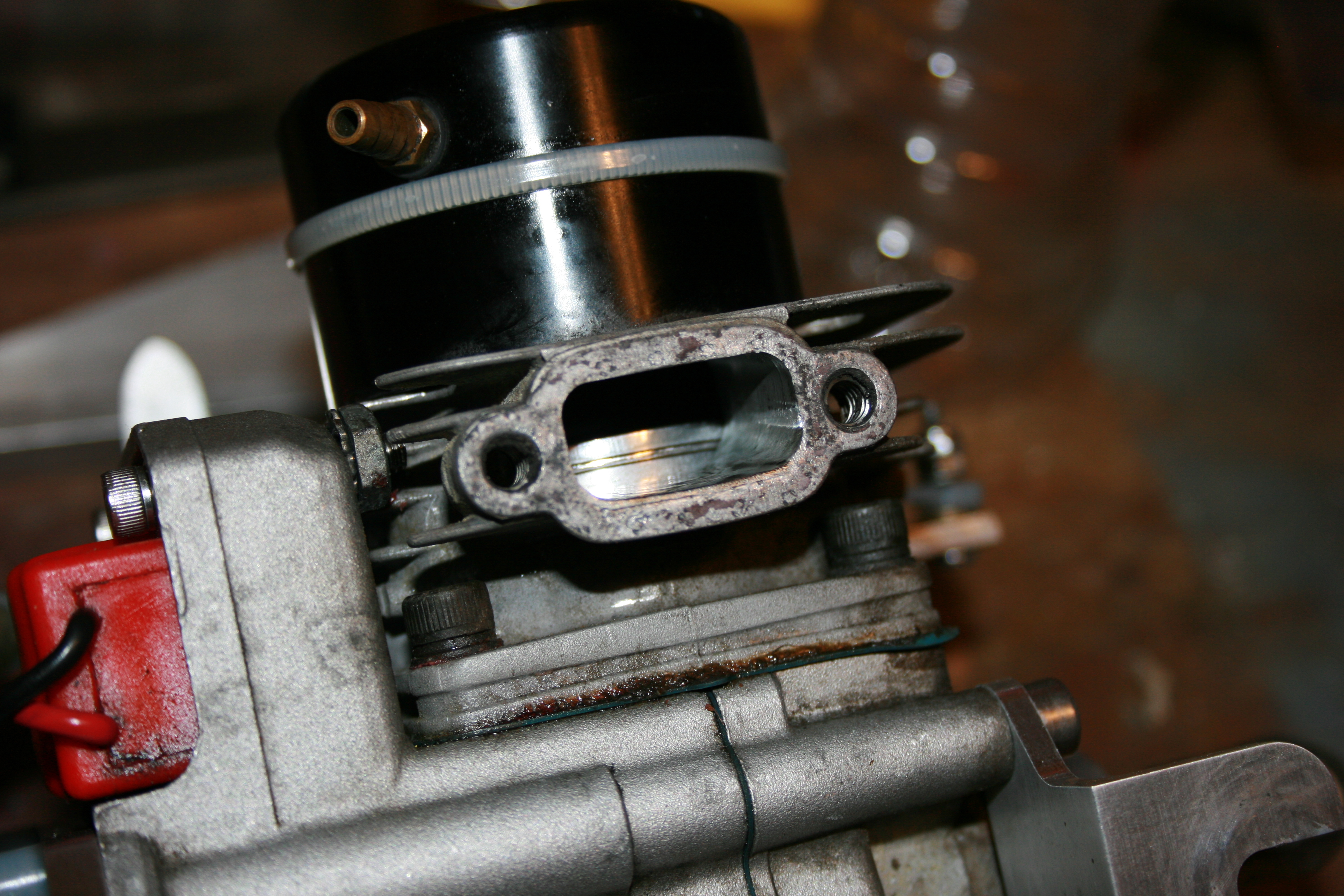

tapkoote replied the topic: Re: Zen compression
Scott
this motor was on the shelf for 6 months or so
and after running it today seemed to be fairly nornal
my old eyes don't realy see much on the ring, but under magnifacation there is some discoloration on the top edge. Don't know if these pics are good enough to tell.

Scott replied the topic: Re: Zen compression
Can't definitively tell ? ... but rings light reflection does seem to be such it may be the case. Taking a better picture in close using macro may be best if your worried about it ?
On the other hand you saying it's running fine. If that is the case don't sweat it.
Scott
the top two pics , the ring apears to have to reflective surfaces
slow puling the motor felt OK after it ran
but the performance was about par with the stock Zen
Is there a remedy , can that edge be beveled?
Thanks tap
#17290
In a chrome bore engine prevention of ring clipping is in the profile the exhausts roof when recut. We want roof to be a gentle arch so ring starts to get pushed back into it's groove on outside edges first and continues to get pushed in with the middle of EX port roof last to close.
If Ex port roof is FLAT across now, NOTHING you can do but recut the roof increasing EX duration more ( Pending where set at now ? ) or live with it knowing periodic ring replacements necessary when rings getting torn up ;)
#17294
Scott
I see what your talking about
it almost looks as if the ring is hitting in the center before the edges/a reverse crown
