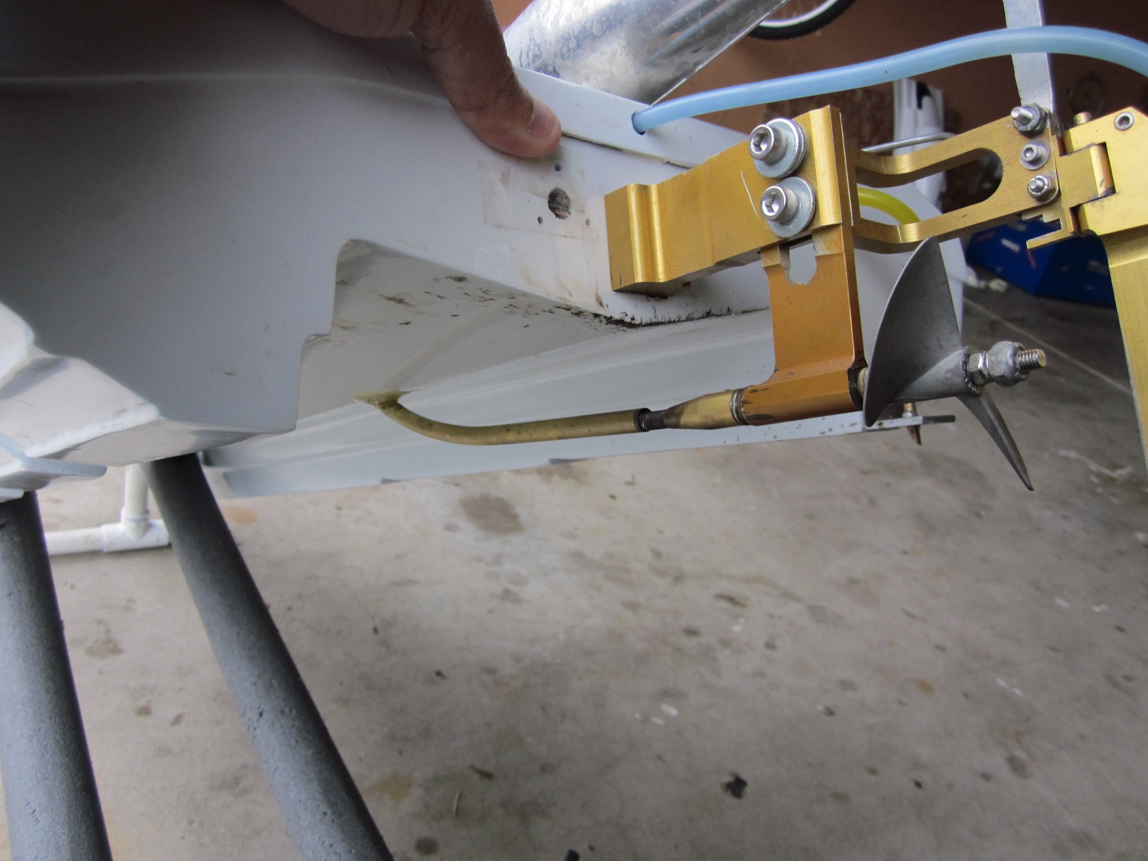

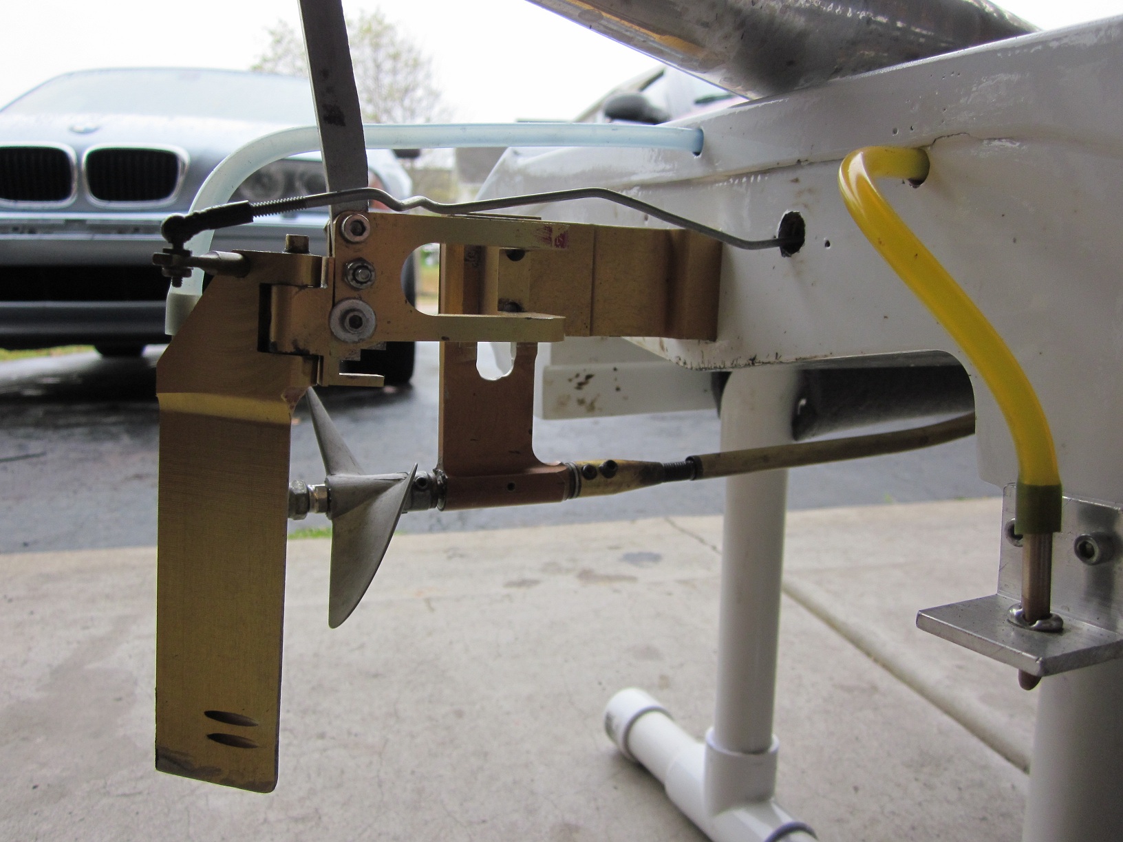

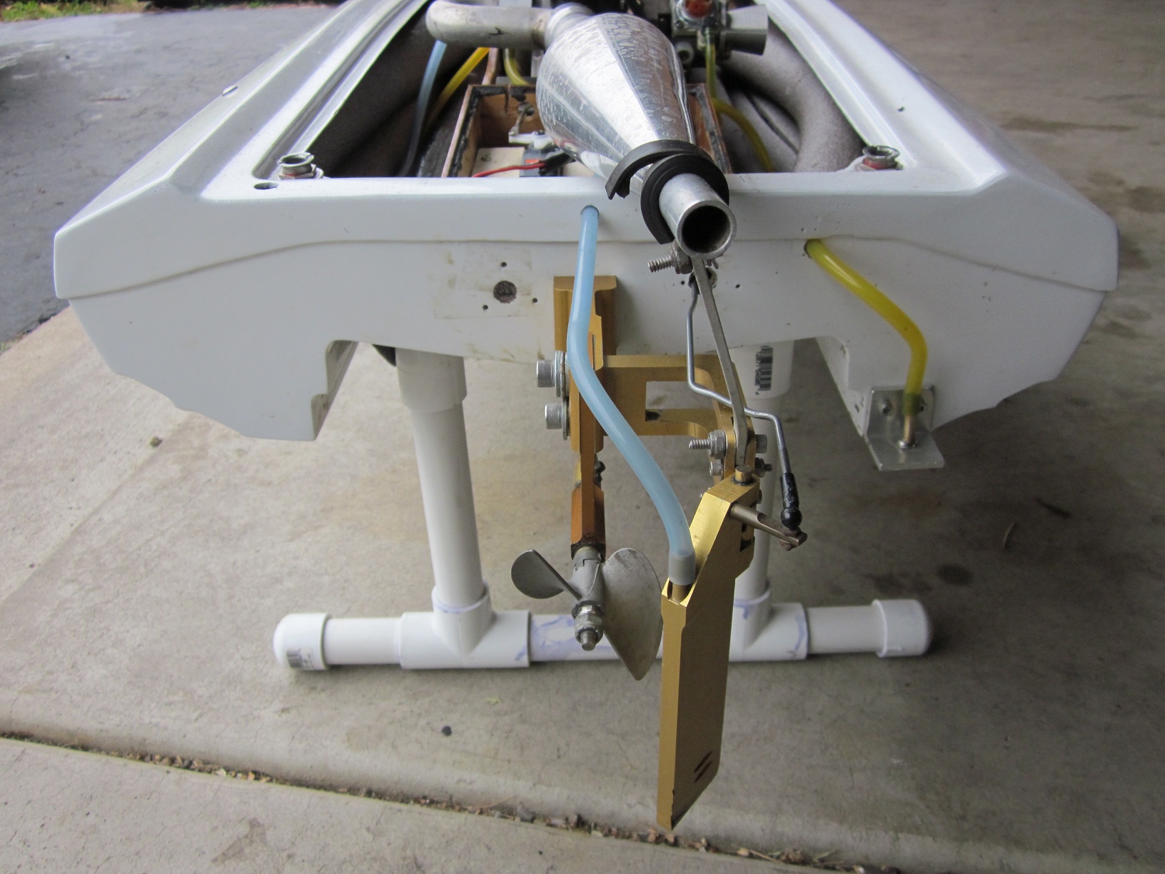

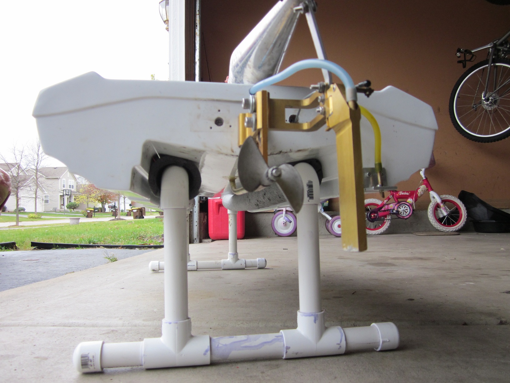

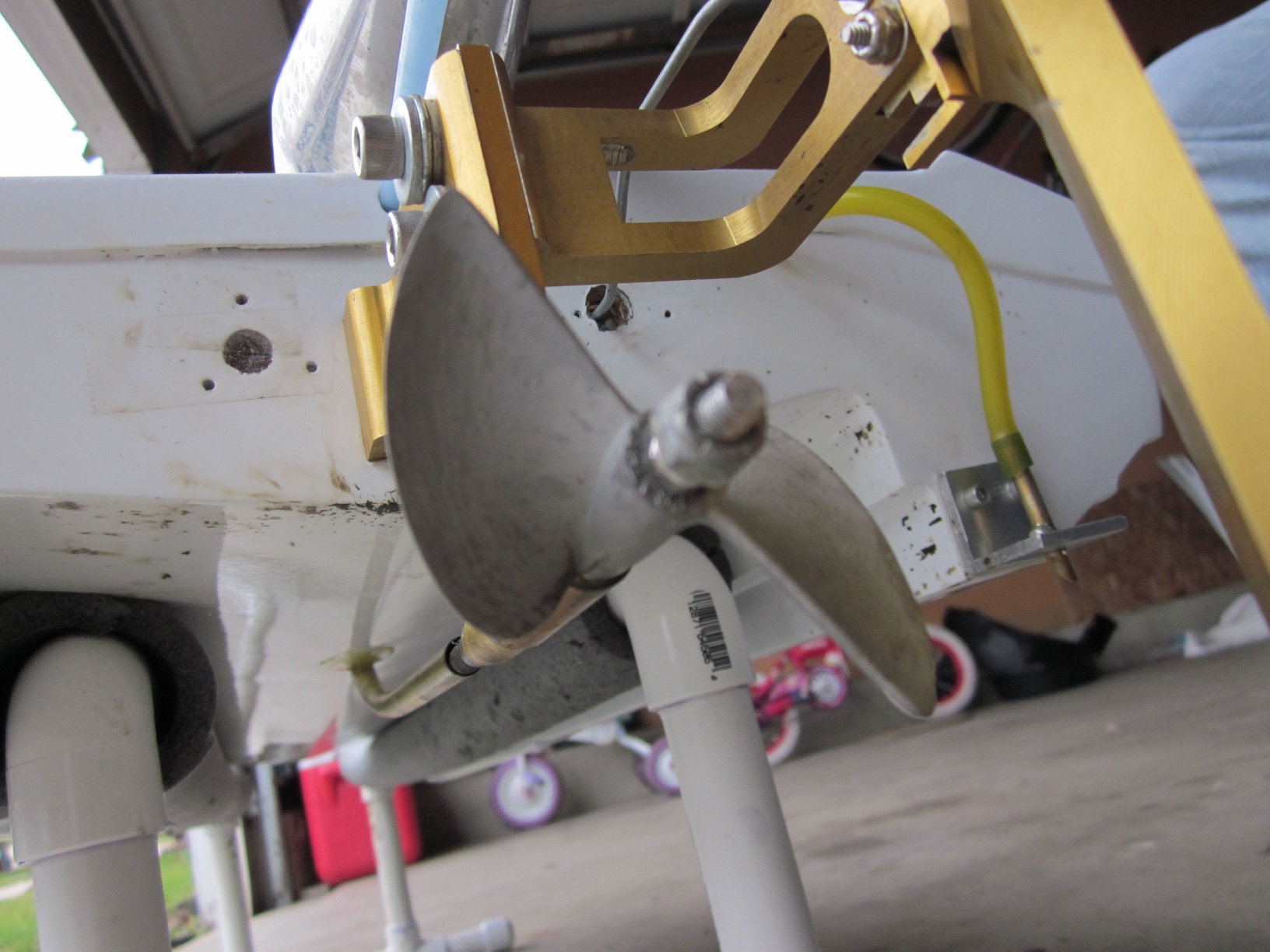

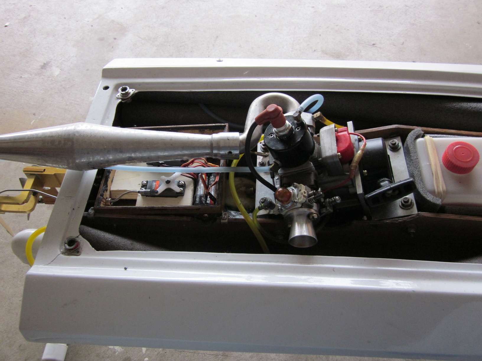

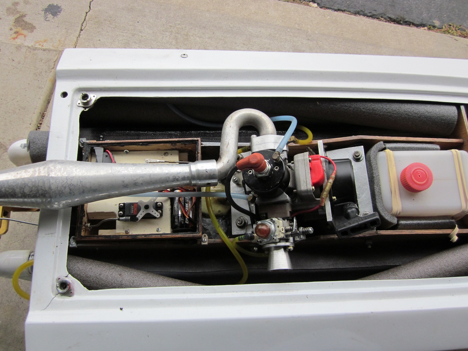

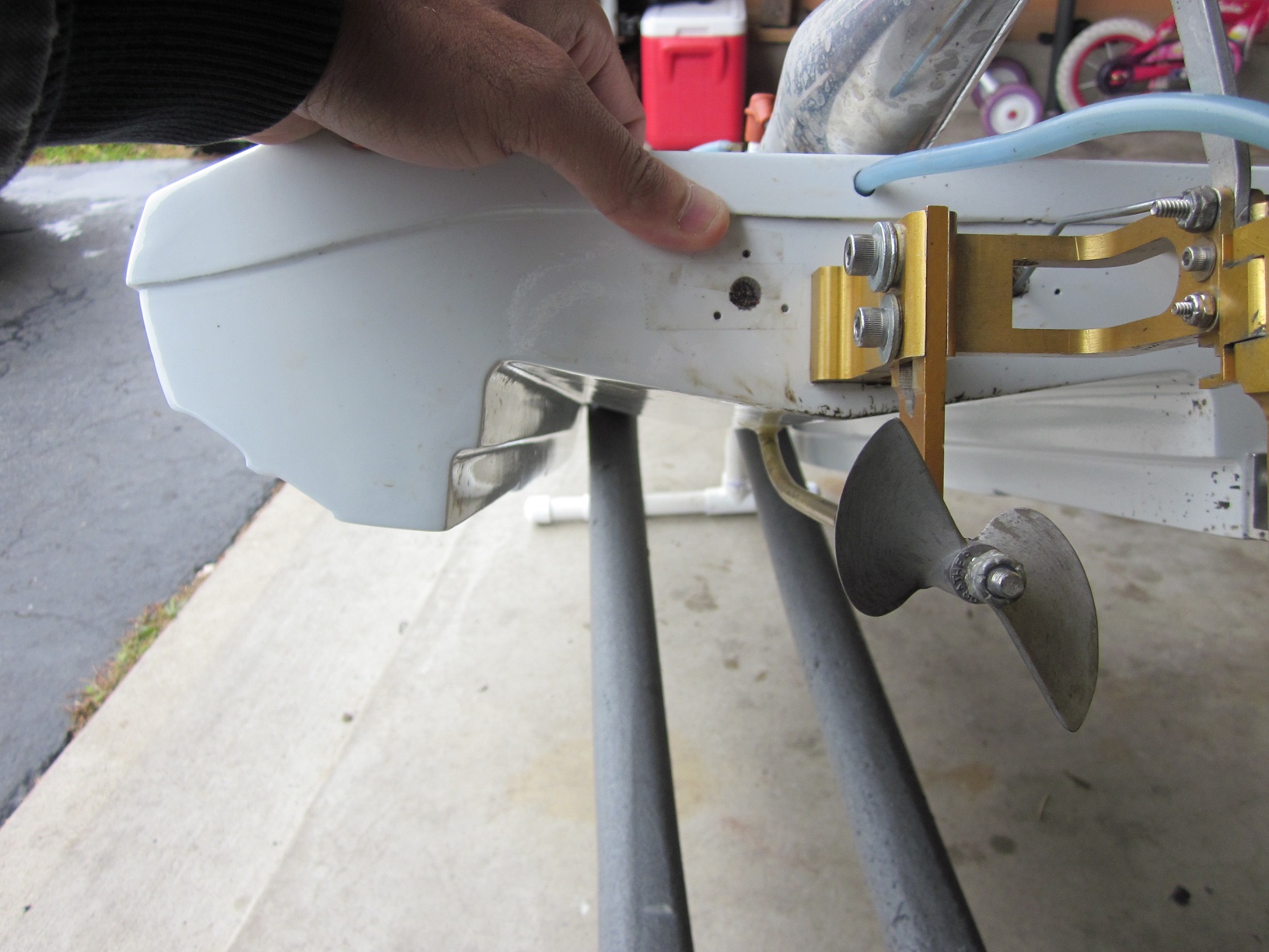

marc replied the topic: f41 Styker running slow or is this normal speed?
Post some pictures of the setup please. Engine and pipe as well as some good transom shots, level from side and rear views. With a good g-23 there is no reason not to be close to 50mph. Looks like its doing 30s max.

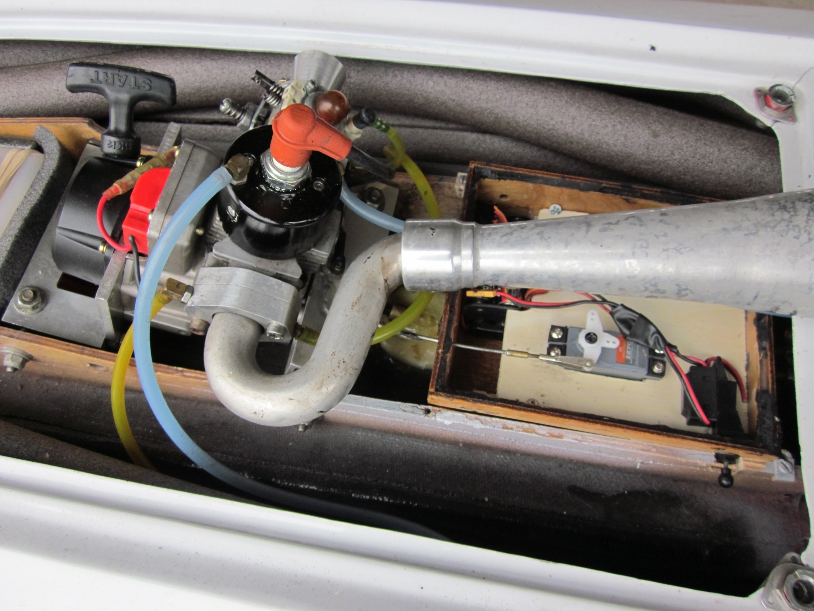

mitchesx replied the topic: Re: f41 Styker running slow or is this normal speed?
Another thing to look into is how long is the header into the pipe. Even if you shorten the distance, without cutting the header down, it sticks further inside and you're losing performance via the design of the pipe cones and it is not "coming on the pipe" like it should.

BMAD01 replied the topic: Re: f41 Styker running slow or is this normal speed?
I too would like to see more pics of the setup like Marc asked. Your boat is definitely a slug! You have no doubt a bunch of things that could be changed to get you up to speed. The 0ld 230's were famous for revving to the moon! A Bob Austin 6516/3, 350 pitch prop would be on my list right off. Raise your strut as high as you can get it to go and see what happens. Don't worry about "stressing" the motor! These motors are purpose built boat engines made to rev as high as they can. If the prop just spins and won't move the boat, lower the strut in 1/8" increments until she works better. Are you running a wrap to center header? That would also need to go away for a 100* header. For now, post more pics of the setup showing everything! We're shooting blind without them. Now get busy with the camera! Brian :)

aminoacid replied the topic: Re: f41 Styker running slow or is this normal speed?
some pictures of my setup. the stuffing tube end towards the transom is about level of the bottom of sponsoons.
