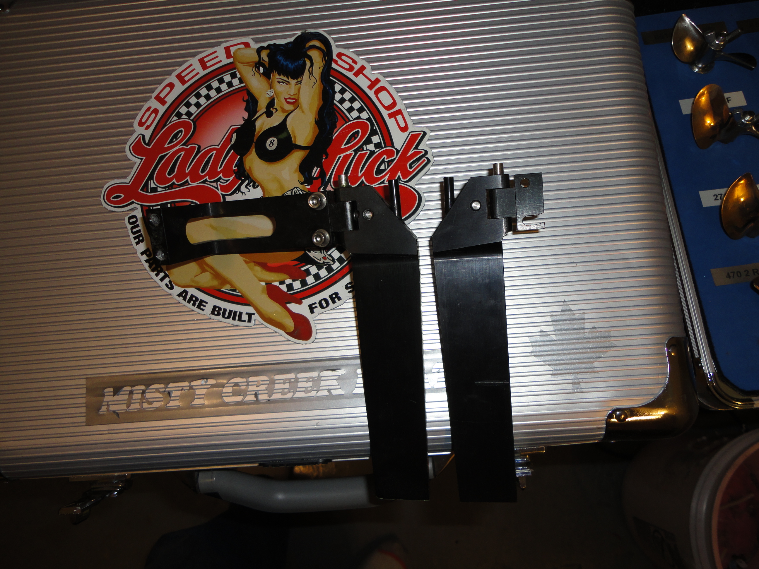

Your rudder looks like it is not mounted right too - needs to come up so 2 holes line up right now bottom hole (where mounts to bracket) the slot is hanging below rudder mount. the slot is for bottom bolt so rudder kicks back if hits something

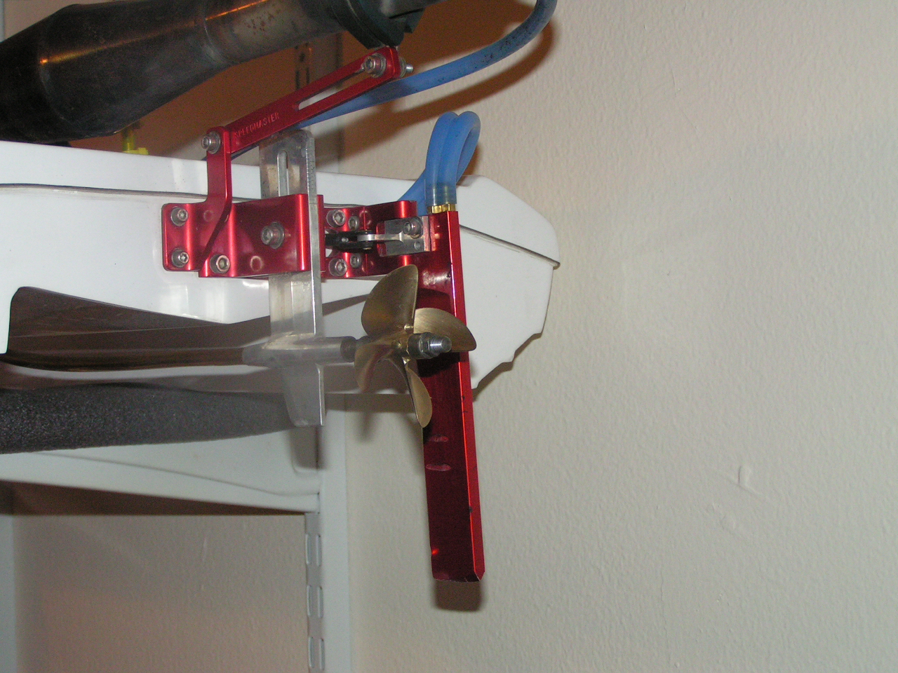

Yepper! She needs work! That strut needs to go way up! The prop needs to go away. So does the wrap to center header. Just in case you have not noticed, this is NOT a cheap hobby. Speed cost's money. It's that way in just about anything I can think of. A good 3 blade prop sharpened and balanced and pitched will set you back around $80.00 from Bob Austin. mysite.verizon.net/resrrsmy/th...pworks/id1.html A stainless steel 100* header goes for around $20.00. The list goes on...
I'm not trying to sound like a jerk telling you this, but unfortunately that's the way it is. Fix the water lines everywhere like Marc said. Do a new prop and header raise that strut WAY up and you should see a BIG difference!
You think I'm kidding about raising the strut? Here are a couple pics of the strut on MY Stryker with a 4 blade 6516 prop.

I added a picture of what your rudder mounting should look like and one bare so u can see slot i was talking about for bottom hole

Ok i seen the pics of the rudder, i'll fix that. The prop on there now is a prather 270, will that be sufficient if i get it sharpened a bit and tweek it.

I seen the previous pics of that F41 and your right, yoru strut is way up there, probably 1 inch above mine.
