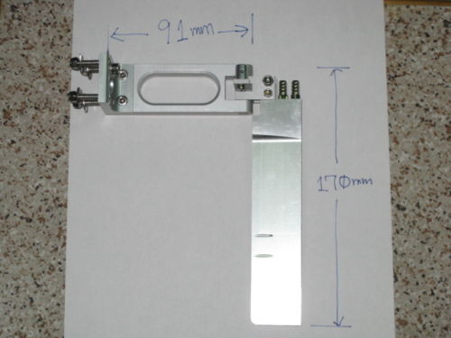

Scott replied the topic: Re: ff gas rigger help
Help where I can ... did one from a kit being loosely based off original design.
See: www.modelgasboats.com/forum/28...rigger--exotic/

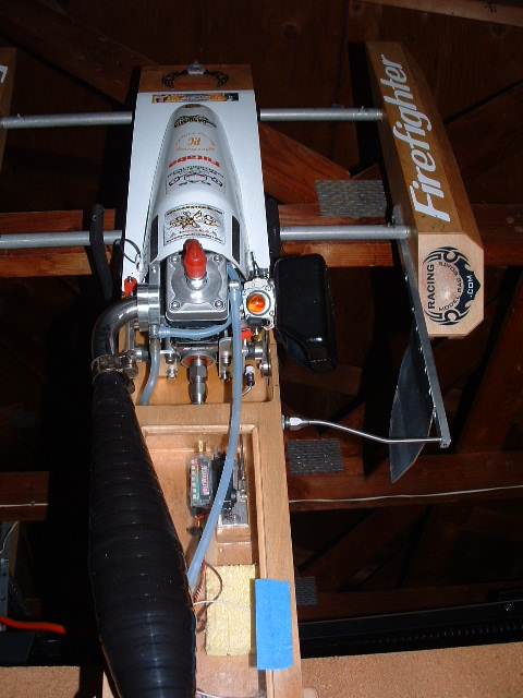

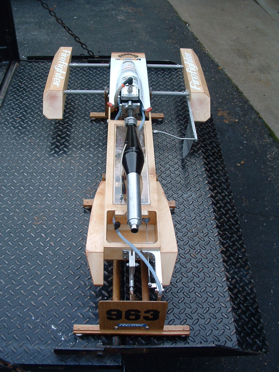

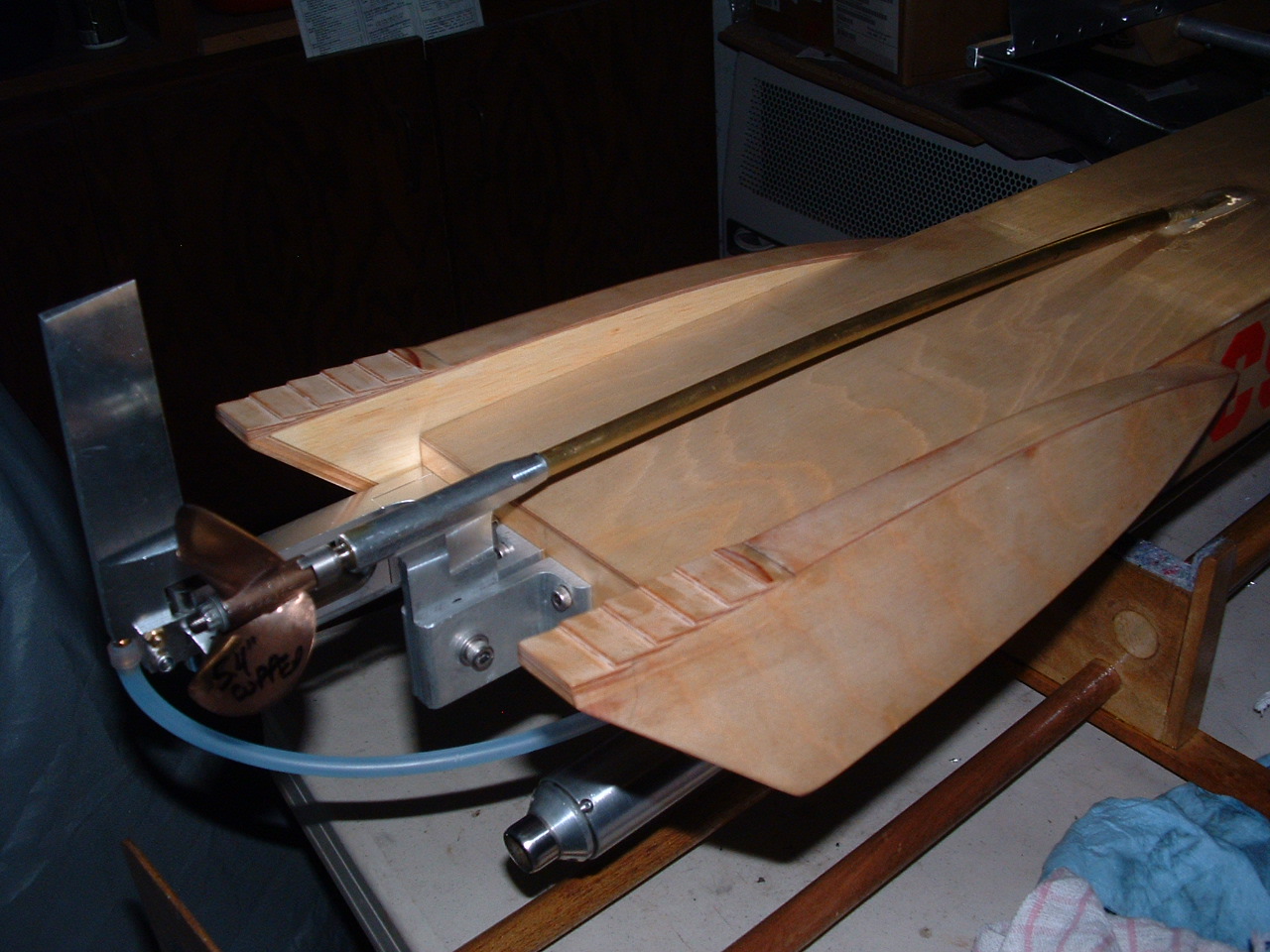

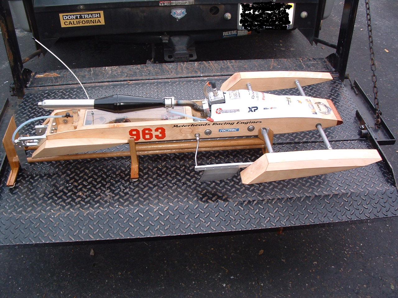

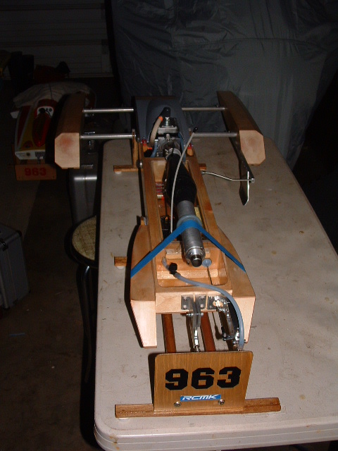

Prefer STRAIGHT blade rudders, right side mounted. My FF needed Low/No lift props and excelled with a Spoon cupped ABC 2716-20*/2 running 72-74 mph with a modified RCMK RZ rear X engine. Installed a Side X engine for a spell ( Last picture ) before selling boat.
Hope this helps ? ... need more specific just ask ;)
Oups, seems pictures have been lost ... OK, some fresh uploads :whistle:

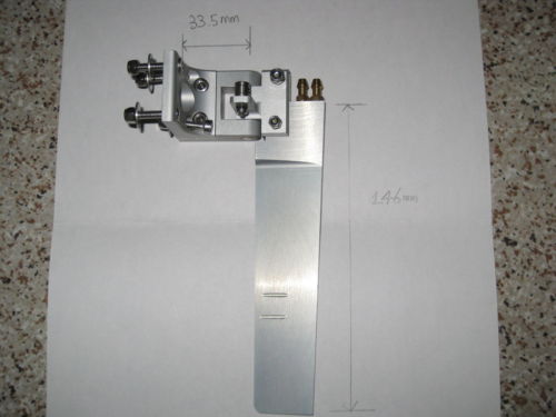

rudder size. looking at one that is 146mm long (measured to water fittings) i guess 160mm overall, 33.5 wide. leading edge of rudder is only 38mm from transom. your rudder looks to be 100mmm or so from transom. which way do i go?
On the FF ... because rear sponsons trail so far back, unless rudder is inboard of tubs outside edge blade will interfere with inside edge of sponson.
Set mine up so lead edge of rudder was BEHIND trailing edge of sponson and very near outside edge of tub where clearance was not an issue.
** This position IMO is not optimal on a rigger feeling rudder in close to transom and prop out behind is better
Getting that relation was not very doable with the FF design so did it like I had done.
It ran and turned just fine likely because prop wash was minimal with the cupping/low lift mods done on it.
As said ... likely first rudder assm shown.
C/G in riggers really is one of weight distribution and design of hull needing/wanting prop weight or not ?
4 point riggers such as the FF generally not as critical having what it is ... what it is ;)
You manufacture or mount turn fin and it's brackets relative to where C/G ends up.
** IMO, the turn fin design chosen pretty much needs to get mounted so the water passing along fin at surface places hull RTR C/G @ on fins rear 1/3
Picture shown of hulls side profile has the C/G very rear the rear motor mount bolts.
