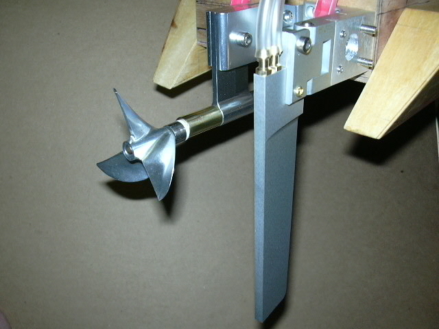

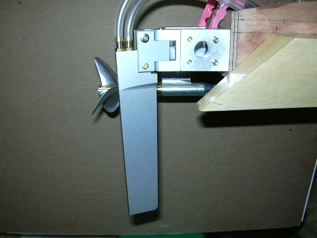

scott, pic below shows what i plan to do with rudder
i have moved rear sponsons forward a little
got a short rudder and lengthened it 19mm
lengthened strut 22mm
this gets things setup as you suggest is correct and is the same as my miniY
miniY is 4 point, very similar to ff only smaller. moving r sponsons forward on ff gives a sponson moment same as miniY so hopefuly won't upset things
#18309
