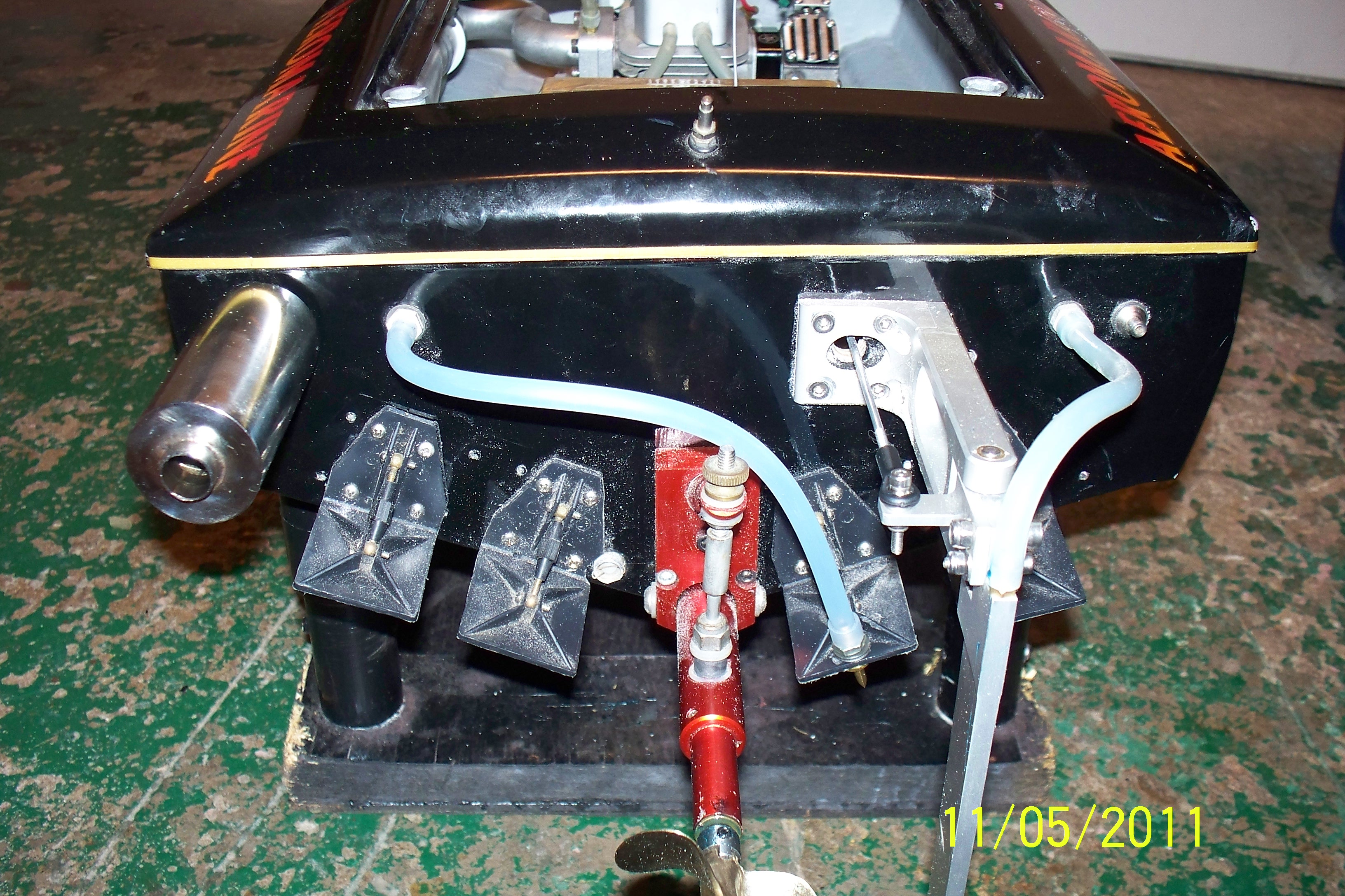

315neil1007 replied the topic: Re: Watercooling... to little or to much?
That Octura water intake will out throw any rudder waterline.duel or single I have a duel head water line and that side shoots 2 1/2' up. Your should be fine.

Scott replied the topic: Re: Watercooling... to little or to much?
Those pick ups work GREAT ... but sadly at a great DRAG cost.
As for actual temperature of engine while under a good load ... very warm to HOT is what ya want just short of blowing steam. 150+ to 180* degree F is perfect IMO
