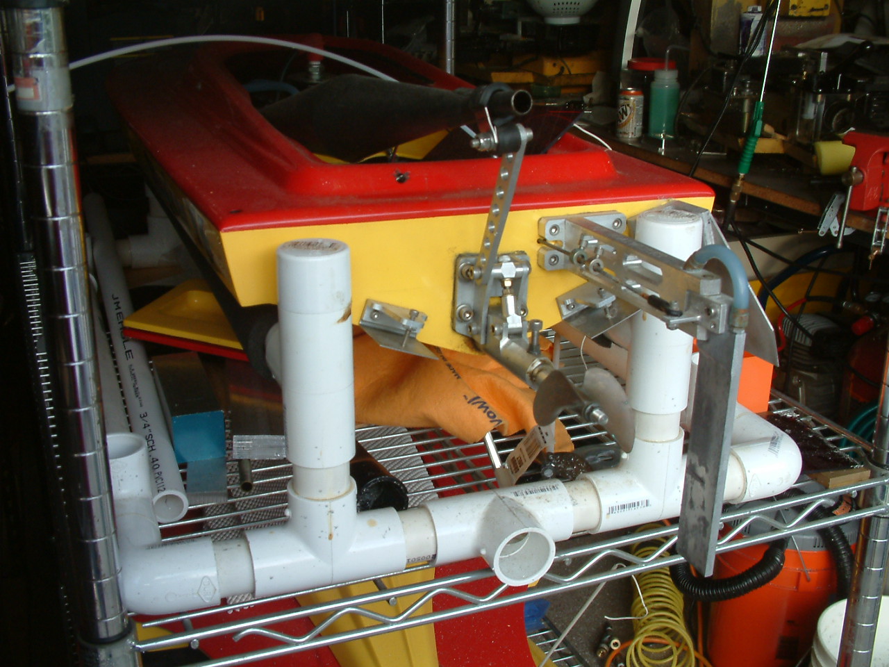

Steve Seebold replied the topic: Re: A lots of question for a first boat building
Deadrise 22 1/2 degrees per side. length 45 to 48 inches, height 5 to 7 inches, hardware, see photo.
