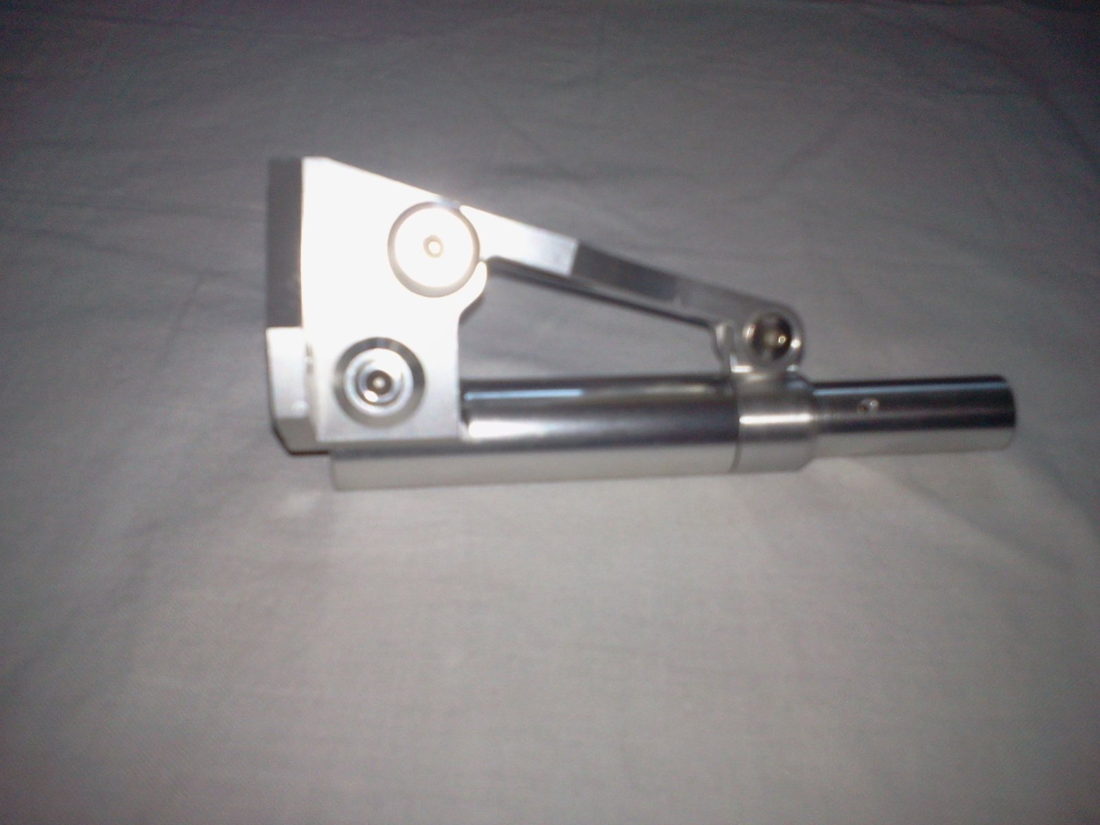

Hey fellas, I'm building my first boat (51" Cheetah mono)for me and my son. Can someone show or give me a link to some good pictures of how to mount a tube? I have read to just use a 5/16 tube mounted in the boat, a 11/32 tube mounted in the boat with a 5/16 inside it, and a few others so I'm confused. I was actually thinking of 2 or 3 short pcs. of 11/32 mounted in the boat with epoxy (transom, bottom of hull, and close to engine in a t bar of sorts) and then the 5/16 through those. I am trying to keep this as simple as possible because I am a total newb to these boats. I will be using a HOR(i think) adjustable stinger so how far should the tube come out of the back of the boat? I'd really appreciate any help.
#19873
ThaHodgehound replied the topic: Re: Stuffing tube help??
Here is a pic of the stinger if it helps. . .

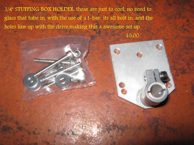

U can play around lots or
Spend the 15.oo to Tom for the backing plate that comes with that drive (has clamp in it and 5/16 tube just slides in. Simple.
It is made for that drive
EVen a clamp if u use 2 tubes is 9,00 so just get plate bolt in and bolt in tube

I wasn't aware he had that! kewl!! I will check and see if he has any! Seeing as I got the boat from him in the first place! :D
