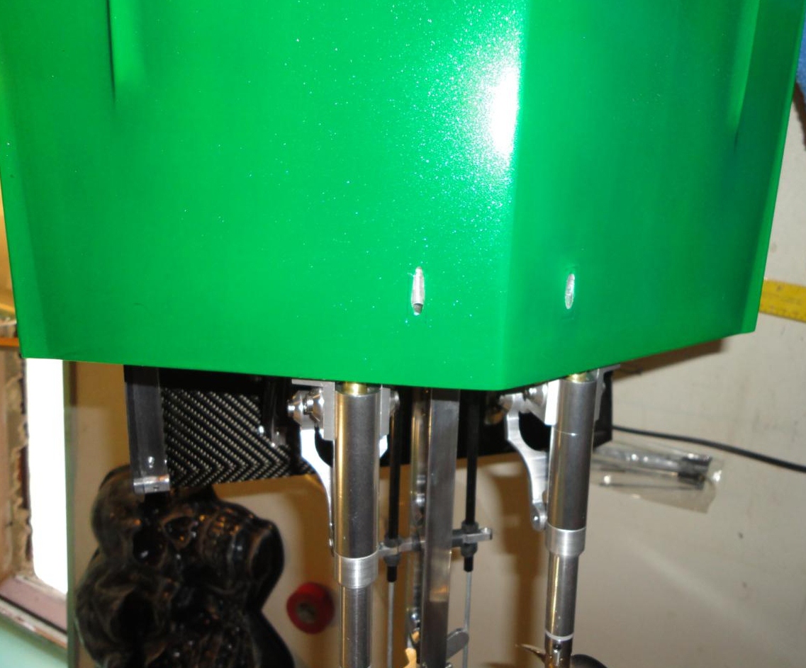

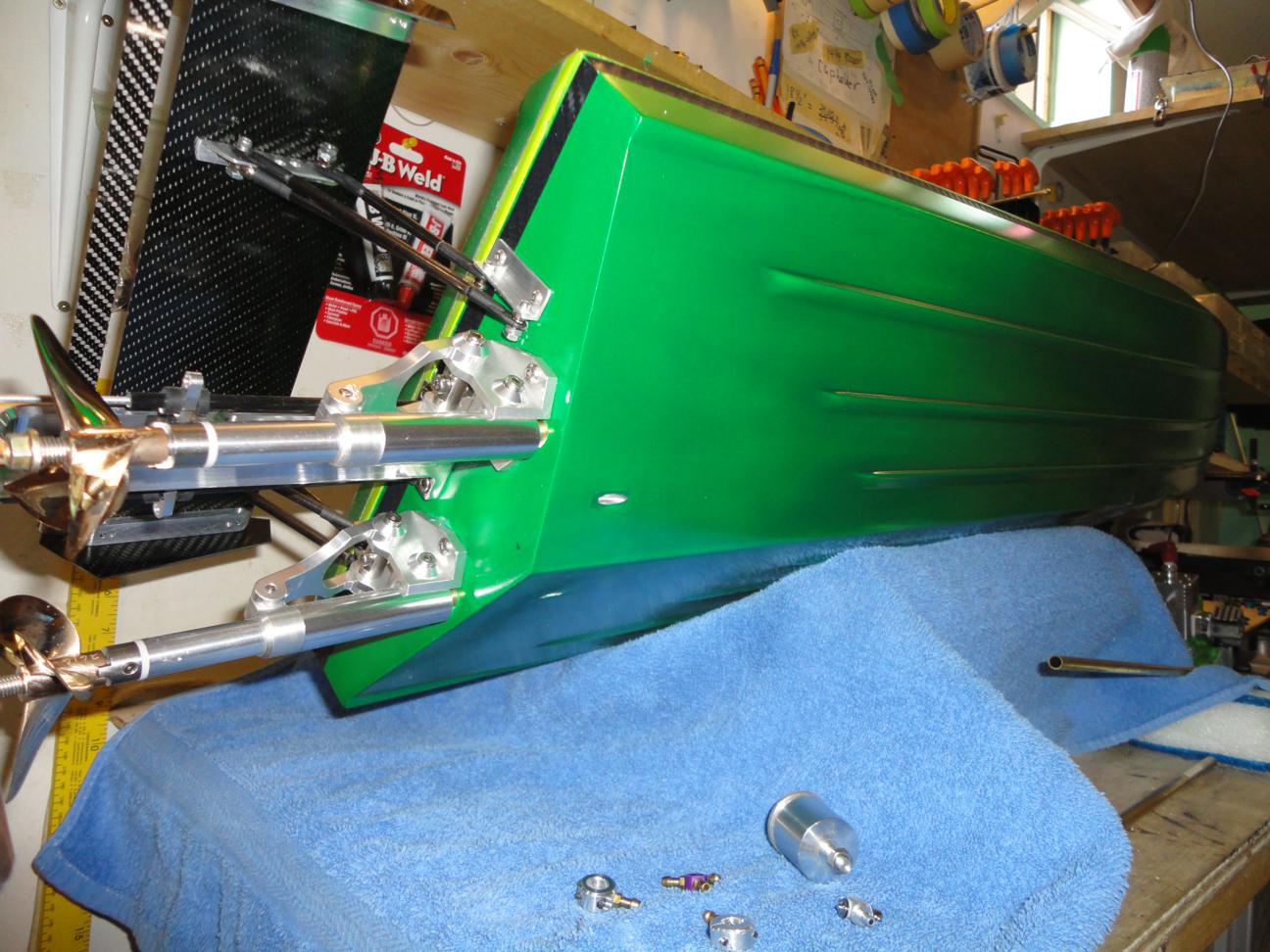

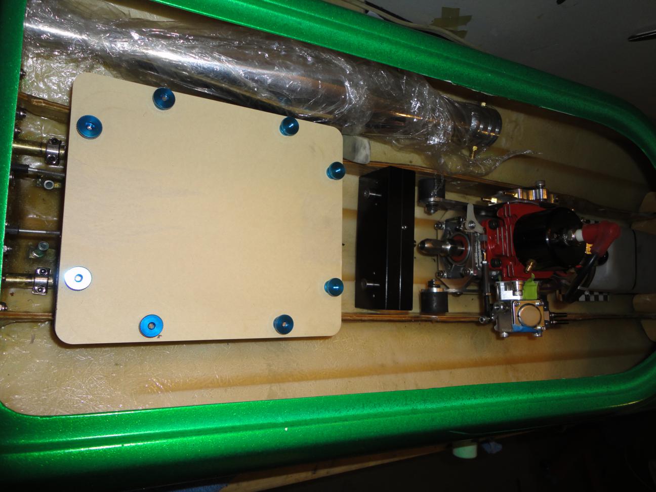

Started on rebuild of my favorite boat a while back - slowly coming along some thing a little diff....

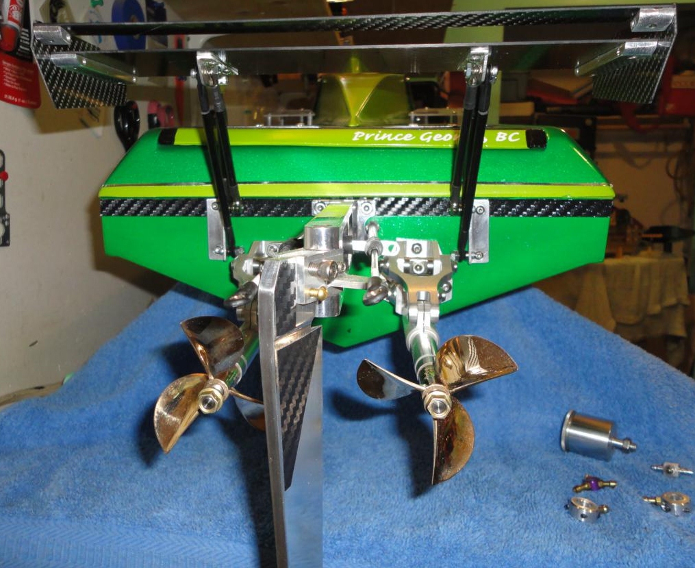

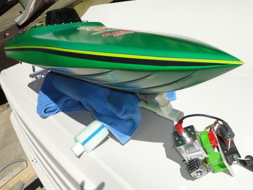

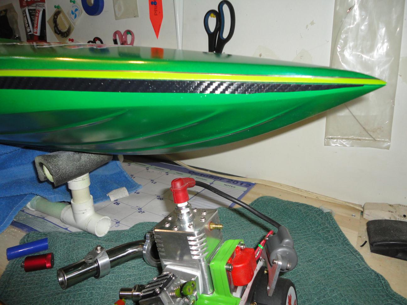

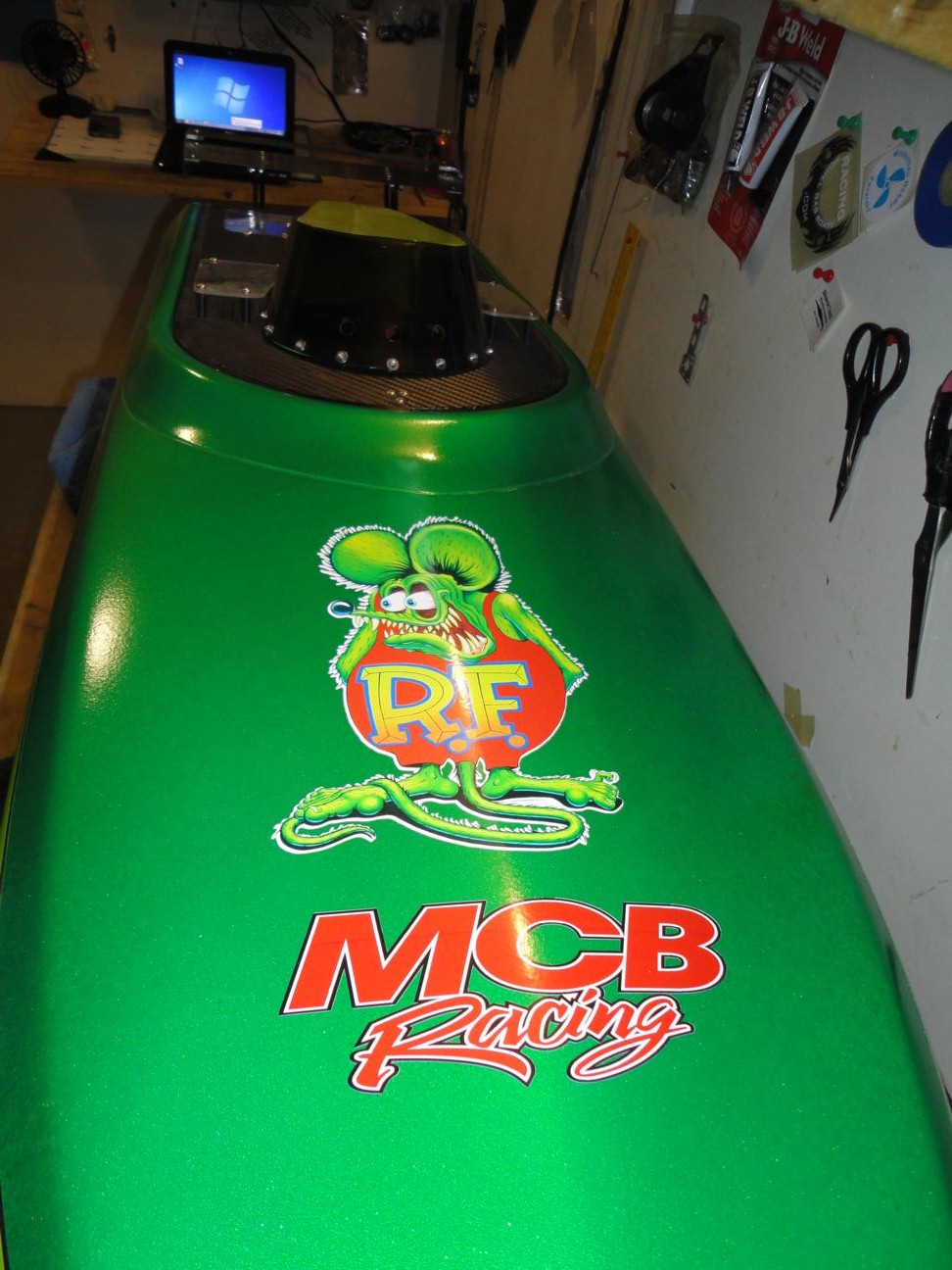

AC Razor Hull -- serial number 6 "Rat Fink"

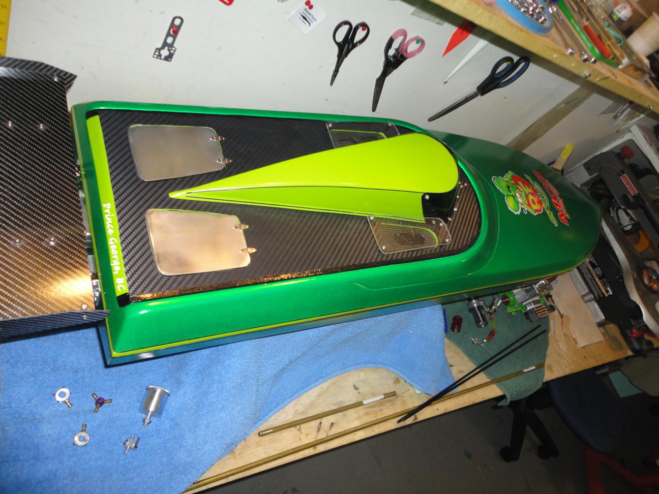

Repainted - greeen hull , green metal flake deck, CF trim and key lime stripe
Hatch - hand made wood - key lime green and CF (3M) - rear alum 'flaps' open

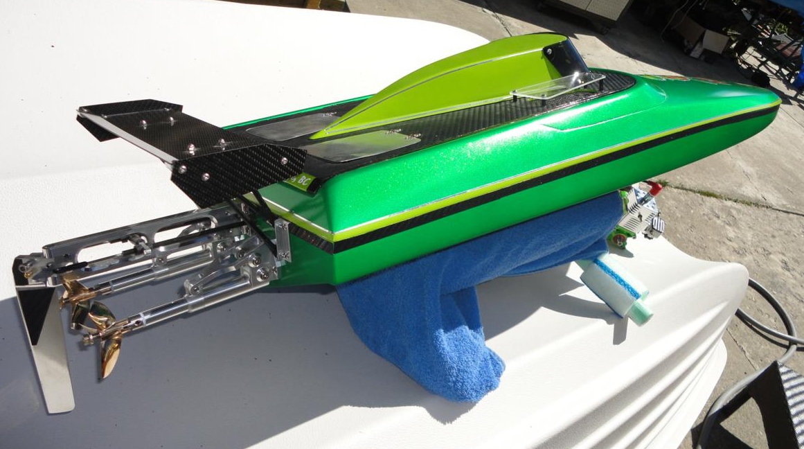

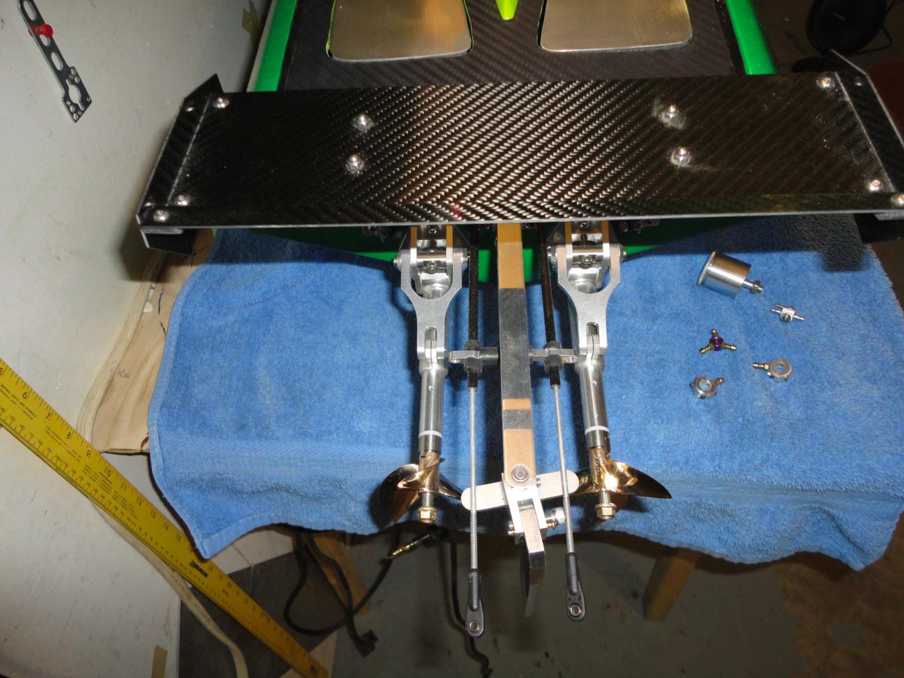

Spoiler - 4mm CF Plate - CF struts with 4/40 rod and ends - made brackets and spoiler
Drives are from Dave at PMB (HOR drives) with stainless prop shafts - square input
Rudder is Speed Master 6" with custom twin arm bracket / polished

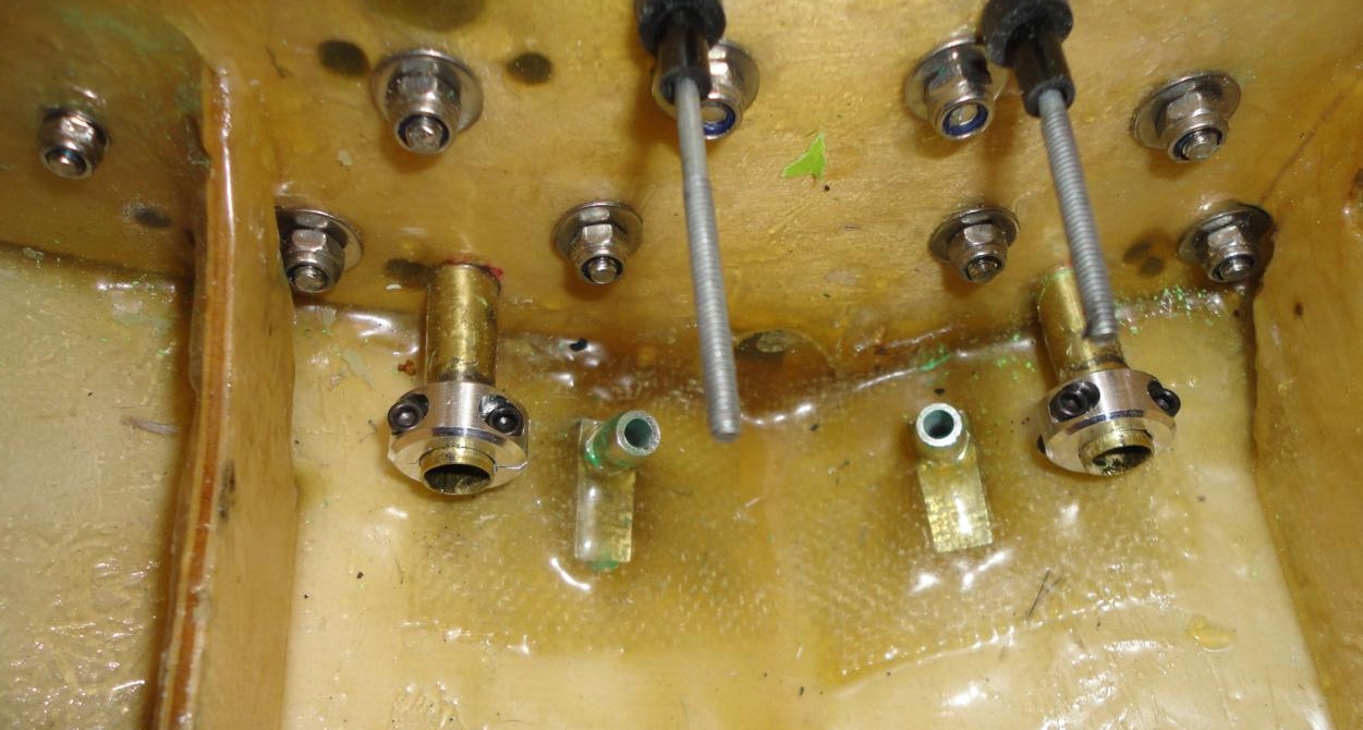

Water pickups in hull - flush mount and 'opened'

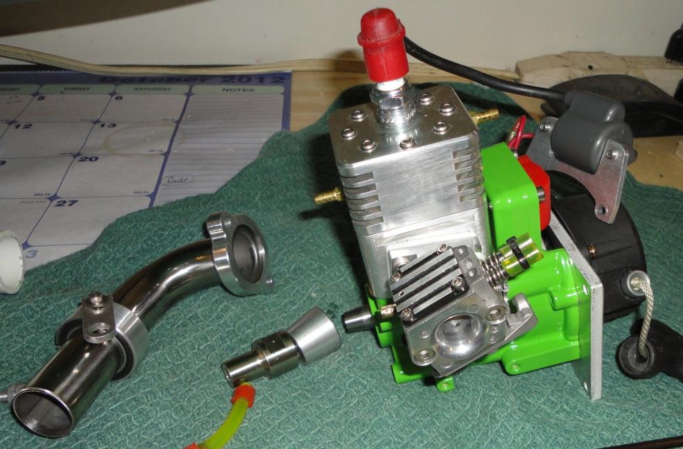

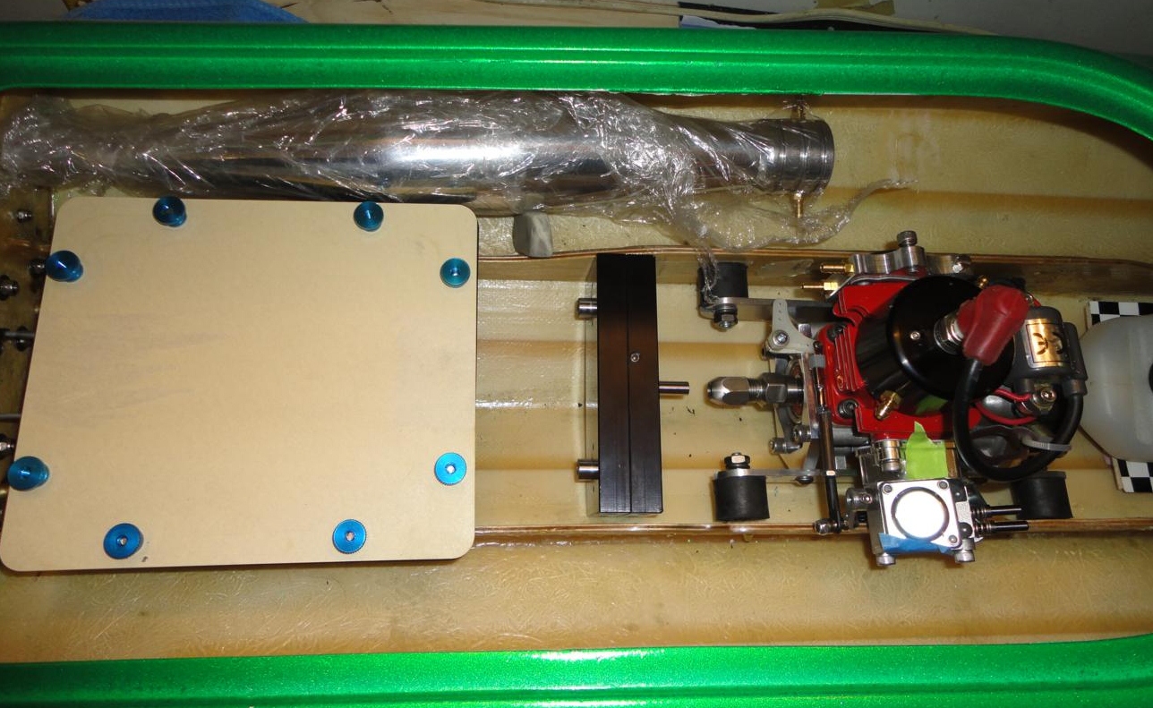

Not sure what engine yet 29 or J&G
J&G mounts -
Couple of diff pipes to try
MHZ 1572 gearbox 1 to 2 out L&R + 18%
G Force 2616/3 L&R (shown) few other sets to try
need few more parts - so still a while but figured I'd show some pictures
