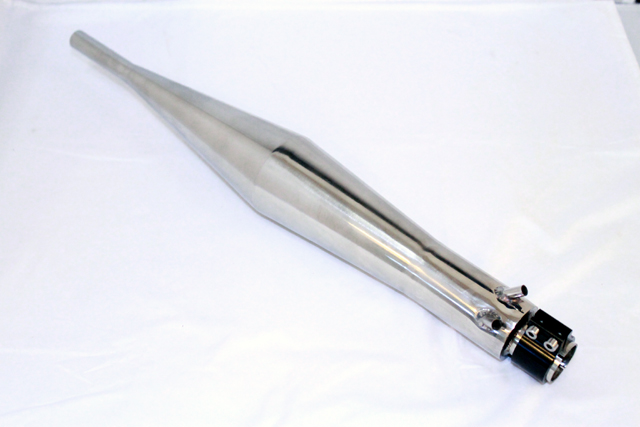

davidpaul replied the topic: Re: Tuned pipe
This is the pipe I have brought.

315neil1007 replied the topic: Re: Tuned pipe
How will you secure your pipe if you cut the tail off?
#20066
I don't want to cut it off completely, I just wanted to know if I can shorten it without affecting performance. The alloy pipe I have has only 1" of stinger out the rear of the pipe, the new stainless pipe has nearly 4"
Regards

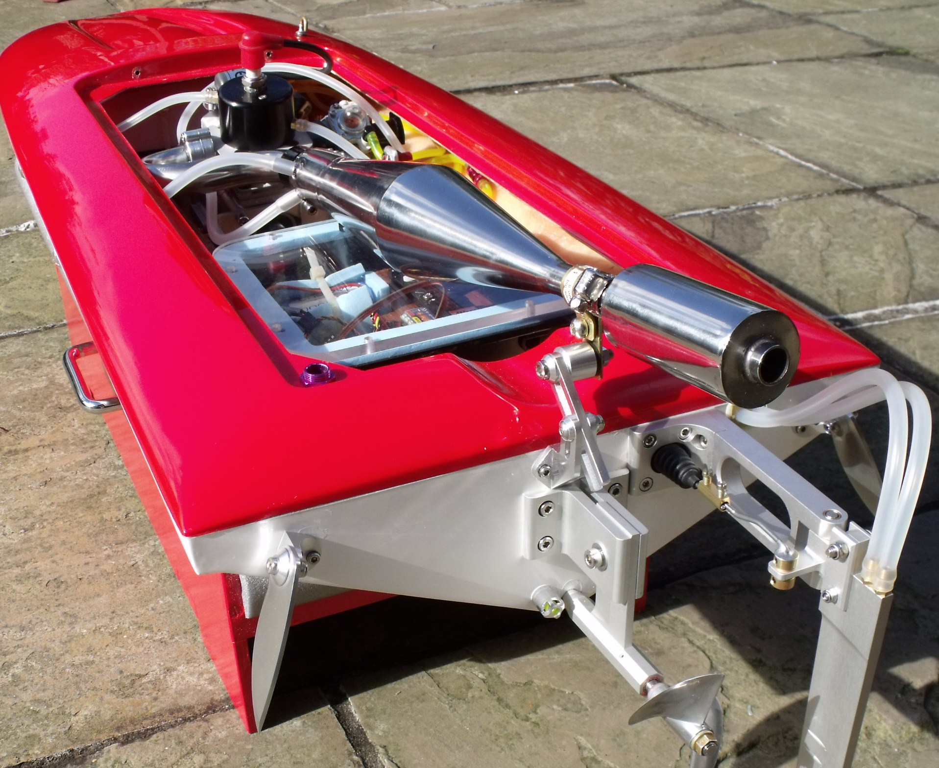

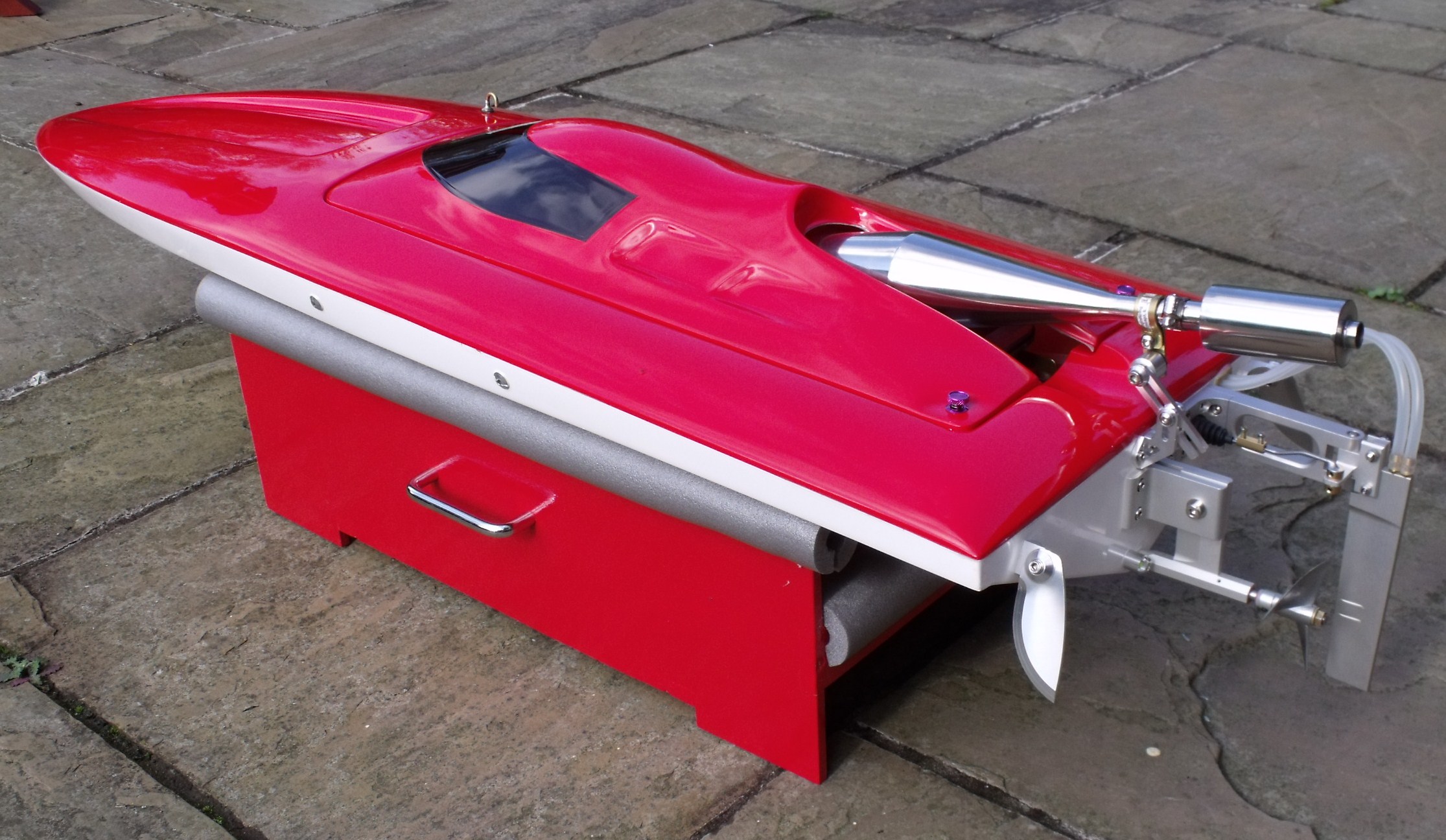

Craig Dickson replied the topic: Re: Tuned pipe
Hi David
Your photo caught my eye as I have been using this tuned pipe on my Lynx for over two years. The tail pipe on mine is about 2 inches long and came that length from new. 4 inches sounds a very long tail!
I kept mine uncut because I needed to fit the extra silencer as these pipes are noisy without so perhaps bear in mind the possible need for extra silencing before you cut any off the end.
This photo shows my pipe installed. Oh and I do like the way these pipes clamp onto the header pipe as opposed to those that use O rings to slide on as it is much more secure and there is zero chance of cooling failure by way of perished O rings.
Craig
