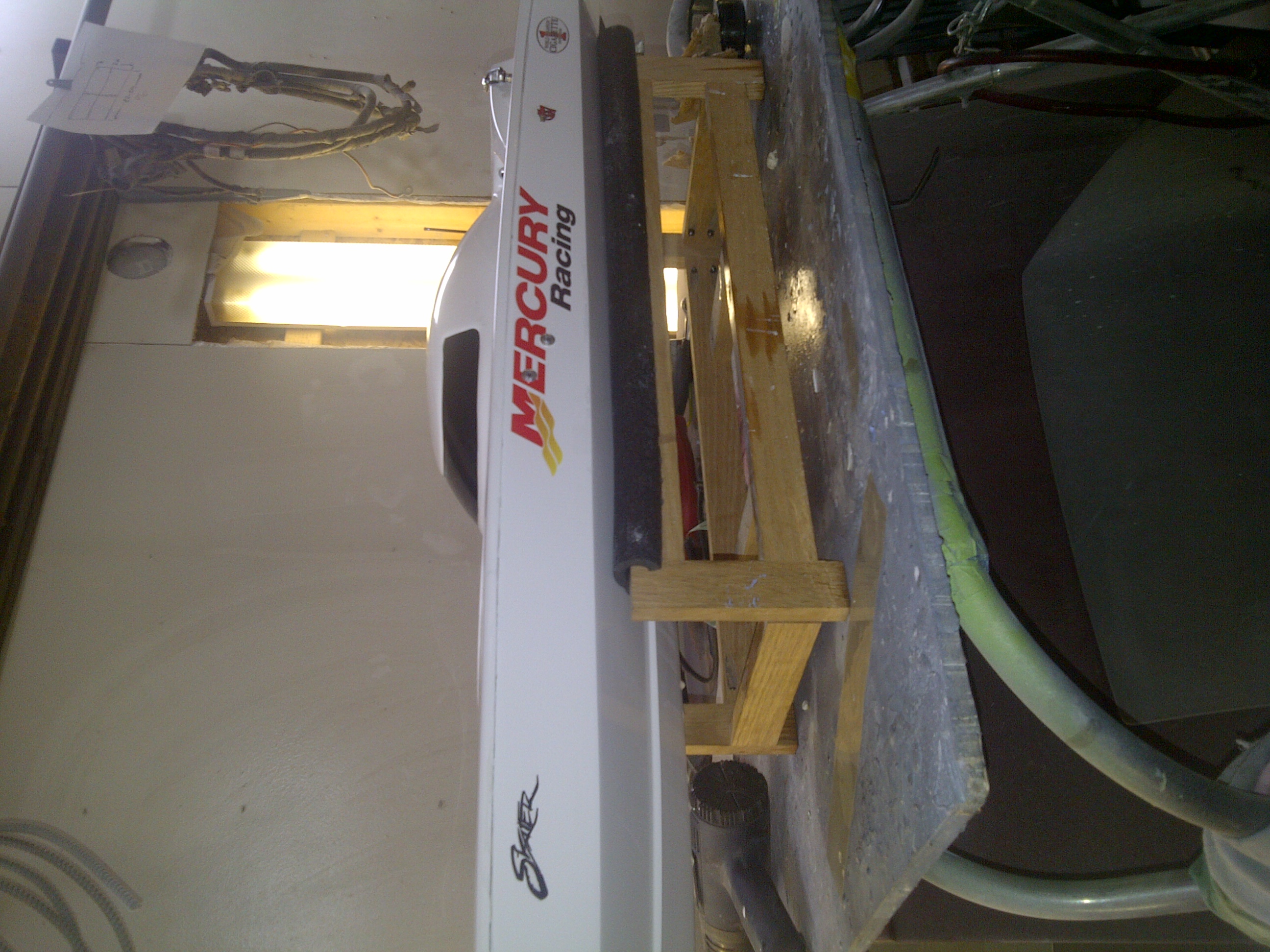

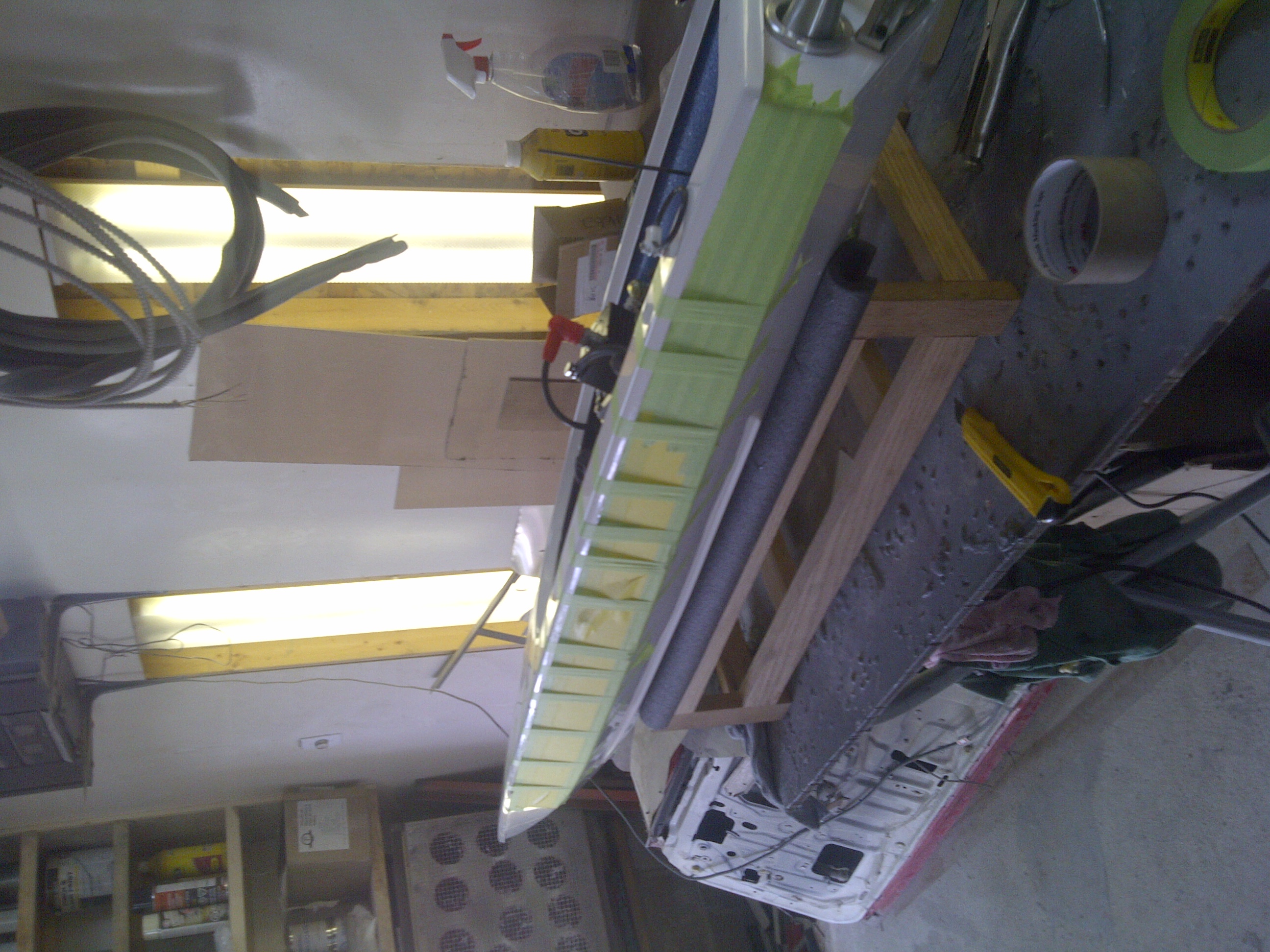

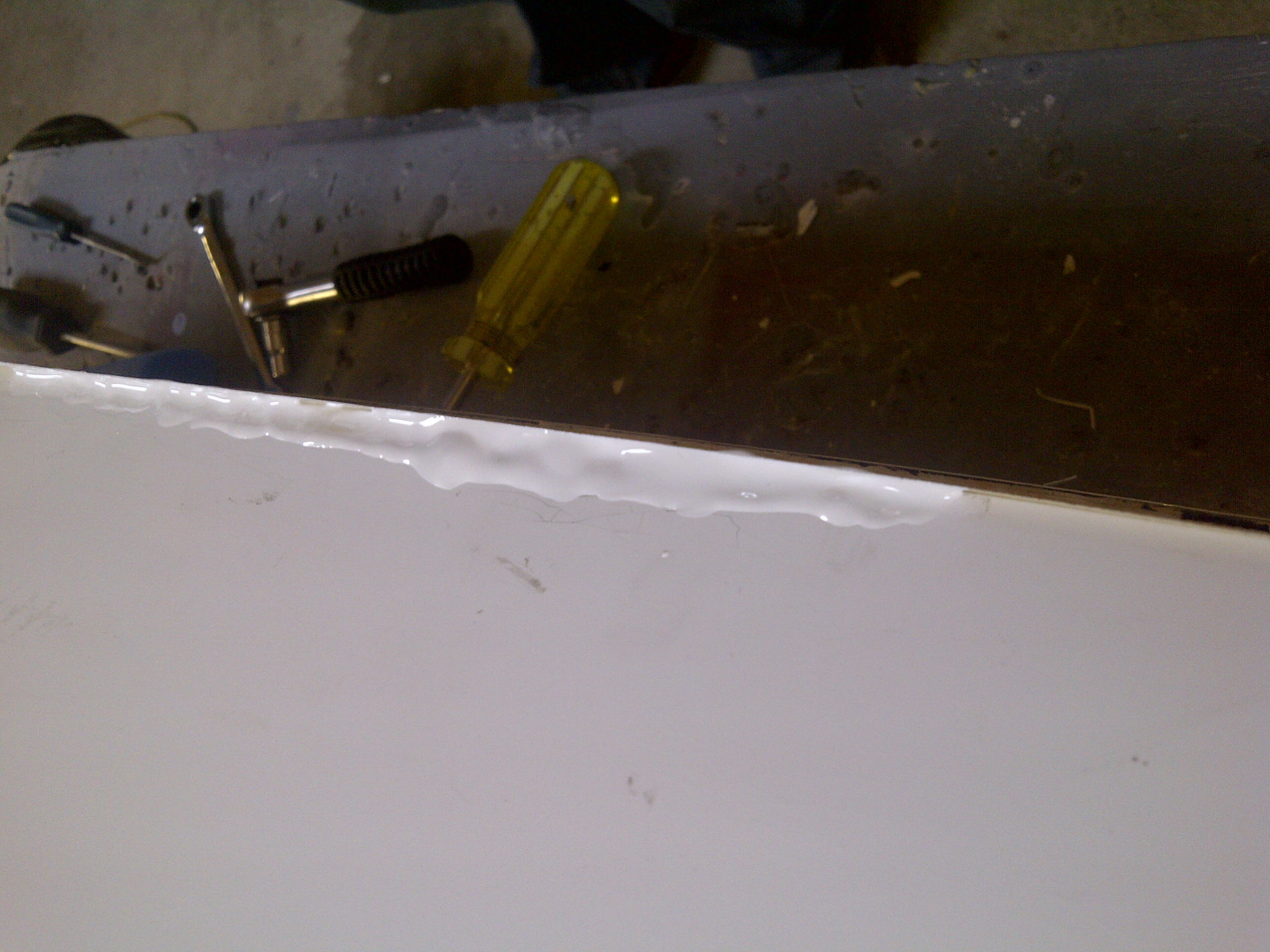

Hi yes it works good,and i put the waxpaper on top of the wet gel coat to flatten it out.I just built a expresscraft c-54 last week and blew the top off it in a flip.It busted the gel coat off all over the place here is some pics of the hull busted and fixed it was a mess and if it was not for tom using CF id say my hull would be gone now.

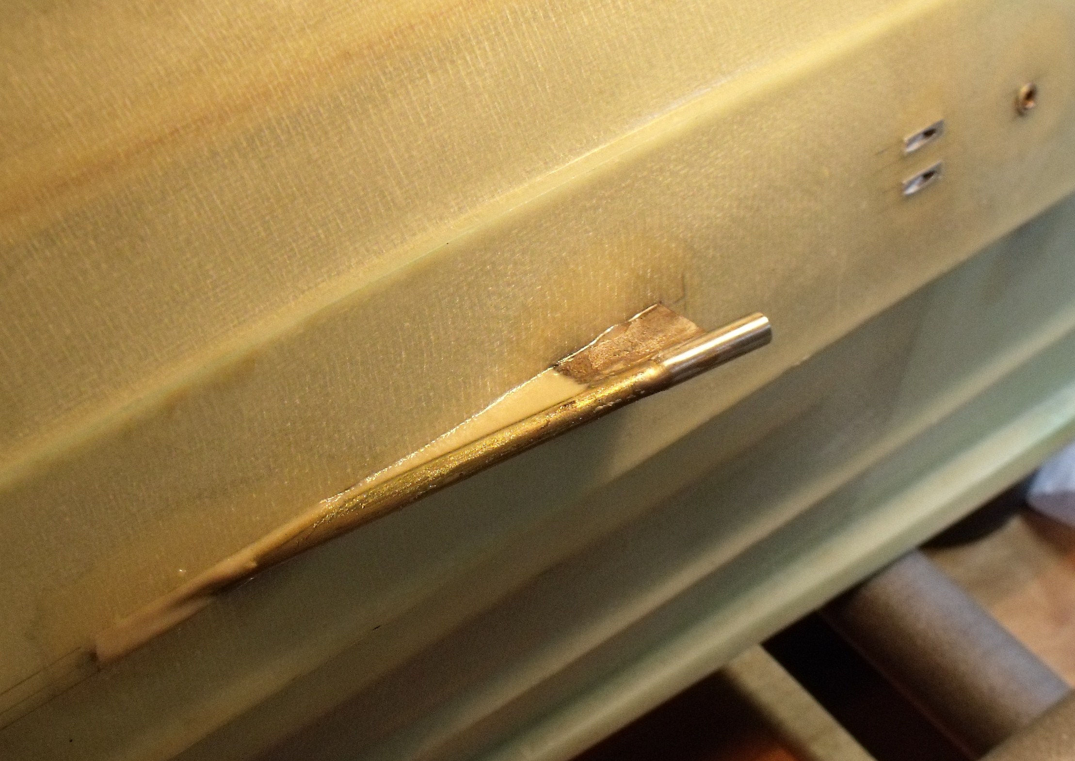

In respect of the West System Epoxy resin, I like the fact that you can add a multitude of additives including micro fibres to make it as thick as required. When using it that way I find little need for any measures to prevent spill over. With my latest build I filled in my prop tube gap with the epoxy thickened with cotton micro fibres and applied two fillets both sides of a hidden 1mm middle glass/epoxy plate support.
The mixture stayed in place until it set and will require relatively little finishing, photo attached.
