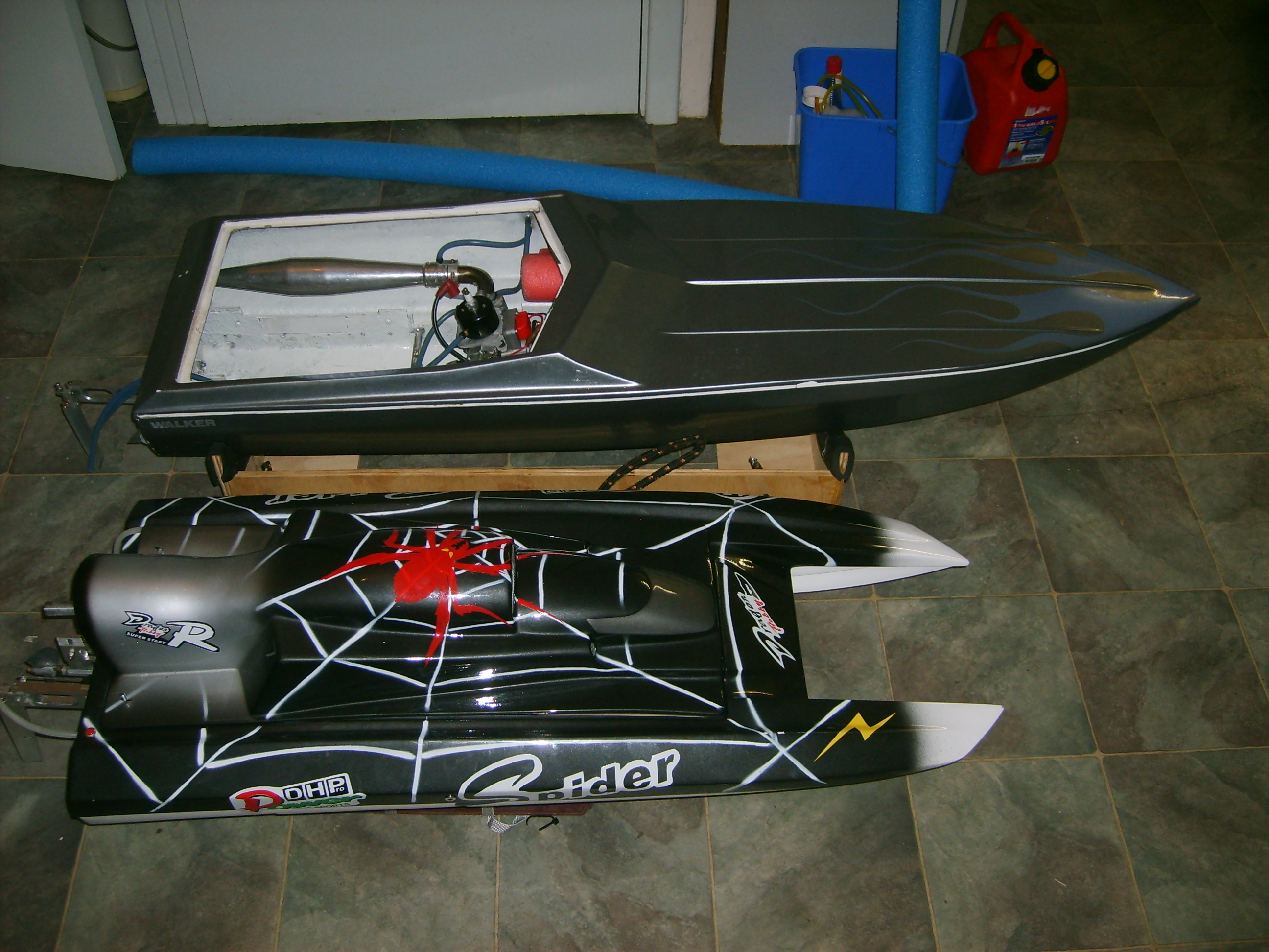

[attachment:1]C:\fakepath\camera photos 012.jpg[/attachment]
my 57 Apache is set at approx 17 inches ( 430mm to be exact) from transom. A perfect set up i don't even need trim tabs they are just cosmetic.
This will depend on your hull weight and hardware but should give you a good starting point.
Check this site in the "how to "section and will give you a heads up on balance with dowel rollers
Hope this helps
