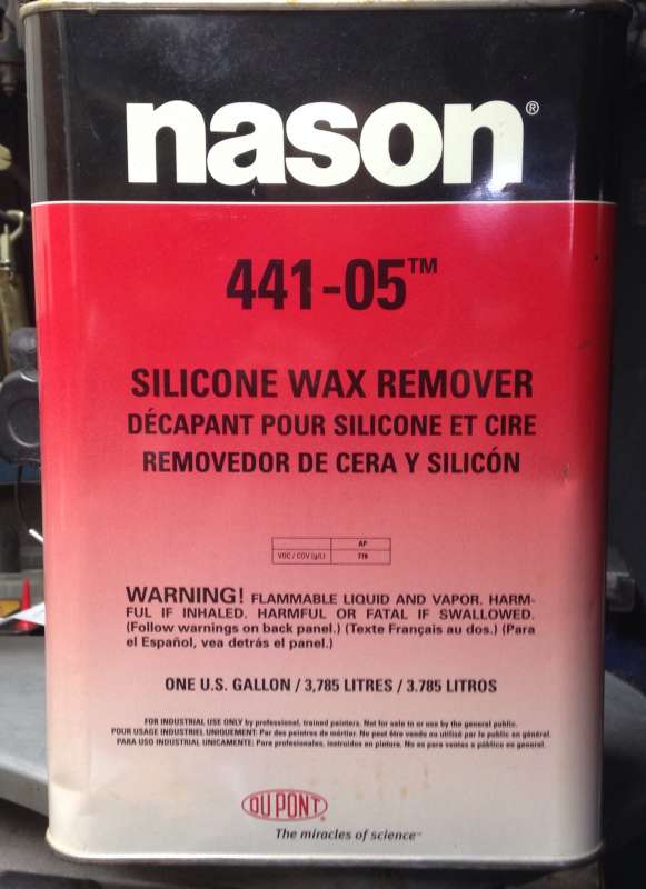

If you use WD40 you will never paint that Boat again, you will have fish eyes everywhere, use a heat gun at a distance, just enough heat to soften the Vynal, left at one corner and aply heat slowly, take your time. If there's any glue residue left, use Silicone wax remover.( Du Pont-Nason 441-05 ) it's used in Body Shops as a prime wipe. this stuff works great. Use it all the time.
Luis
