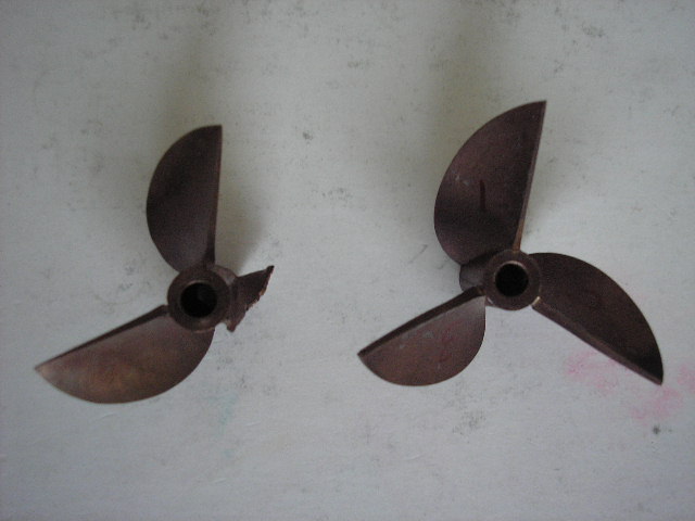

Tim K replied the topic: Warpath pro Testing
In the last video right around the 115 mark is where the prop blade let go, to bad that was a very good prop.
#23556
strictlybusiness1 replied the topic: Warpath pro Testing
It takes a very strong propeller to survive the apparent tail hopping seen in the video when the boat passes on the front side of the lake.
Could heat treated stainless steel or Beryllium copper propellers survive this pounding?
Jim Allen
#23558
randyrap replied the topic: Warpath pro Testing
The hopping was the RESULT of the blade letting go.
IMPBA # 14315 CD
www.nlmbc.org

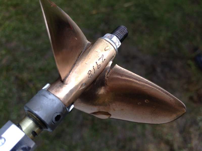

#23559
Thanks for the photo Randy. Was this propeller heat treated? Interesting that it begins to break at it's thickest area. The blade in the photo is heat treated C-20 Beryllium copper. I began to fail at it's leading edge & broke completely off.
JA
