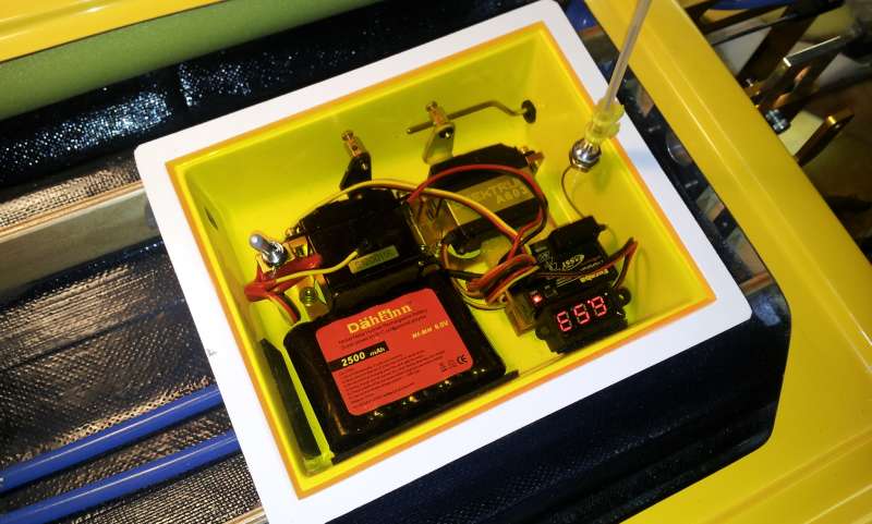

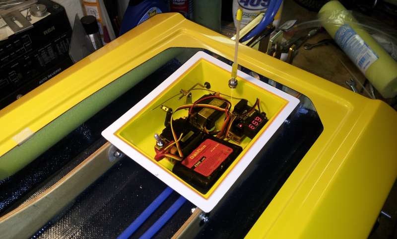

BMAD01 replied the topic: Securing wires in radio box
J, I make my own servo mounts and receiver platforms in my radio box's. The receiver platform is above the bottom of the box by 3/8". I milled a 1/4" step on the bottom side creating a place to the stuff extra wire from the servos. The only wires in the open are from the on/off switch and the battery pack. Hope this helps, Brian
