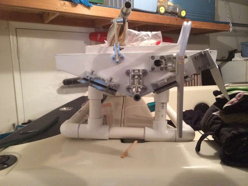

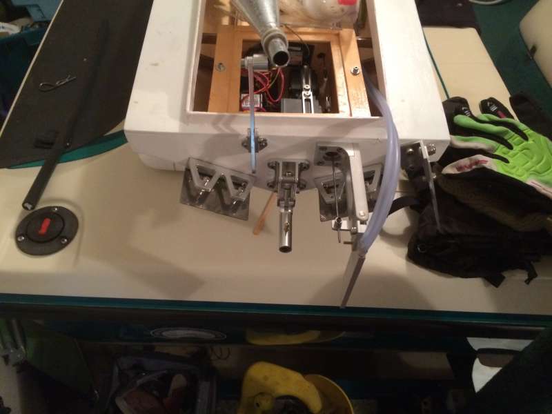

Post a pic of the back of the boat

kylecarey replied the topic: prowler prop
Here ya go

coppo65 replied the topic: prowler prop
Id try a 7016 3 blade get intouch with Bob from g force or Brent from pww and they will hook you up, set the tabs to neutral and stinger also and start from there
