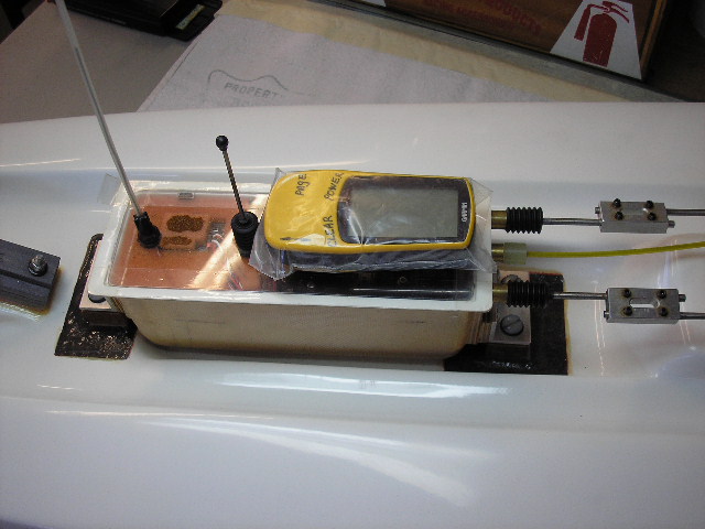

lohring replied the topic: What speedo's are everyone running?
Any of the Garmin GPS units will record and hold the maximum speed. If you need more than that look at data loggers.

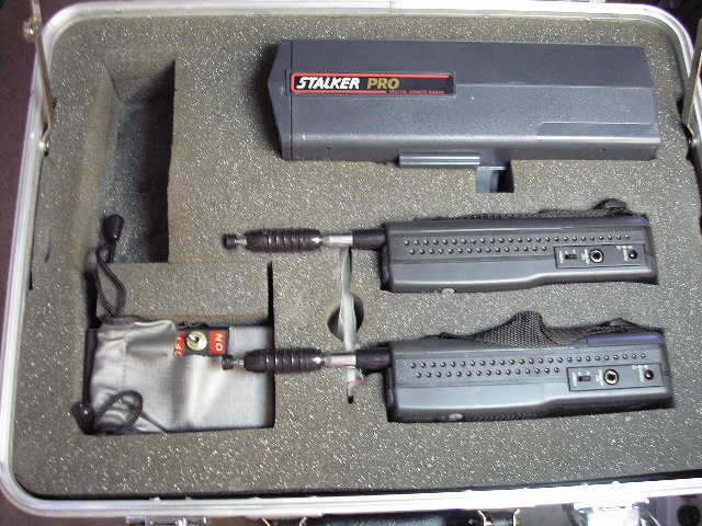

strictlybusiness1 replied the topic: What speedo's are everyone running?
I have compared the readings of the Garmin GPS to the Stalker Pro radar gun. If both devices are used properly they read the same MPH within 1 to 1.5 MPH. Elimination of any tangent error for the radar gun is absolutely necessary! The radar gun is mounted at the end of the lake & requires a radio to communicate.

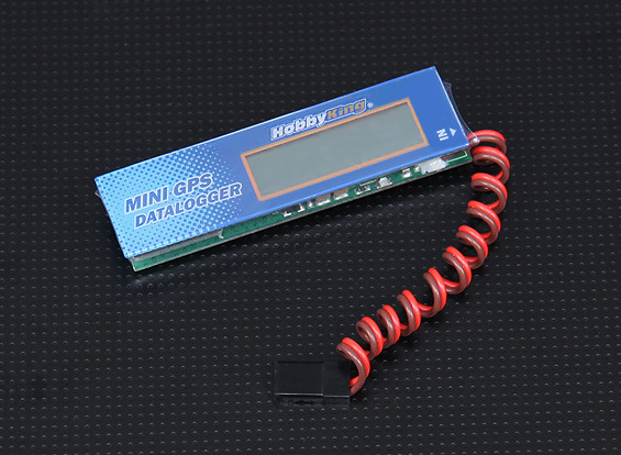

Canadian Hot Rod RC Boats replied the topic: What speedo's are everyone running?
The old style Garmin are out dated and heavy
I have used the Garmin (few versions) - Gun and the Voltron -- all were very close
Voltron / Quanum and Hobby King are small accurate and cheaper - not big bulky old style GPS - use a Mini Data Logger
My Voltron with battery fits in a pill bottle
www.rcgroups.com/forums/showthread.php?t=2000320

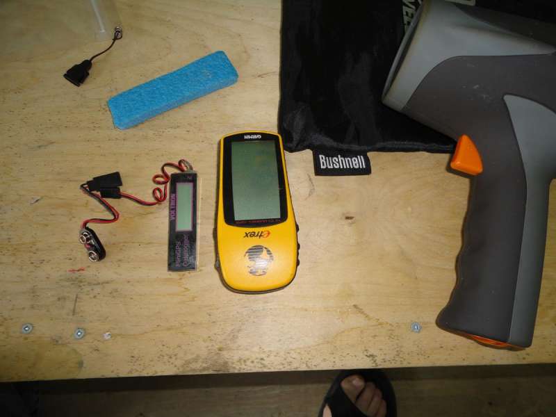

Size comparison

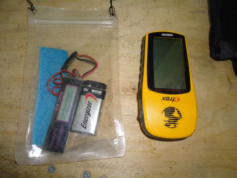

You forgot to show the battery that powers the unit. Also how you have water proofed it & the battery, if you're really using this in a boat????
Tons of guys use them in BOATS - that's why the pill bottle -- or a phone waterproof pouch (with pc floatation and 9V battery) pretty small
And YES I use them - check MY VIDEO's posted if you like :laugh: :laugh:
Does your Etrex float? Does a 9V battery last most of the season ?? :side:
