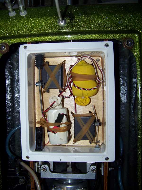

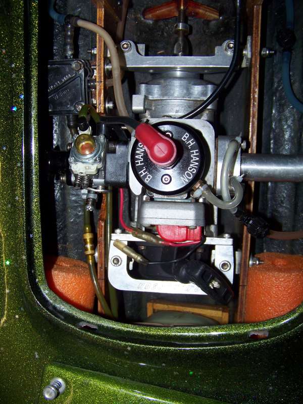

I Need help identifying it. Fuel lines were on back wards. had to pull the carb clean and rebuild it. Set the jets a t 1 1/2H 1 1/2 L.

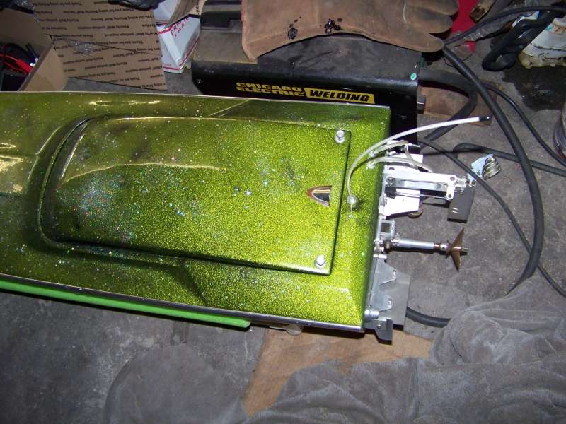

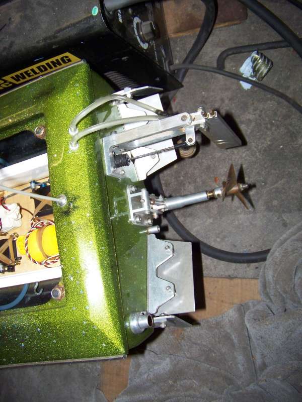

Still not running right. Maybe a carb leak between the insulator and carb. It has 2 water out ports on the left side. 1 Tank vent on the right. The water just cools the exhaust coupler and head? And ya not thrilled with rubber bands holding the servos? They do work? And the Engine has a name???? Any info on this would be great!!! More pics if needed.

Looks like an Aeromarine Challenger? Nice looking boat, I saw it on CL as well. Yeah, the rubber bands have to go, lol. Can't imagine the boat going where you want it to with them moving all over the place. It's a cheap easy fix to get some proper mounts. What problems are you having exactly? Let us know. And yeah, Chris... Where do you run your boats? Lol.

Thanks JD and CJ. I need a new insulter and gasket on the carb. Then I can tune it right. I'll fix the servo mounts. Why does it have shut off valves on the water tubes? 1 for the exhaust and 1 for the head. Or are they water flow regulators? They are placed right before they exit the boat. But ya!! I have 2 other boats ready to run. And there is nowhere here in Weeki Wachee Fl. To run them? Any help would be great! Thanks Rob. :blink:
