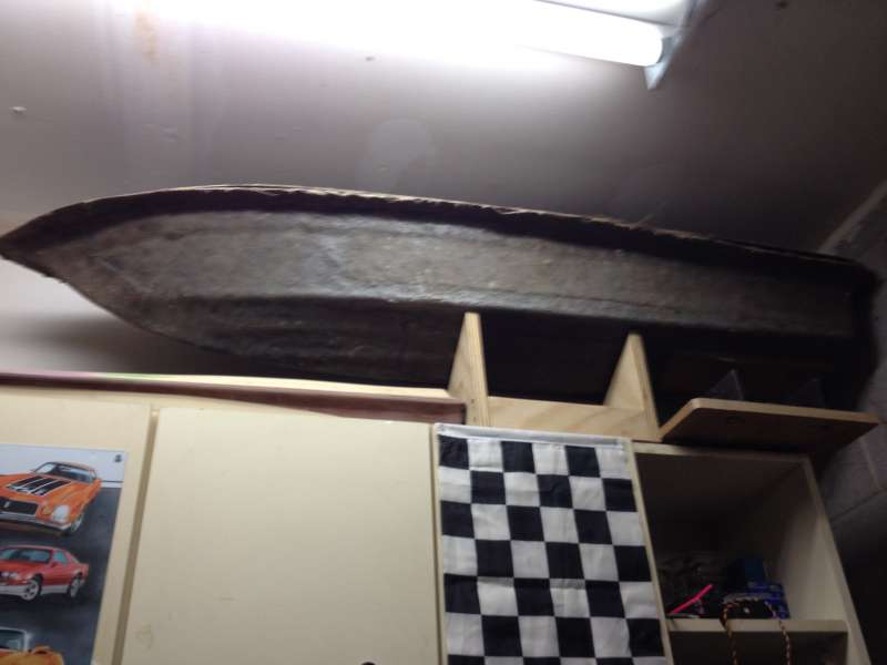

I'm new to this and looking to build a boat for fun. My uncle had an old weed eater power head that he gave to me and I am wondering if it would be any good. It is a cub cadet 4 cycle.

It is a heavy engine compared to the weight of what is available today. If you have a large hull 60"+ or are building one for just play, then this might work for you , although finding mount hardware as well as drive hardware can be cumbersome or an issue

Hot Rods replied the topic: Will this engine be any good?
One of our club members brought his beautiful Chris Craft scale cruiser out this past weekend for a club demonstration day. It is powered by a 4 stroke that's been water cooled, has a clutch, and electric remote starter. Dual transom exh. ( quiet! ) AND reverse! It's not fast ( isn't supposed to be ), but it looks and sounds very scale. That's the kind of ride that a 4 stroke really works well for.

southernjames replied the topic: Re:Will this engine be any good?
Thank you for the replies. I think I will keep hunting something smaller.
