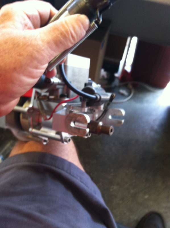

I'm looking for a Zenoah front mount that also doubles as a coil relocation mount. Has anyone made one or sells one? Needs to be tall enough to hold the primary coil and also the secondary coil.

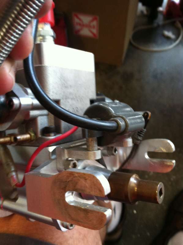

How about something like this? I made these for m boats.

Steve, is that not the rear mount? I want to combine both coils on the same mount, something like the ignition plate for a RCMK SX 254. Where both coils mount by the recoil starter.

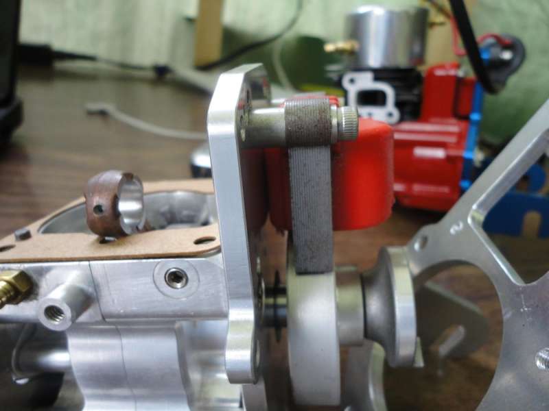

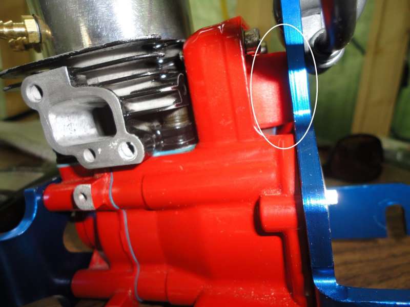

Canadian Hot Rod RC Boats replied the topic: looking for front mount
Gordon
I know what u thinking -- but is there enough room between coil (pickup - red one) and case if you turn coil around ? the coil (pickup)
You would have to mount coil to back of front plate and would the 'bulge' on coil clear the case?
I think best solution might just be a MK SX case ???
#24654
If you look at 'bulge' in front of Zen red coil it protrudes past most mounts -- to get it to go back far enough if you turn around might be tough
if you mount on back - but coil (pickup) facing forward u need some spacers to move it back inside the case --
Maybe -- ??/ I thought Bruce made some mounts one time for that 95g flywheel and a Zen case ??
I have some 1/4' plate if you want to fab something -

Randy, this is what I was going to do.…
1, mount a TK. Lightened flywheel
2, use a TK primary and secondary coils
All on my zenoah 28.5 stroker
Problem coils don't mount to the zenoah case, hence mounting on front engine mount. I guess I should've started with a RCMK sx254 bottom end. Arrrrr

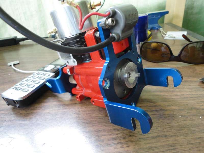

tootalltechie replied the topic: looking for front mount
this is what I'm thinking of doing as a front mount, so a smaller rotor(flywheel) can be used with a Zenoah case and timing can be adjusted.
