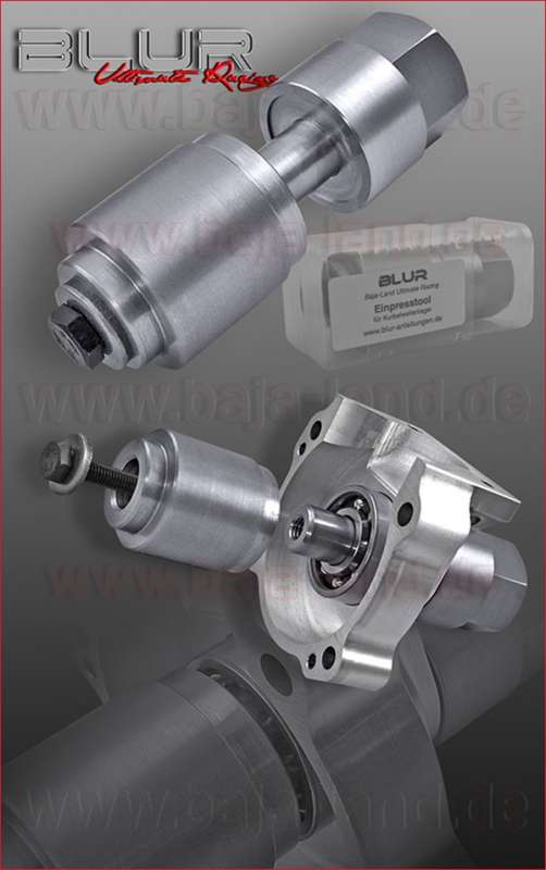

There is a bearing alignment tool used to help align bearings when you install them. Shipouts Bearing TOOL 013:
#25218
Canadian Hot Rod RC Boats replied the topic: Where to buy arankcase bearing puller/extractor
I heat mine but if you want a press
www.davesmotors.com/tr234bearingpresstool.html
