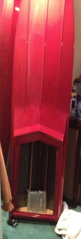

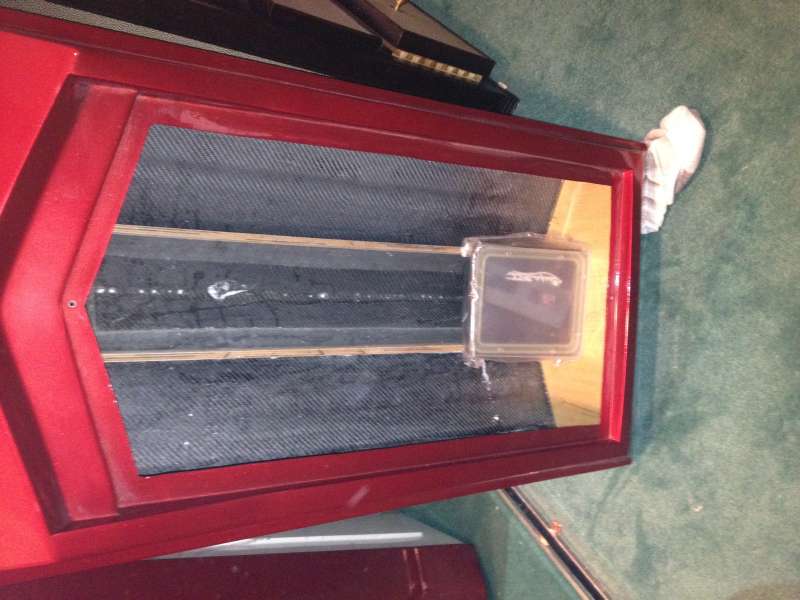

Hi every one! I'm new here and new to building my first rc boat. I've had a few in my past that were rtr. so now for the the topic at hand. I have a empty 84" Apache like the bonzi one. I need help on what to buy as far as what size stinger drives do I buy. Do I go with a round or square flex shaft???? How do I go about bending the brass tubbing the right way? And how do I install. Pretty much a noob here guys who just needs some help and pointed in the right direction. The boat will see more rough water then any kind of racing. I wanna get ahold of a good inline engine or was thinking about buying red lines cuppler kit for the Zenoah engines and join the g300 engines together with a clutch and gear box from arrow rc boats and run 2 stinger drives. Also what size servos and radio do I go for. How deep or far down on the transom do I wanna mount my drives and rudders. I would like to do a duel rudder setup as well. The transom is 15' wide 7 1/2 deep to the lowest point of the hull. Thanks for your time guys and for those who help me out here.

Post some pictures of your boat - always helps when we see what your building
