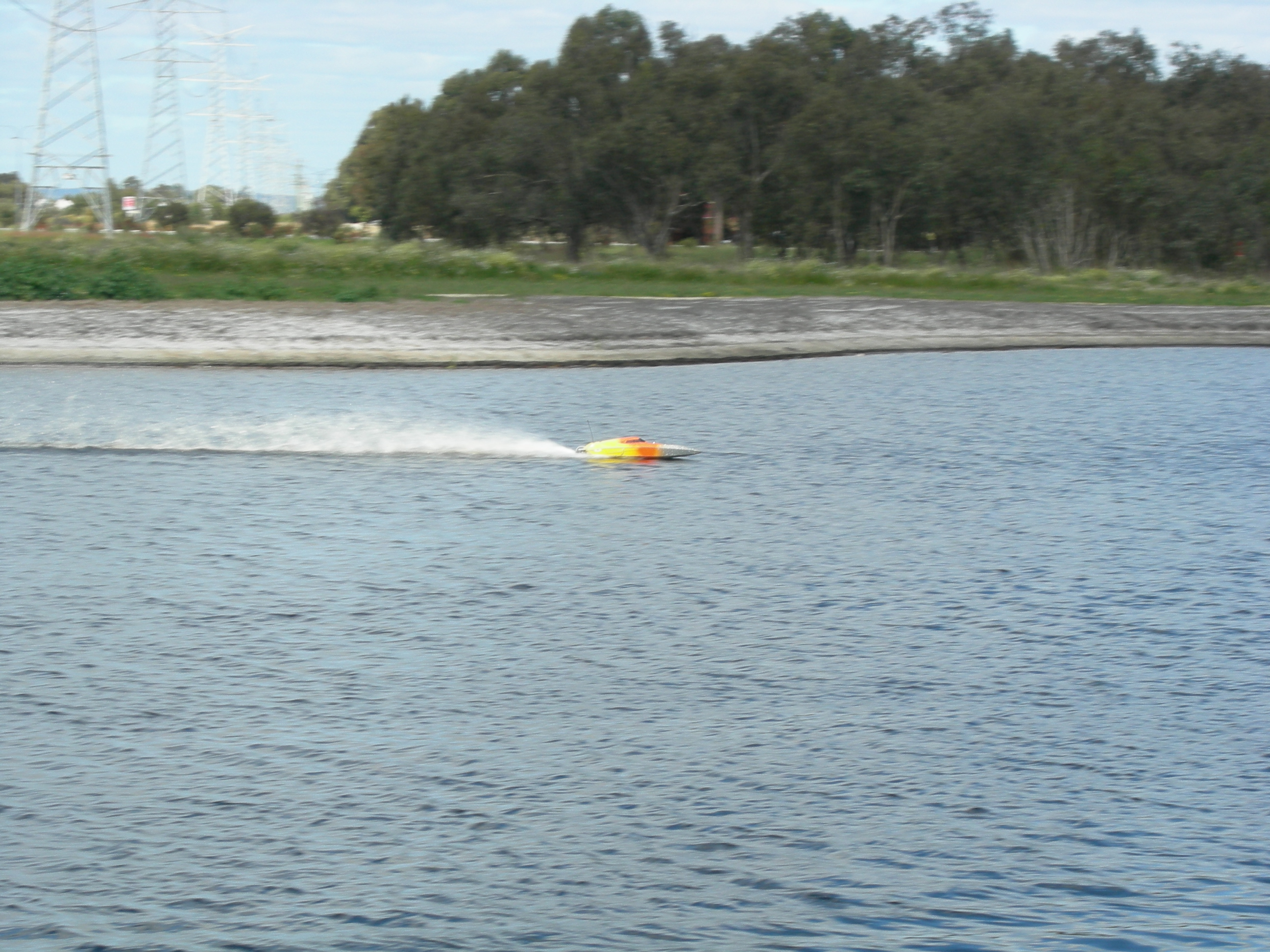

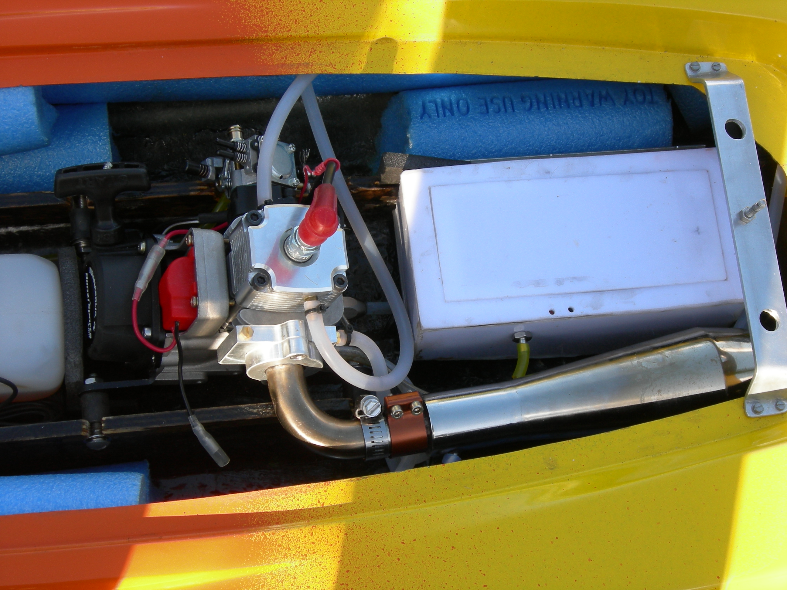

sorry for adding so menny pics of boat but i like it lots..haha when it gets up to good speed it realy flys and flat out into the wind no probs dosent lift or trys to flip at all . i know races probly dont clase this boat but im finding it a great ride . just want to get this full mod motor dialed in:woohoo: .....
ive also added a pic of my mates boats and mine at owe lake we run at . its great a lake one min drive from my home and me and 2 of my mates are the only guys ever down there using it .its just the right size for boats of this size not to smale and not to big with sand beach all the way around it ..
