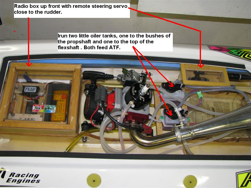

I've tried to attach a photo of the layout in my cat.

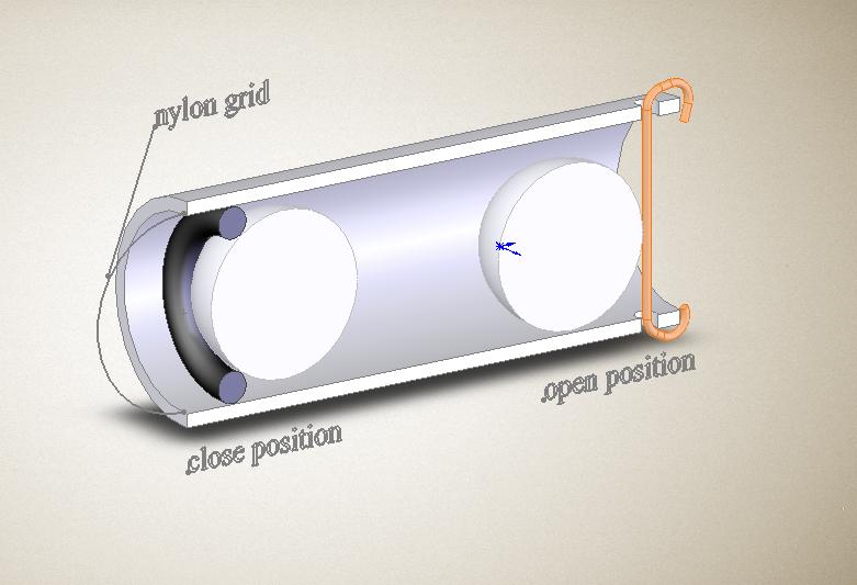

I have made my own in the past...maybe I will make a few more and take pictures along the way and do a short article on that.
In short, you want the ball to seat on a small Oring inside the tube. Machine a groove for the Oring or simply glue it in at one end. Insert the ball and cross-drill the tube at other end for a small pin to prevent the ball from coming out. I used small cotter pins so I could open them occasionally to clean any dirt that got inside. You can put a small screen on the end if you want. You can get all the parts from places like McMaster-Carr. The balls I used were plastic. Orings, natural rubber, SS pins and aluminum tube. Make them the size you want, just match everything up!
Hope this helps.

Hey Marc,
You run a great site, I visit every day. Thanks for the description and I certainly can make something up from what you've provided. I'm therefore assuming that when the boat stops, the water tries to flow in and thereby pushes the ball against the o-ring and that prevents water entering the hull. Amazingly simple ! I somehow thought there would be a spring behind the ball.

marc replied the topic: Re:Need help to make auto-bailers !
No spring! Just the ball pushing against the Oring like you said. A lightweight ball helps, that's why I use plastic.

Hi Will,
I would if that would solve the problem. My boat runs very flat , and very 'wet', It takes in about a liter of it's own spray in a matter of minutes, and thats with the canopy on ! So auto-bailers are a must !
Why is it taking in so much water though? This looks like a Stryker cat? Typically the boat should not be running wet. Maybe the CG is too far forward? Just asking...I know this is beside the point, but still curious. If it is running that "wet" you are maybe not getting the optimum performance from it. You might still have a lot of speed left in her! :)

Zitch replied the topic: Re:Need help to make auto-bailers !
Hi Guys,
I try to draw a isometric model of baller.
Very important to find a very clear round ball.
The rubber ring is fix with glue.
