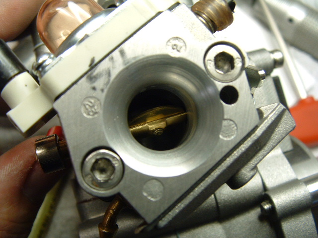

INEEDSPOTS replied the topic: Re:Big Bore Carburetor Mod
true mod carb has the shaft and butterfly massaged. This is one i messed with, have not messed with the screw. Stock bore 257.

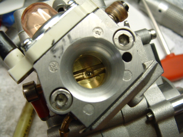

Scott replied the topic: Re:Big Bore Carburetor Mod
Then again, you can gain flow like this ...
#5704
another view
With now sharing the next step in flow improvement by thinning throttle shafts ... Be afraid ... VERY afraid in the very distinct possibility that you can now get shaft breakage !!
** With MANY of the linkages used in the hobby, Most rotate the shaft from the opposite end of the throttle stop.
So the shaft is being rotated threw the throttle bore and then bottoming out the stop. ** NOTE: If your servo end point is not set too JUST get the rotation of throttle at WOT just at the stop, it will try and rotate the shaft further causing it to break mid bore !!
In most cases it will break AT the screw hole allowing the STEEL screw and butterfly to be ingested into the engine :bugface:
Not good !!
