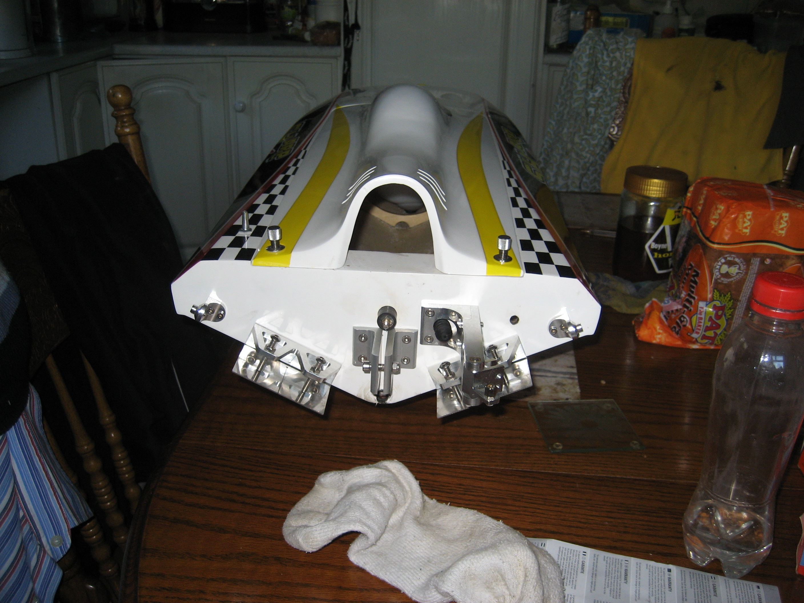

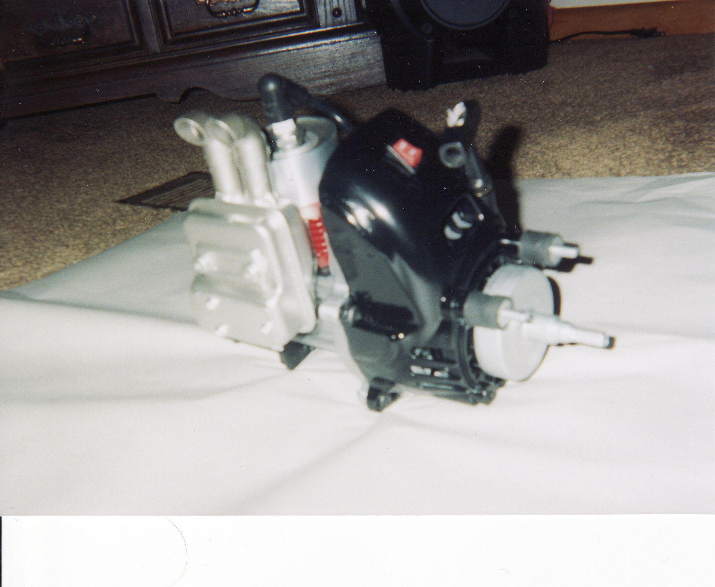

I have a mono hull (52 inches x 14.4 inches x 8.8 inches), submerged prop, all together it'll wiegh about 9 kg. As I said the engine revs to around 10,000rpm. Some pics of the boat:
#7175
Zen26 replied the topic: Re:Propellers
from the back:

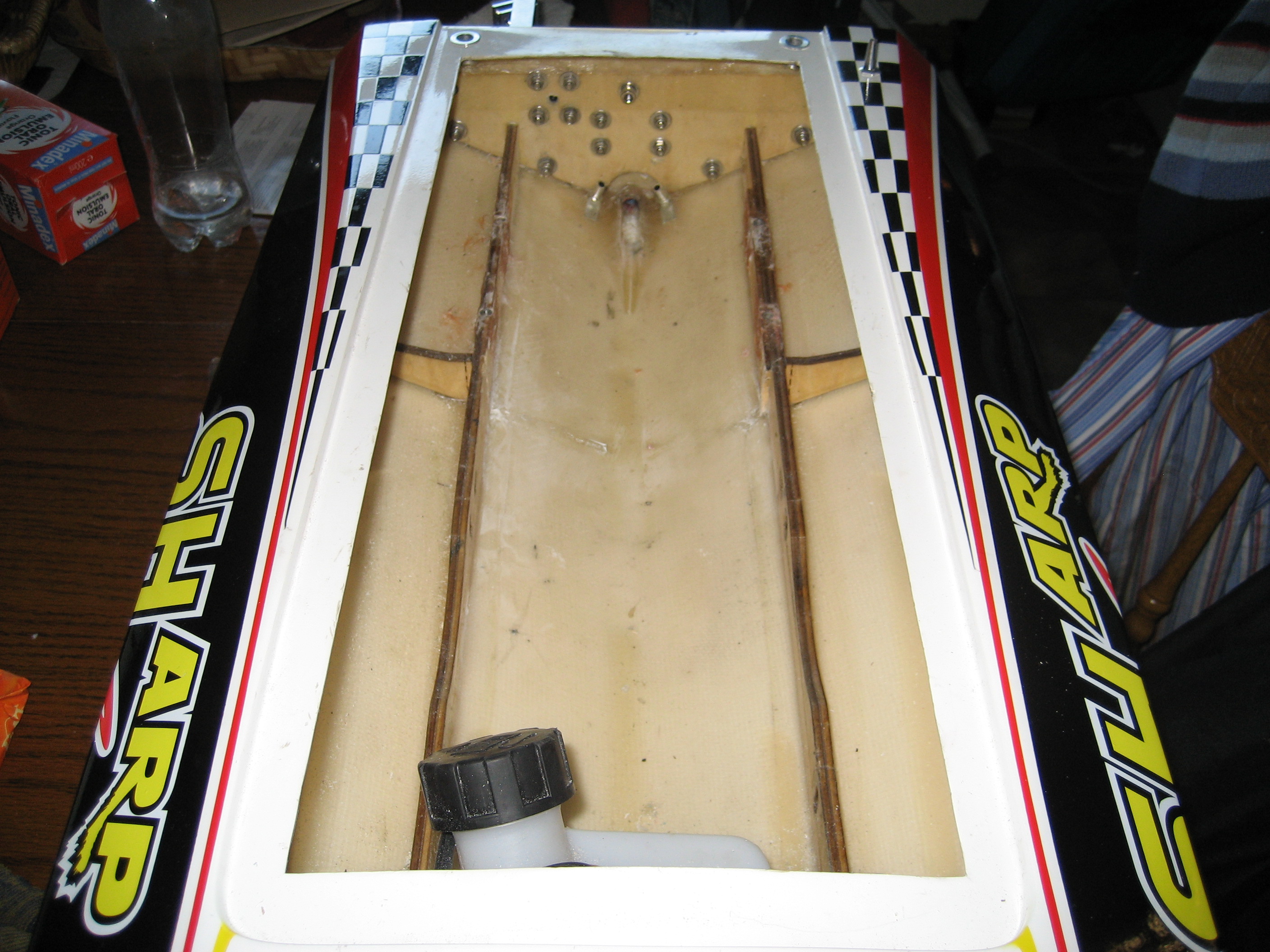

inside:

Scott replied the topic: Re:Propellers
BIG boat and near 20#'s ..... Running submerged is going to require a smaller prop.
IMO something along the lines of a Propshop / Voodoo 6516/2 or 3
Octura X465 0r 467 with cut down tongues. ABC 2514 or 2516
