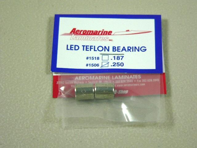

Are you talking about the push-in lead teflons as pictured or the brass sleeve type? I use the brass sleeves and seem to get good longetivity, but then again I don't get in as much run time as a lot of you guys. Only used the lead teflons in a couple boats in the past and they didn't last nearly as long as the brass bushing setups.

Yeah, I have been running the lead teflons, Octura's, Aeromarine's, and Warehouse Hobbies brand the just dont seem to last.

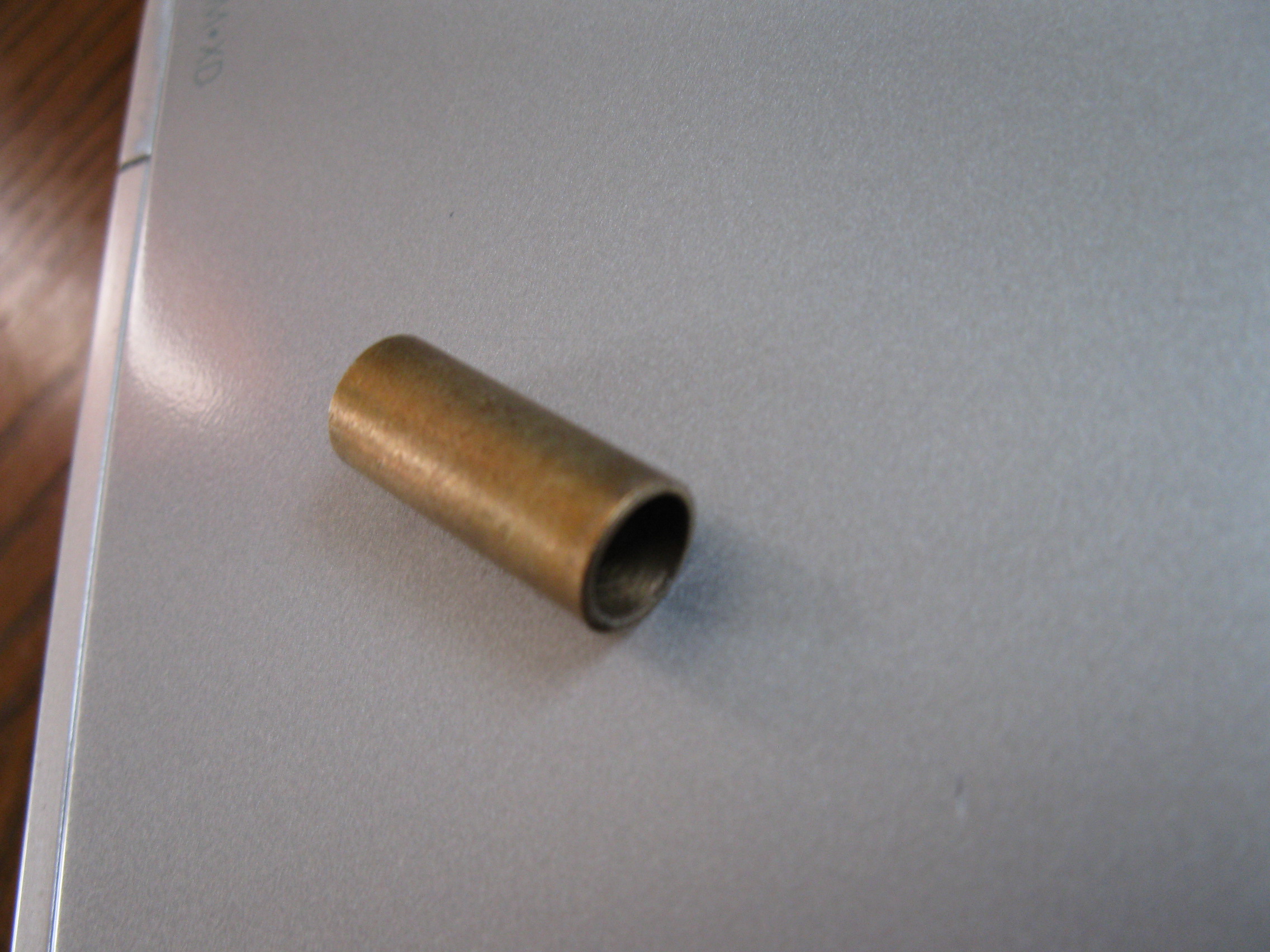

If you are running Aeromarine or Octura struts...try this on one. Punch out the bushings, drill the strut 5/16. Run your stuffing tube through the strut...assuming you use welded cables with collet...(you can splice the stuffing tube with a piece of 11/32 over it if you don't want to replace it completely). Use a 9/32 brass sleeve inside the stuffing tube from the prop end. Easy to modify these struts for brass sleeve setup.

marc wrote:Yes, I'm talking about the push in lead teflon one, me too, not much running time, just one or two times a week.

I just found a used 3/4" length brass sleeve from my tool box, it's for the 1/4" flex cable, does anyone know where to buy it? it looks heavy duty than the led teflon bushing.

I purchsed the oilite Bronze Bushings: 5/16 O.D. 1/4 I.D. in two different lengths. 1/4" and 1/2". I soaked them in a real viscous oil overnite and installed the longer version in struts.
The dimensions are very tight, right on the money; the Lead Teflon that I removed had a lot of slop in them and I had not run them that much. I have run the heck out of these and there is no slop.

planebasher wrote:Thanks for the website, I found that brass sleeve, 1/4" of ID, 5/16" of OD, 3/4" length and material is bronze.
