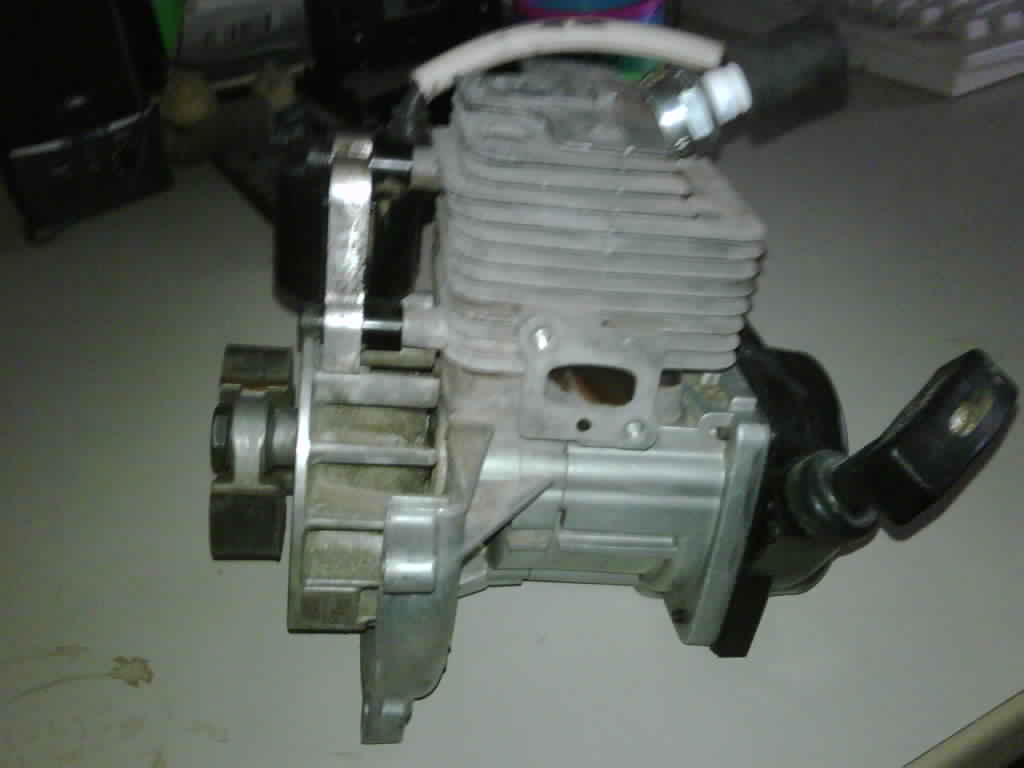

road replied the topic: maruyama engine for a boat ????
Wow its been a long time ...life gets busy things go on hold.. but here is a pic of the engine i would like to use.
with some careful mods i think it will work. i may even use the barrel carb to start with.
any ideas if Zenoah heads will fit ? i would like to have it water cooled. i know the block is different but the head gasket looks the same. i dont have a Zenoah to compare it to.
i plan on milling off the flange around the flywheel and fabricating a mount behind the flywheel and something to mount the clutchbell as well.
what about timing?
any one have ideas ?

road replied the topic: Re: maruyama engine for a boat ????
Its been a long time for this post but..
I have to use the stock head for the coil is mounted to it. However I can remove most of the flywheel housing and mount the engine from behind the flywheel. I want to run it with out a clutch so I think I will do some research if a zen flywheel will work (considering the timing and air flow for cooling though, I'm not sure) I have a 813 walbro for it and I can make use of the stock muffler. Funny thing is there was no crank case gasket on this engine and it ran great. First thing is the flywheel issue.
Then the hacksaw and grinder need to get involved.
More to come....
