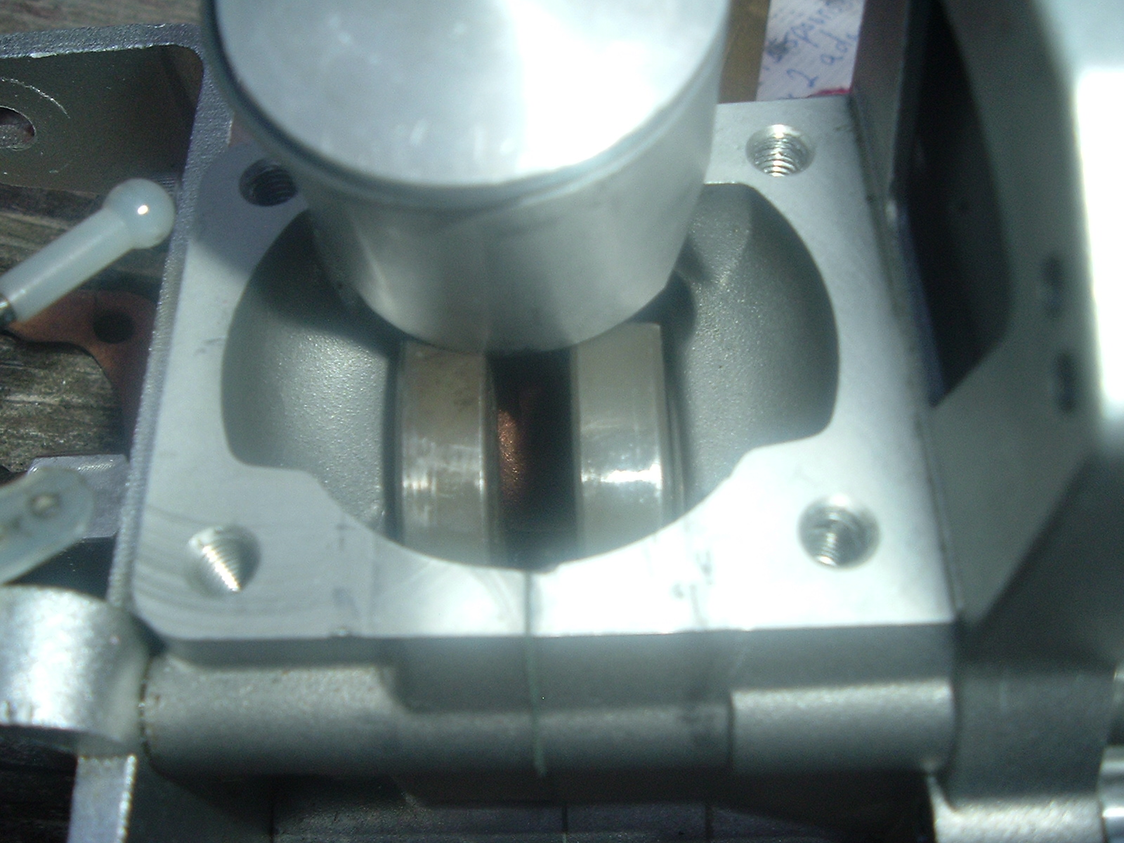

Ronald Olson replied the topic: Re:WT-929 tuning
OK, we got one of them to fire up tonight but one wants to and well, the other I think that I found a little problem inside which is hte one hat I replaced the piston and ring in. It was a little tight pulling over at times. I pulled the sleeve and found some wear on the crank. I don't know if it's from the factory which I kind of doubt becuse I found some very fine filings where it was possibly hitting the bottom of the case. I'm not into stripping the whole thing down right now. I also found some scrapes on the piston, ring and a small but noticable nick on the very bottom of the sleeve just past the taper.
Shot 2.
Our boat club Prez, Walt Radzinski has one in his Whiplash and had me try it out. Those EZ starters are sweet for us old guys! OK, I'm only 57 but the shoulders are shot.
Can anyone get back with me on the crank? The counter-balancers appear to be scraping somewhere inside, possibly the bottom of the case. The only other thing that I can think of is that they might have been from some machining at the factory for clearance.
