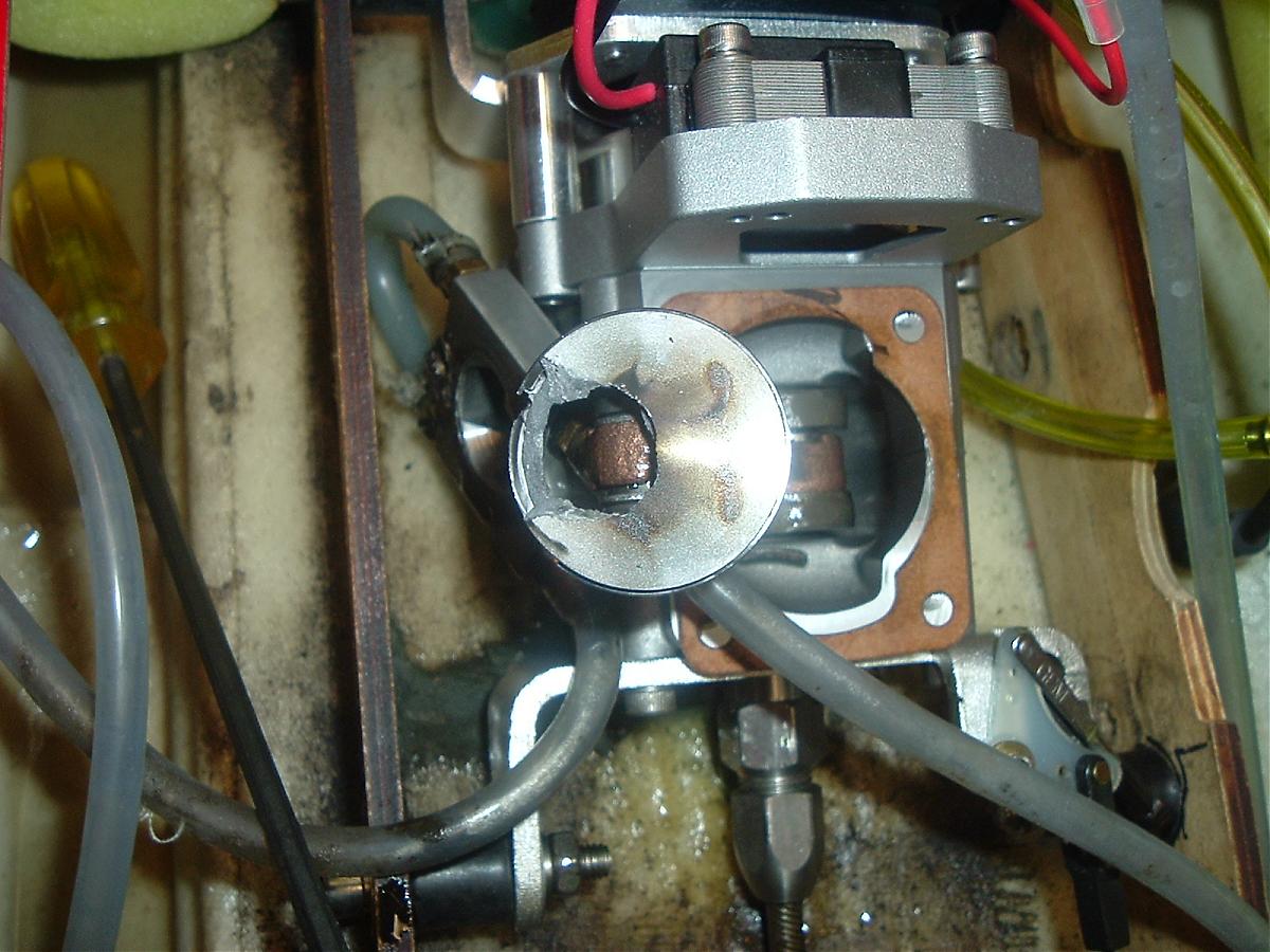

So far today I've tried firing up 2 RCMK's and no luck with getting them to fire up. I've done about everything imaginable so far, fresh gas, checked for spark and checked the plug gap. One is a S-254 with a new piston and ring and the other is a spanking new Evo. I can tell that the Evo really wants to fire but won't, the S is iffy. The S also feels a little tighter than the Evo.
Rigght now I've got both carbs at 2 out on low and 1 out on high.
I've been through Carlo's thread on getting Zen's atarted but my arms and those of the kid are both tired from pulling these things over.
Man, these things are more cantankerous than I am!
Any help on these beasts?

All I can say is 'Man I hear ya." I fired my evo for the first time this past weekend. Ran it four times and it was a bear to start every time. I must have yanked it 35-50 times the first go around.
Getting the EZ start tomorrow. I'm really hoping this thing loosens up after a gallon cause my shoulder is sore just thinking about it. Runs great though.
One thing I can say is I think you are rich on the low and lean on the high based on recommendations from RCMK and Scott. Hoping Scott will chime in.

Hi guys i have 5 evos and they are modded and they start first pop every time on the stock 929 its 1 1/4 low and 1 1/8 high and with 257 i set mine at around 1 3/4 low and 1 high it also depends on the amount of oil you run with fuel every engine has a slight difference but these settings work for me hope this helps guys.
Len.

Len, I'm very worried about running mine at that setting. The last time that I ran one at 2 on low and 1 on high I blew a piston. Dom't want to go through that again.
