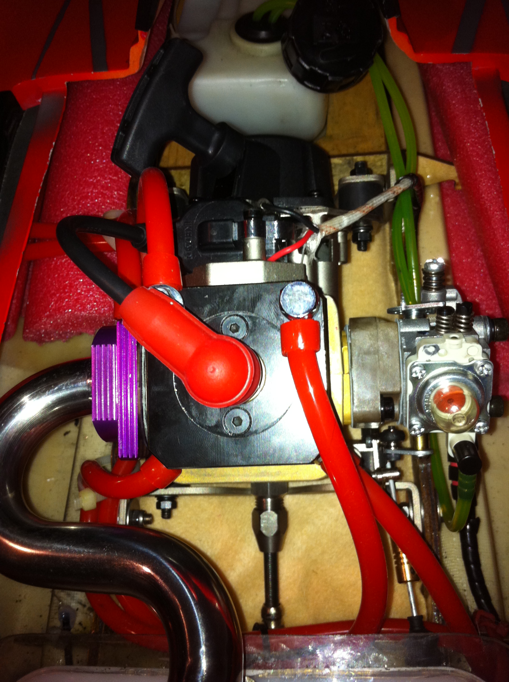

this is my set up i have a rudder with 2 pick ups and i have 2 outlets
the hoses from rudder go into the bottom of head.1 of outlets goes straight to an outlet and the other goes to the exhaust manifold then from the to the out on side of boat.
