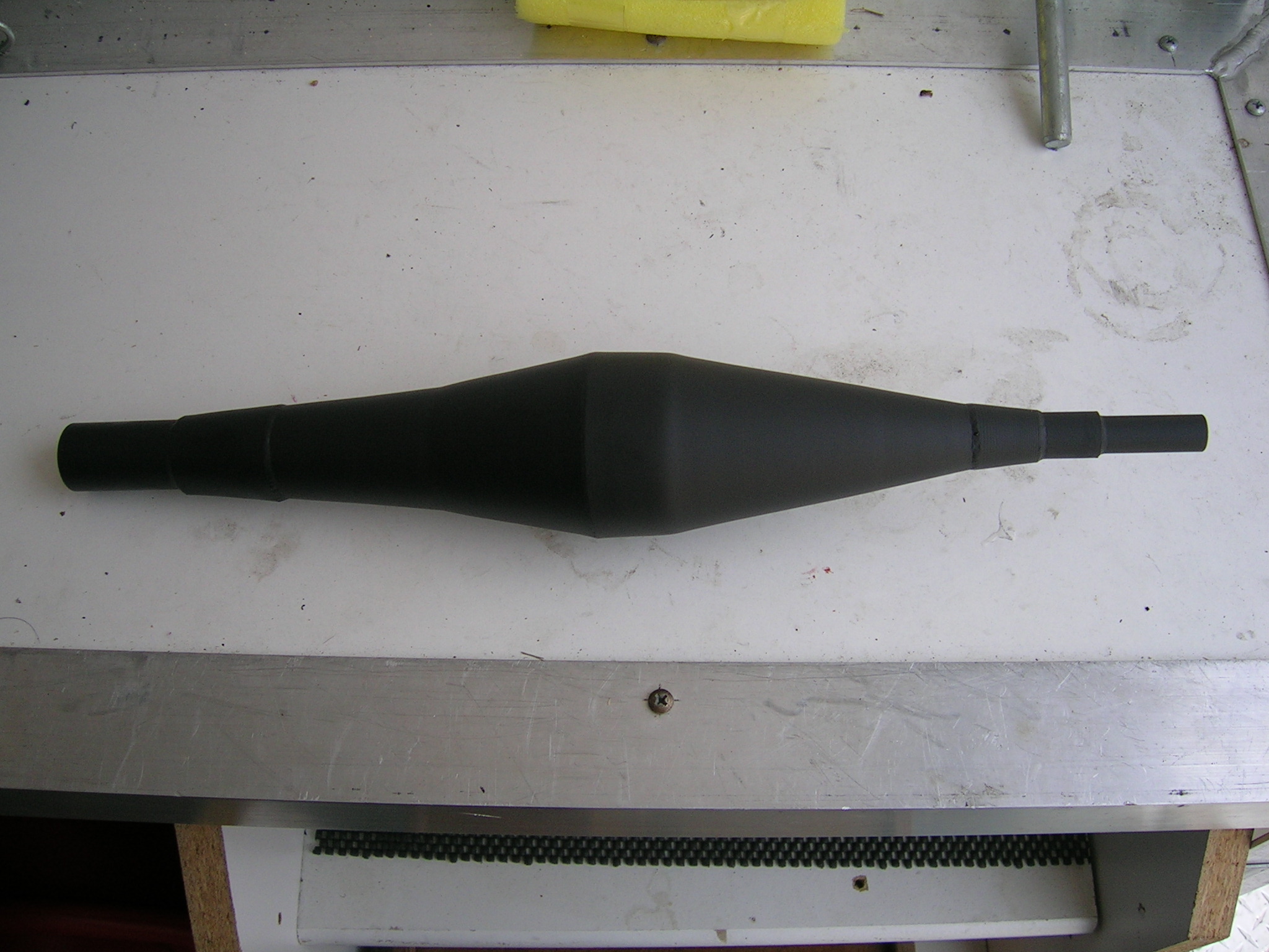

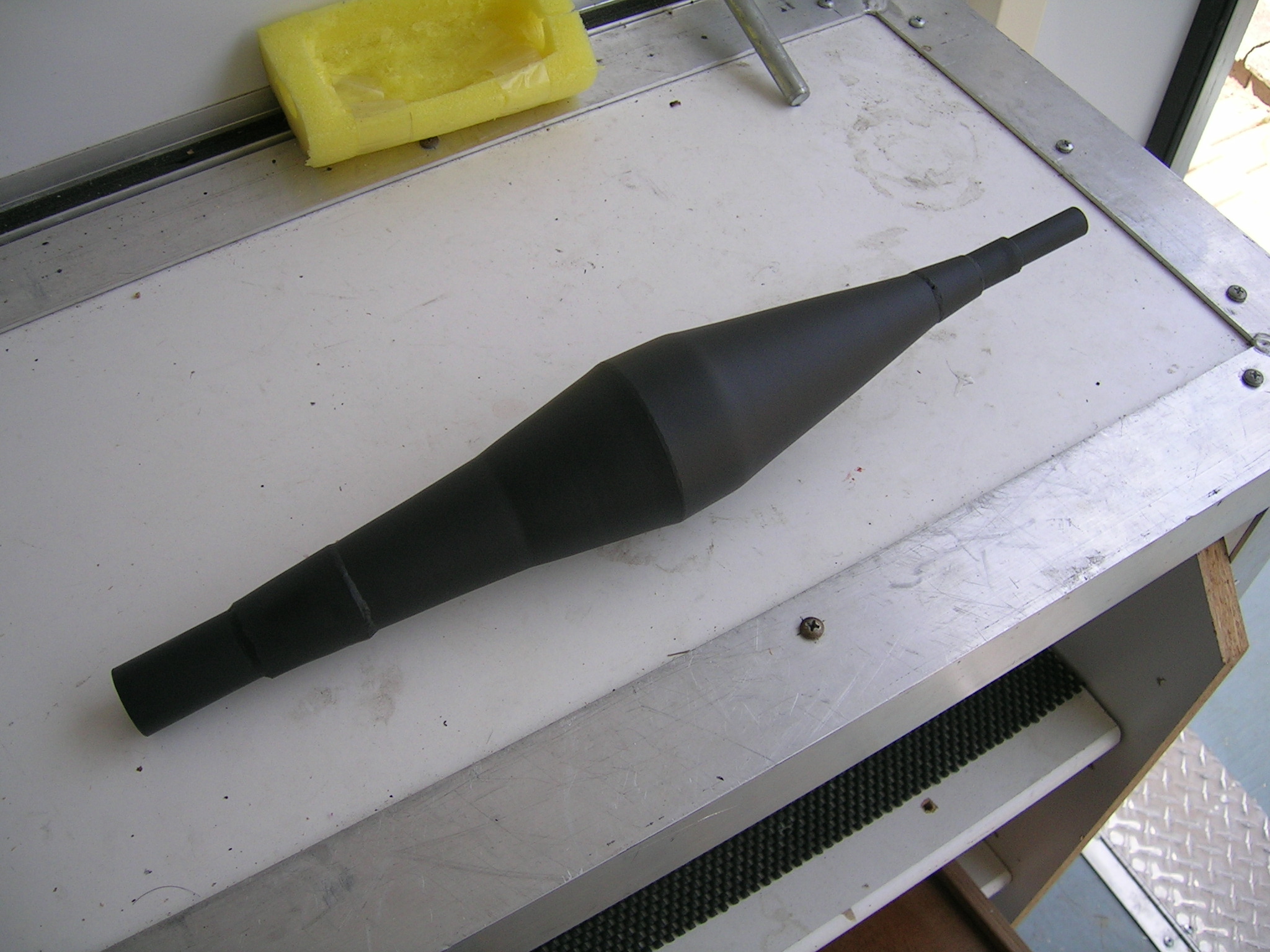

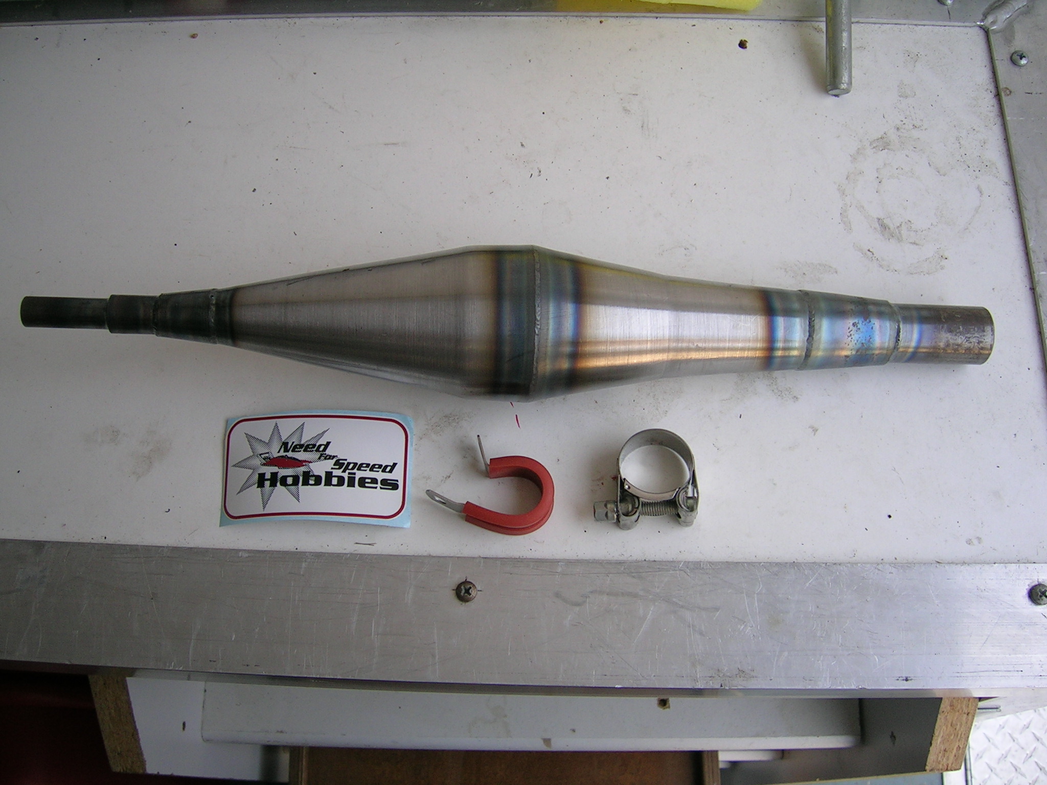

I just got this pipe from Carmen at Needforspeed Hobbies. I had him do it with the internal stinger for me. Pipe looks good and strong. Looking forward to testing it. Will report back.
After a good inside out cleaning and a couple coats of high temp paint. Ready to go test!!!

Mercury94 replied the topic: Re:NFS 1" band 2-stage pipe
What Makes it a two stage pipe? The general shape looks similar to other pipes.

marc replied the topic: Re:NFS 1
<strong>Mercury94 wrote:</strong>
The dual angle diverging cone makes it a 2-stage pipe. In other words, the cone from header to center of pipe has 2 different angles to it.
