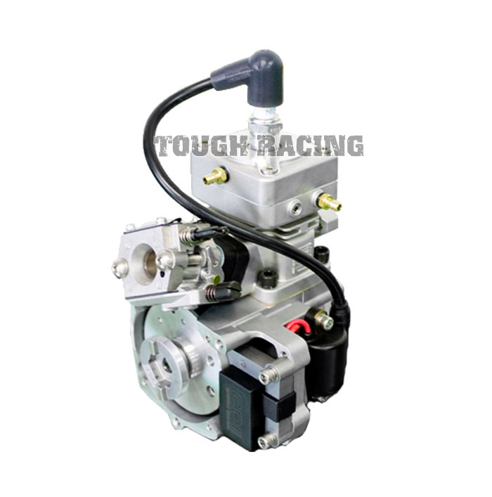

Scott replied the topic: Re: RCMK RZ254 or R254?????
Top picture ... RZ254 Evo.
** Fits into mounting position within boats rails same as the Side exhaust engines using like type mounts.
** Has a rope starter
** Has flywheel forward at starter end same as side X.
Bottom picture ... R254 Evo.
** Cases more compact requiring RCMK's own rail type mount system or custom mounting.
** NO rope starter requiring belts and electric starter ( Like Nitro engines )
** Flywheel at PTO end limiting how low you can mount engine in a flat belly hull.
If racing within NAMBA ?
RZ Evo a legal G1 engine
R Evo a GX1 engine
david36pt wrote:
Yes for the most part, tho the RZ having the angled intake tract is a plus over a straight in like the R for case filling efficiency and likely has the edge if we were spitting hairs :huh:

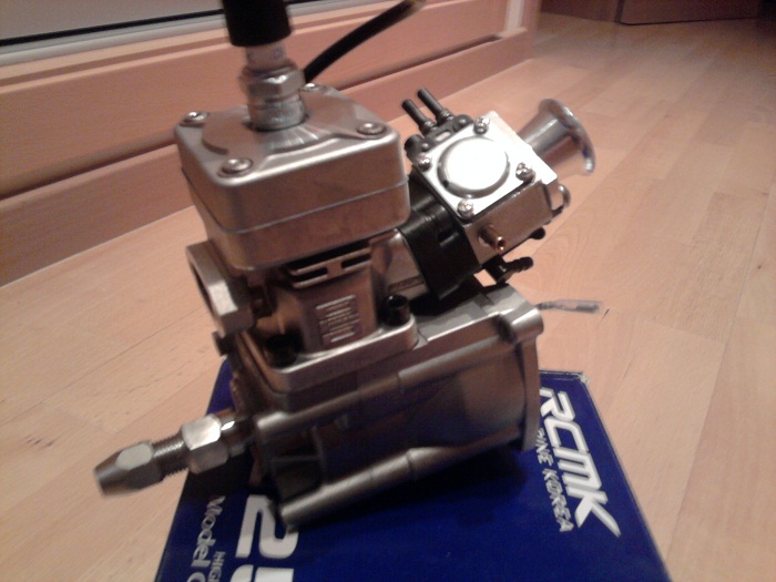

david36pt replied the topic: Re: RCMK RZ254 or R254?????
Hi
Just receveid from koreia the 254 looks great.
Many thanks for the help.
