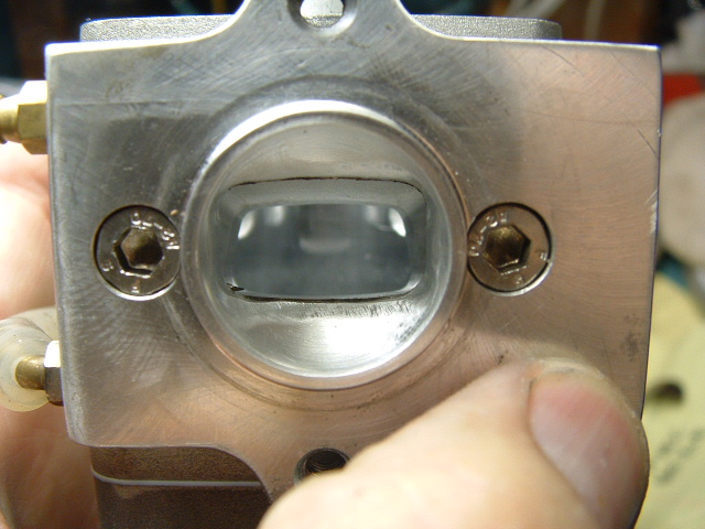

The situation; I bought a Suicidal modded RCMK but while throwing the exhaust system on it the opening of the manifold didn't match the exhaust port as it had been redone. OK, I'm no genius at this stuff but know enough that this can kill performance some. Am I going to have to take a shot at hogging one out with a Dremel to match the port or are there ones already made to let this beast breathe a little better?

You'll never find a flange that matches the port exactly unless it was designed around that certain modded exhaust port.
Just remember, the flow back into the exhaust port needs to be as clean as smooth as the flow OUT.

RCMK's exit hole is bigger than Zenoahs and while it may seen a daunting task, all you need to is attach manifold to cylinder and using a hook type dentistry pick scratch around perimeter of port shape scratching a line onto manifold. remove it and grind to the line in a belled shape flowing into round area at head pipe mounting.

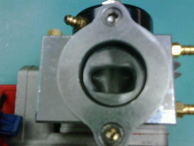

Scott, you've also answered the same problem that I had. I just bought a stock std RCMK side ex Evo motor, but the shop supplied a watercooled flange that is a Zen pattern.
The Evo port is different. We can only get the Zen shape here, not sure if RCMK ones are available anywhere.
