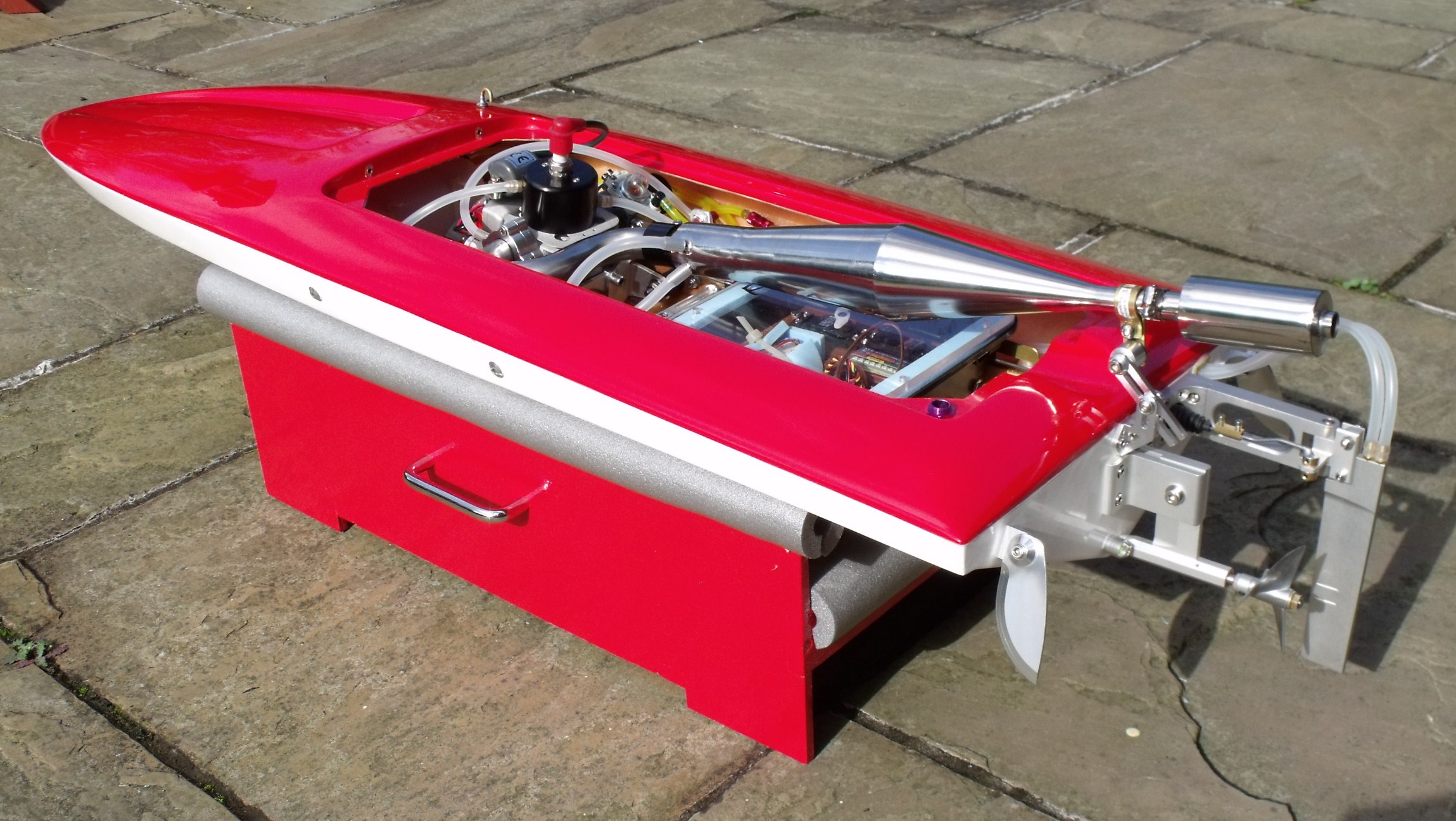

My stock Zen + pipe, header and hardware came packaged with my mono hull(Lynx) from Prestwich Model Boats in UK. Here's a link to his Gas Tuned pipes:
www.prestwich.ndirect.co.uk/gaspipes.htm
My boat has the cheaper £79 pipe with the stainless wrap to centre manifold. If I wanted more power I would upgrade to his competition pipe and ditch the WTC manifold to get a shorter pipe length and replace it with a 100 or 105 degree bend header.
However I have to say I am impressed with the set up as it is. With the right prop and carb settings it runs very well. These two pics show it:

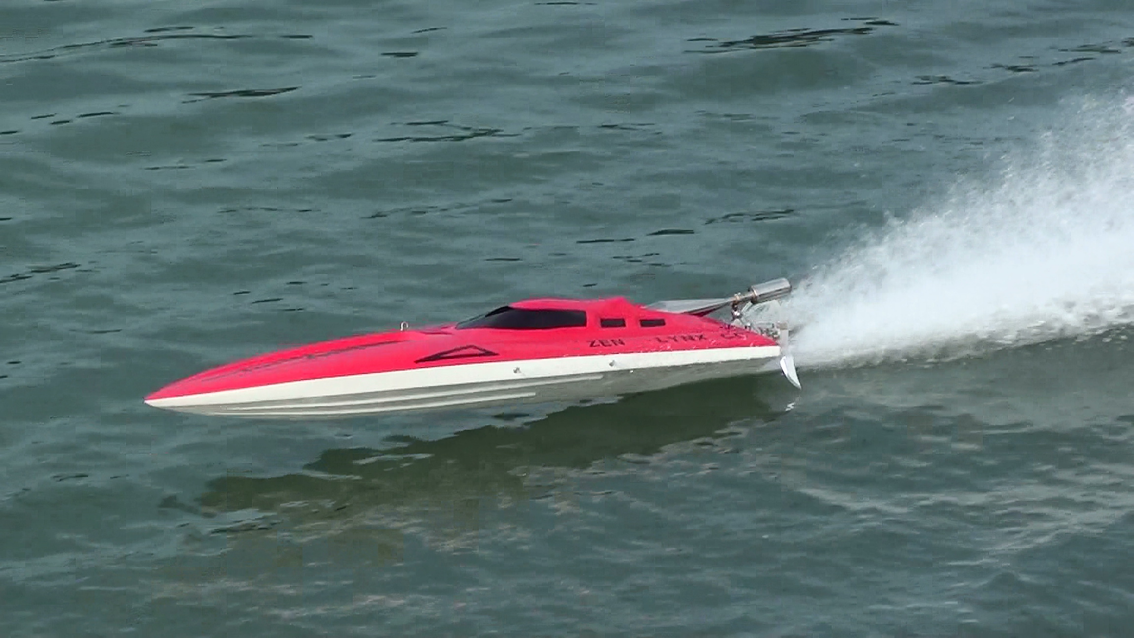

I've been running NFS 1" band pipe for long time and I liked them so much, here's a newest NFS pipe on my old Insane mono.
